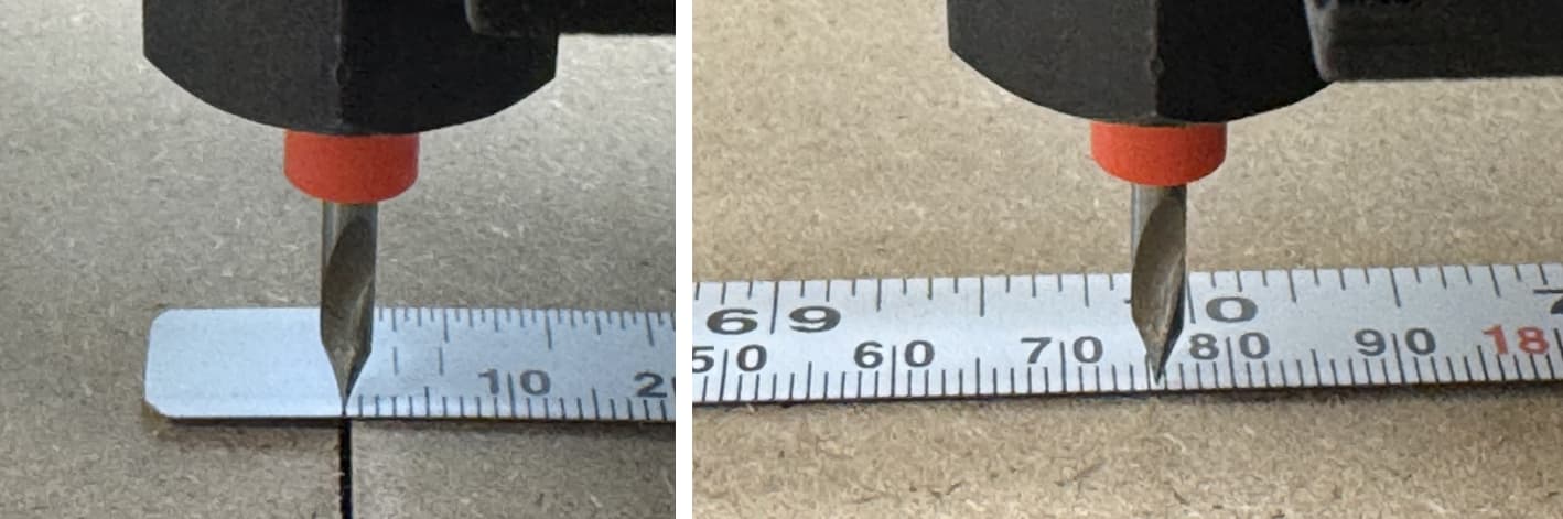

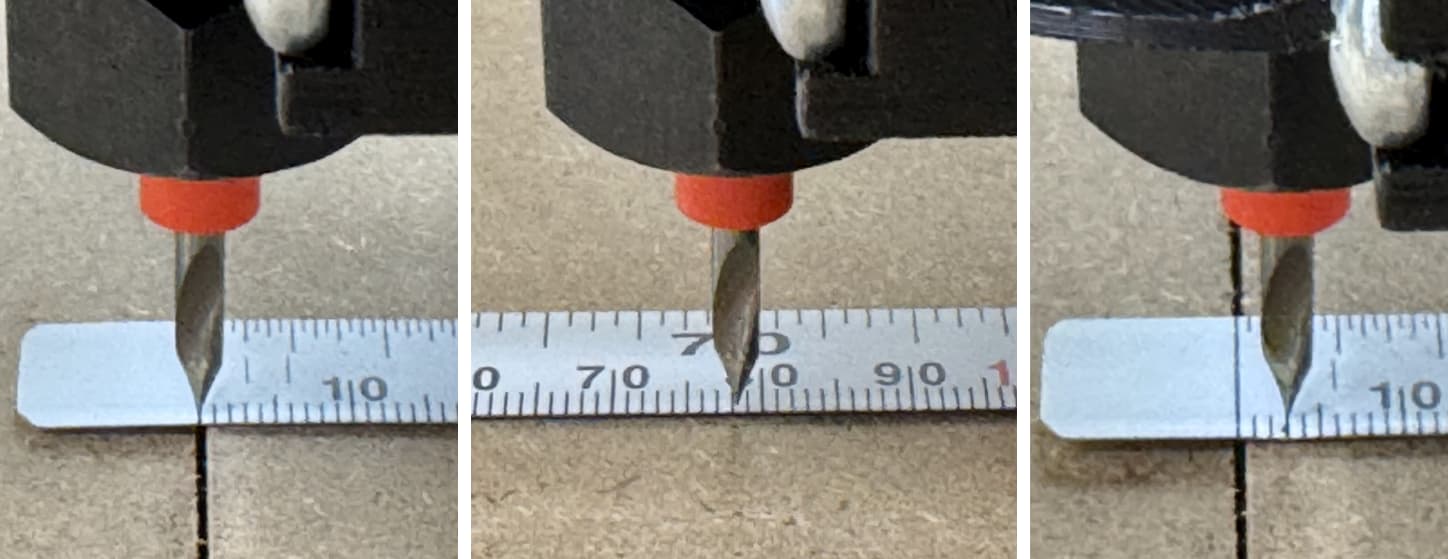

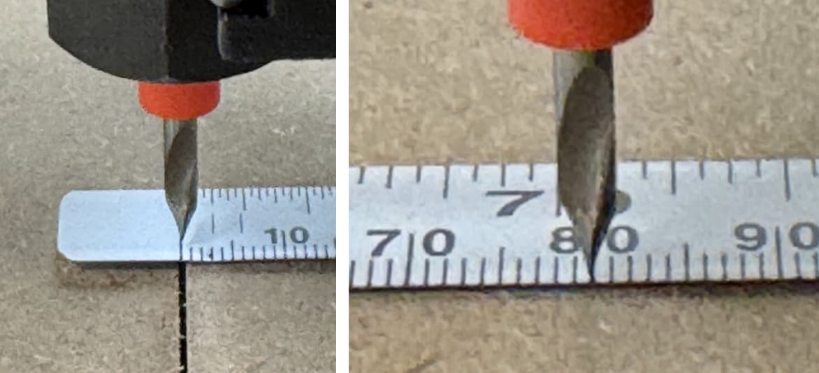

Hi Ryan,
I do not understand either (but I am a noob).
Here are my observations, keeping in mind that I swapped the axis.
mpos_mm = 3
  • Homed the X-axis, the bit is exactly at 0
  • Did a G0 X1780, the bit is at 1875.5
  • A G0 X0 brings it back to 0
mpos_mm = 0
  • Homed the X-axis, bit = 0
  • G0 1780 brings it to 1778.5
  • BUT, G0 X0 does not bring it back to 0, but rather 3
So, keeping mpos_mm = 3
& adjusting the steps_per_mm
  • In my case, 1780/1775.5 = 1.002534 x 50 = 50.127 steps/mm
  • The G0 1780 is then accurate, and so is the G0 X0 back!!
Thanks to you again for all you did & this community for helping noobs like me!
