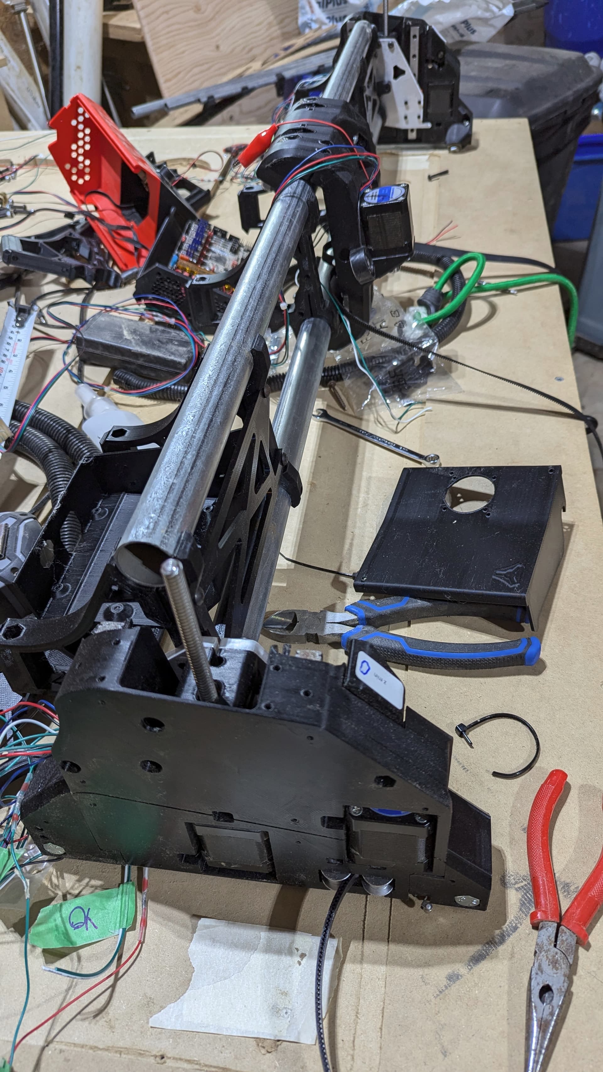

Well, here we go! Build progress to follow but for now, lets admire the de(con)struction of my LR3 build! Only 1 M5 nylock nut was lost in the disassembly process as it wont come out of the LR3 core, no matter what I do!

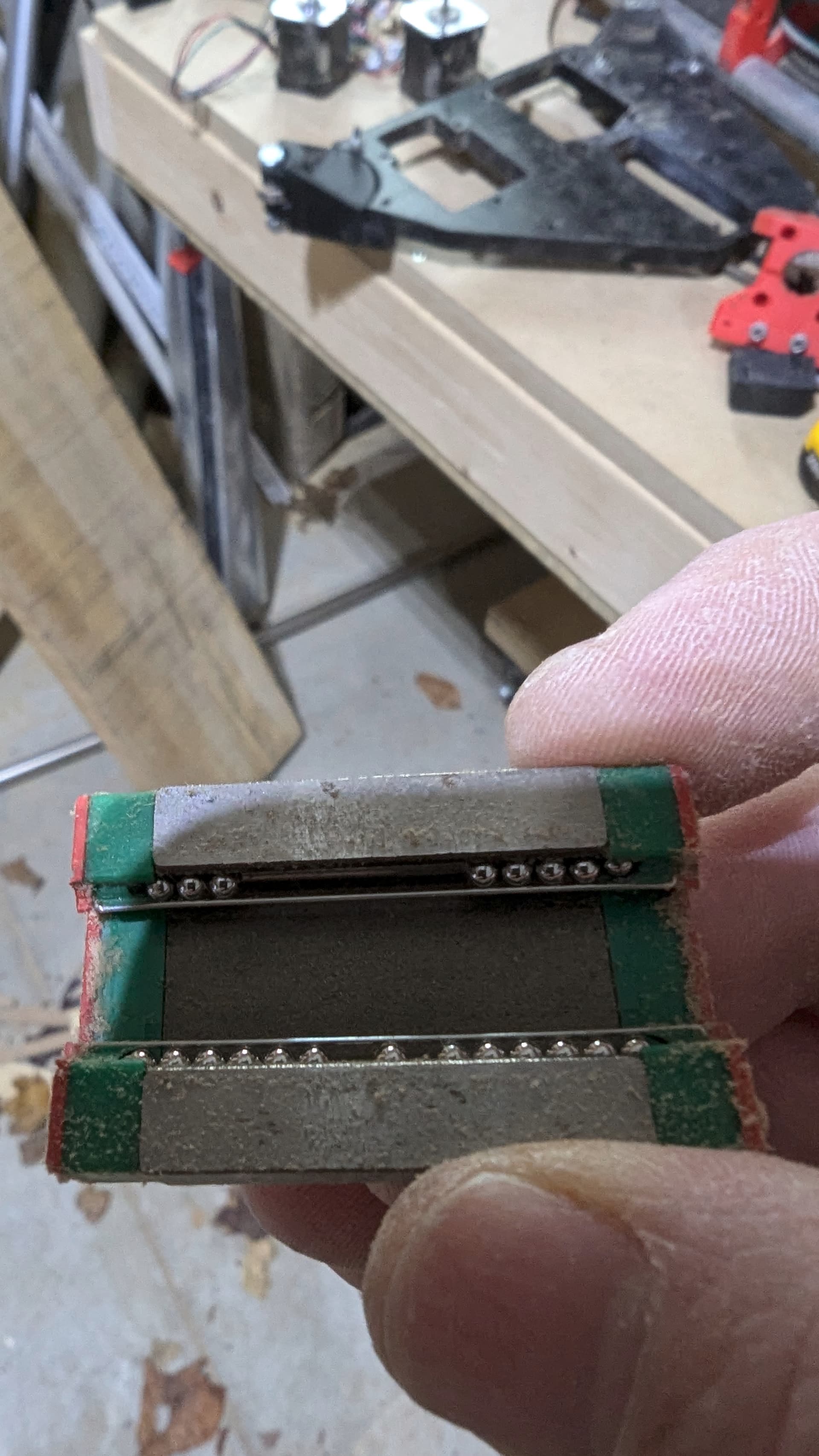

The smooth sliding linear rail carriage…bearing balls on order. What lube do you suggest??
I am going to essentially flip my X and Y directions for the LR4 build so it will be a 36"x48" build. I was having problems with my rail Z not moving correctly and so I was not able to cut out my LR4 struts using the LR3 so temp struts will be going onto this LR4 to start.
You obviously haven’t tried the hammer or hacksaw methods yet… :upside_down_face:
I definitely wanted to save the core. I sacrificed the x motor mount in order to get some screws out though!

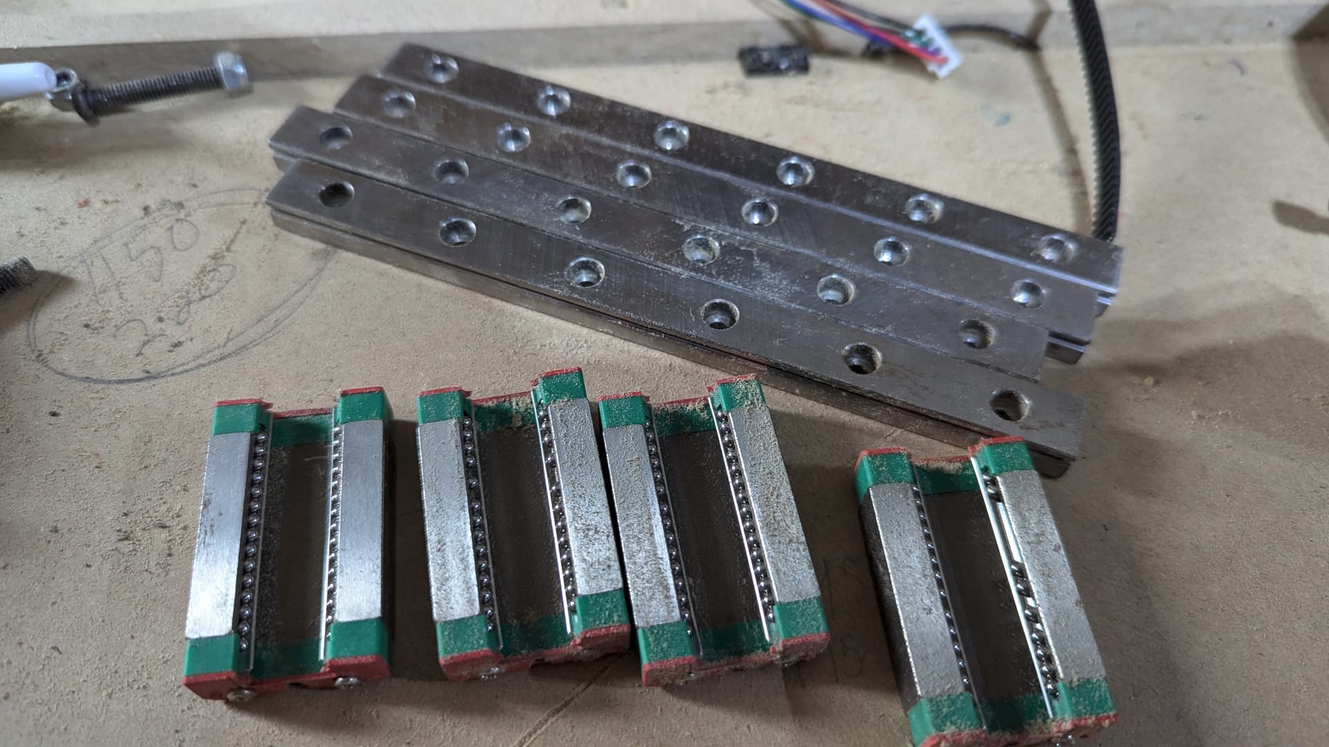

Today I took apart my linear rails in prep for cleaning in a bath of iso propyl alcohol to try and make them slide nicer. I will put the rails in too just to give them a good clean. I am going to go grab some silicone ptfe grease to lubricate the bearings and rail before I put them on.

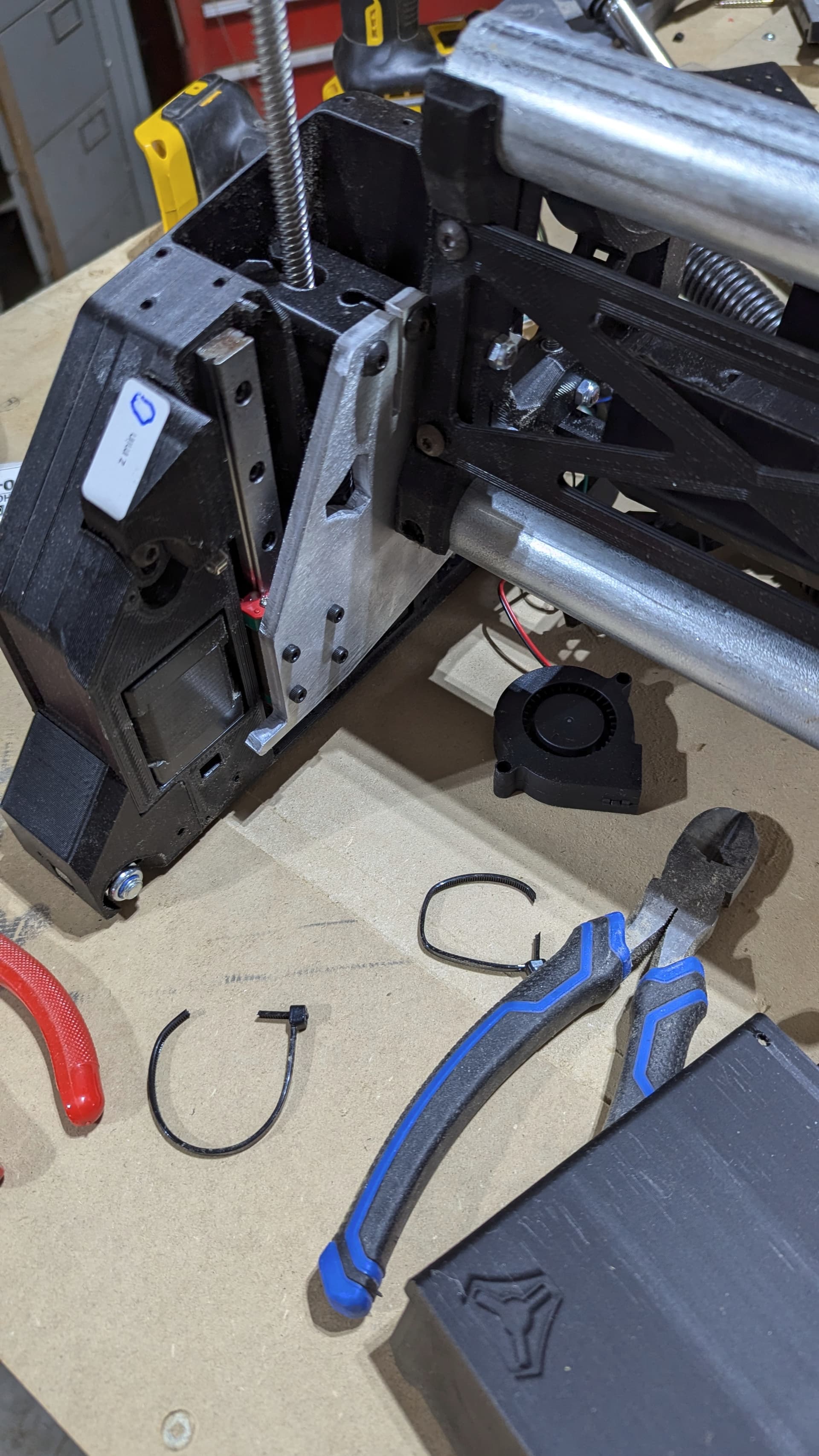

I also have most of the YZ assemblies complete. I had to cut off the stepper motor tidy zip ties and connectors off so I could fit them through the cable channel. I found with the second assembly that if you fed the wires individually through the channel instead of pushing it down to get it under the tab was much easier.

Got the xz plates on after lubricating the rails and carriers. Unfortunately one side slides great, the other not so great. I think I am going to disassemble the rails again and this time fully remove all the balls from the carriage and do a deep clean. One of my rails has a bit of a rough spot in one area so I may just have to buy a whole new set of rails. :persevere:

They are also hard to move if the rails are not exactly parallel. I‘d loosen all the screws half a turn and try to move the plate again. See if it runs more smoothly then.
Thank you for the suggestion, I was thinking of doing this but I didnt know if it was acceptable to have them a little loose. I guess the gantry will be attached to them so they wont exactly come loose? Obviously within reason.
You will fasten them again if they run smoothly. I start at the bottom, then push them up and fasten the screw that is the furthest up I can reach. That mostly helps. :slight_smile:
Today I have the gantry built and fastened to the YZ assemblies!

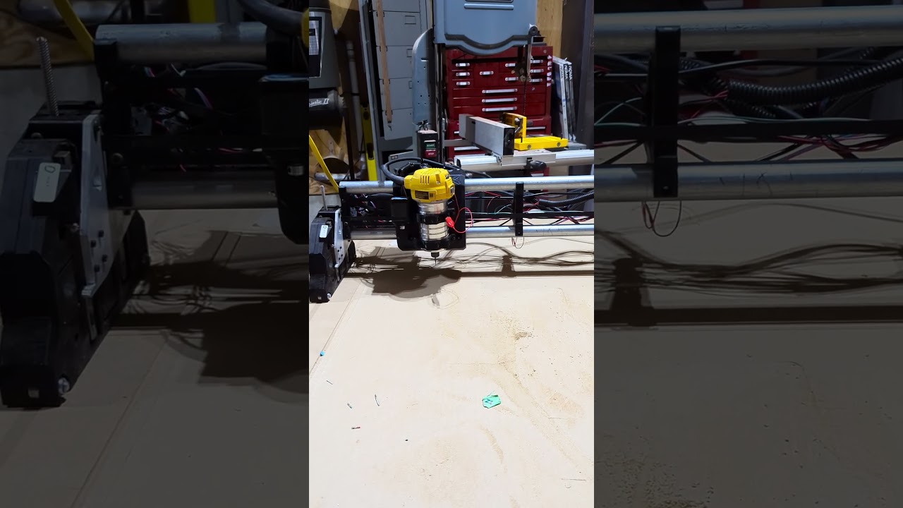

I thought, why not improve on the LR3 experience by doing an air cut just to see if the file will work!!
Seems like everything is working well. However, I have an issue with my probe at the start of the program. I have listed it below for scrutiny please. My issue is that at the M0 parts, I dont get a pause. For example, once I touch the probe to indicate Z0, it goes right to cutting the program…instead of me being able to remove the probe and turn on the router. I was researching online and some sources were suggesting M0 P? where ? is the pause duration in milliseconds. I did remove the ( ) around the MSG part of the start code…is that where I am going wrong? I just dont get the prompt on ESP3D for clicking continue etc…

I sure am liking the wireless aspect of the Jackpot. It makes it so much easier to move the machine around!!
