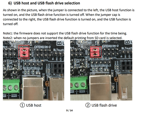

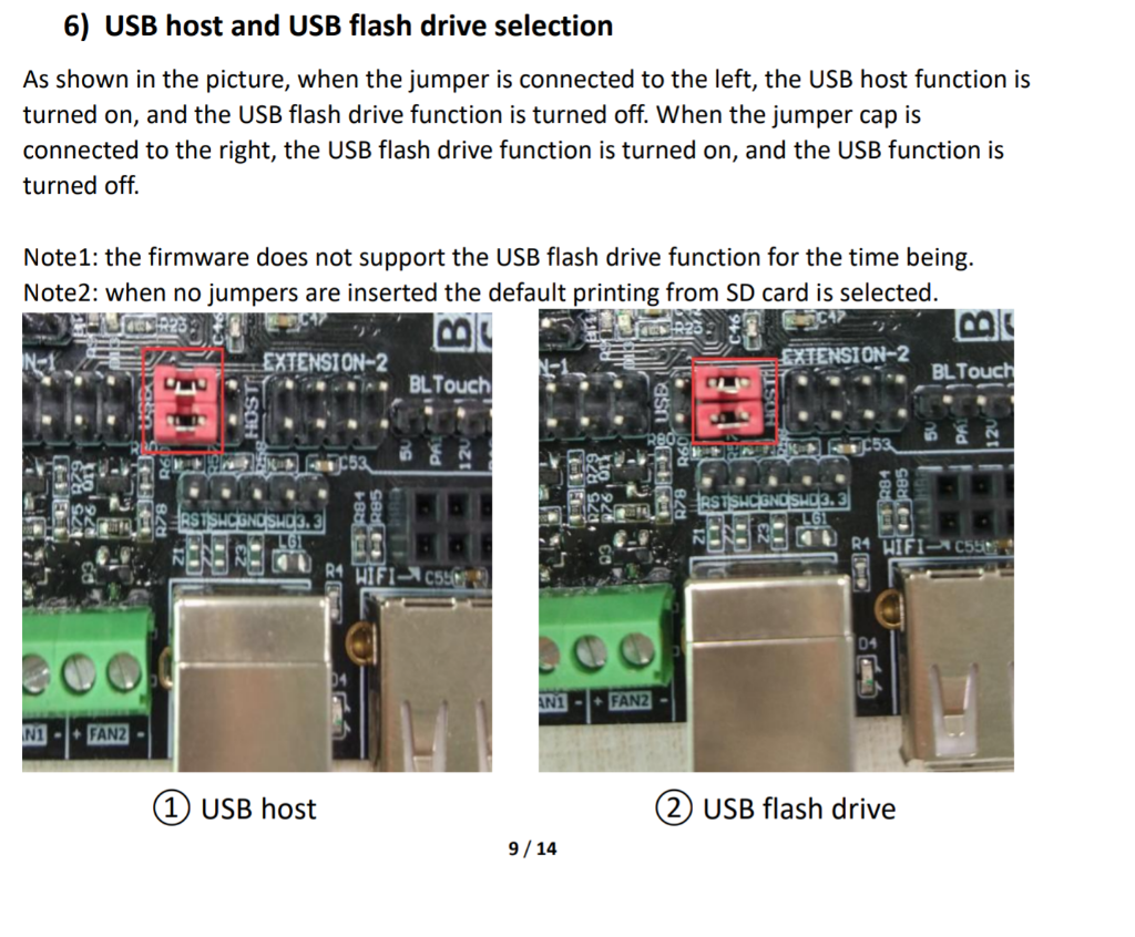

Maybe another piece of info to consider:
As per this image I have the USB host pin setup (LHS jumper arrangement).
I have not tried with the USB Flash Drive arrangement as I assume this should not work but perhaps it can help torubleshoot to try

Double check this. Your system is acting like it is misconfigured. Try flipping the jumpers to the other position.
Looks fine to me as well.
maybe I misunderstand the screenshot i attached but indeed flipping the jumper has it now working. Thanks for support.

Different jumper. This one configures whether the USB is Host or Device (e.g. whether you can atach a USB drive to one port or a USB host to the other.) It isn’t possible on this board to do both at the same time.
