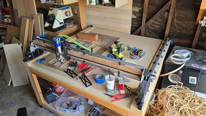

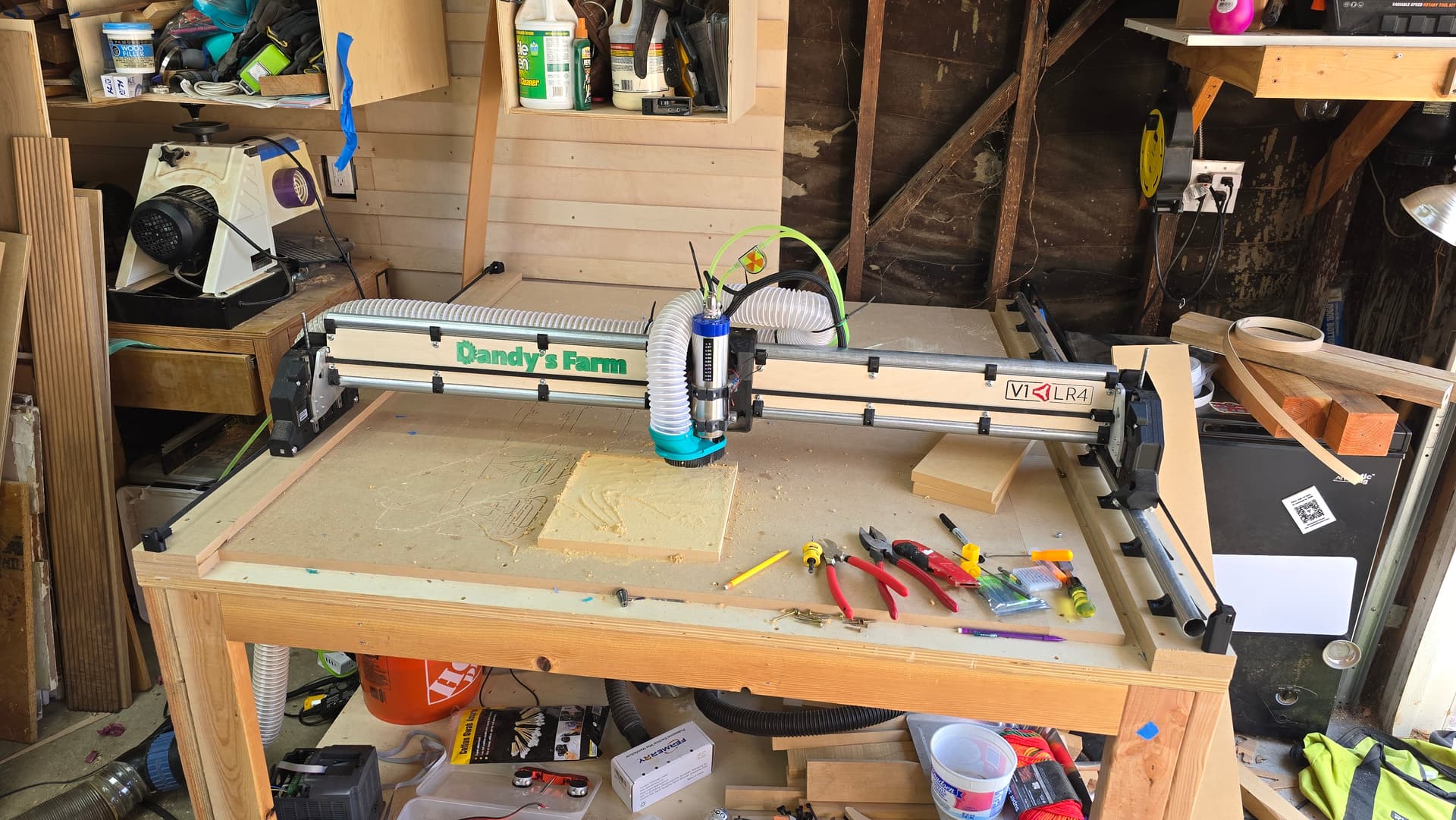

Hi! I finally mostly finished my 4x4 Lowrider V4.
I really like the changes in the new version. The parts all fit together great and have a more “complete” feel when built. My partner said, “Wow, it looks like a real machine instead of a toy.” I think the cable routing and the changes in the y carriages made a big difference.

I had an issue with the calculator when referencing my struts relative to the tube lengths. It looks like the struts are supposed to be about 2-3mm longer than the tubes. In the calculator on the Imperial setting, I noticed it has the same length. I found a forum post describing a potential issue so I recalculated using the Metric version, and it correctly added 2mm. However, then the strut generator will remove .5mm from the total length you input. So I had to increase by 2.5mm to get the increase of 2mm that I wanted. It reminded me of ordering and replacing windows. You add an offset and the company adds an offset… I digress.
This did result me in cutting my struts twice. Though I used some pretty flimsy plywood the first time and wasn’t very happy with them anyway. I bought some 1/4 Baltic birch ply for them and am happy with how they turned out.
The first time I cut my struts I cut each one in two pieces because my edge length was 49 inches and the strut length was 59 in. In the directions it says to cut your struts near the sides to avoid out of square issues. I tried joining them up straight and I don’t think it went that well. The second set I cut diagonally with the first set of struts on to give me some extra rigidity.

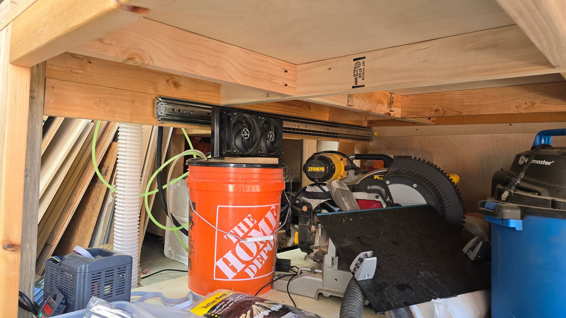

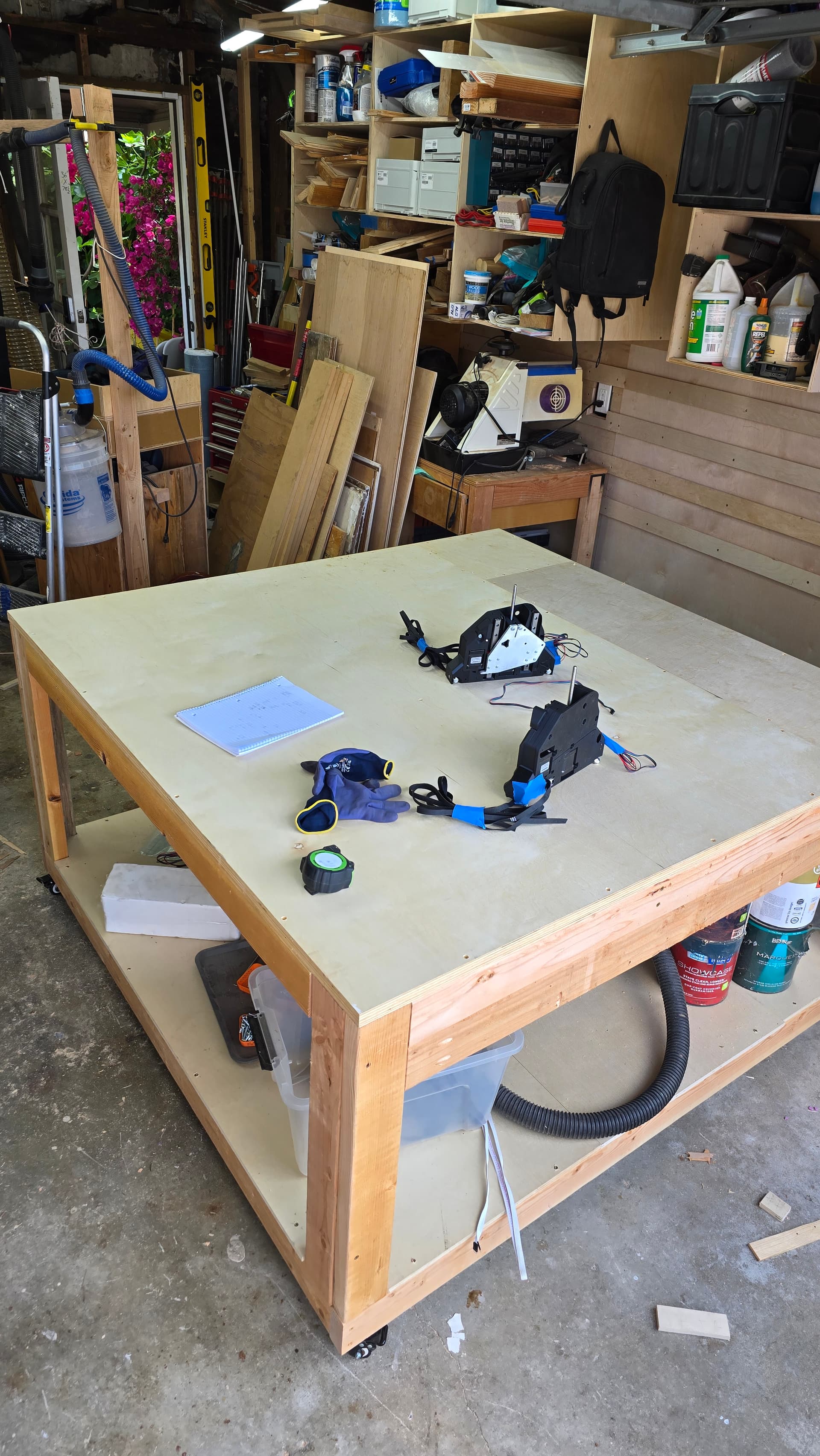

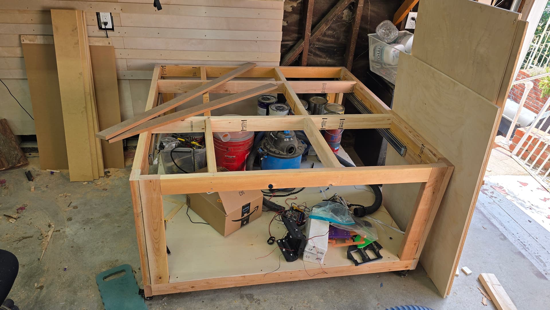

Extendable to 8x4?
I had this idea to use a giant set of drawer slides on the back of the table to make it temporarily extendable to a full size CNC when I had a job or idea that needed the full sheets. I haven’t tried it out yet, but my idea is to extend the drawer slides, build a lightweight platform, make some swing down legs, and move out the y stops to 8 feet. The regular y side should be easy, but the EMT side might be trickier. I think I will try making an internal coupler for the tube so I can extend it without having a “bump” for the wheels. We will see if I end up using it or trying it out.
So far, very impressed with the rigidity, travel speeds, Jackpot board, and the dust collection.
