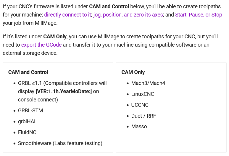

What are advantages of klipper? I liked grblhal because I could control from millmage and I think from xbox controller :smiley:
I controlled klipper from a switch controller. Millmage requires exporting gcode, but it is as easy as switching programs to upload to the machine and run and i used crowsnest with a camera for time lapse video creation..
Setup is straightforward after the initial flash. As long as you get it mapoed out right for pins, it eorks well, but even if you dont, it isnt hard to adjust and restart to fix it
You can probably run grblhal without any additional hardware, so that is a bigger deal.
According to the docs, if you have grblHAL flashed on skr pro you will be able to send gcode directly:
That is a nice feature

I’m a bit confused here, I can directly send gcode from lightburn to my fluidnc LR4… Which seems similar to what’s described here
