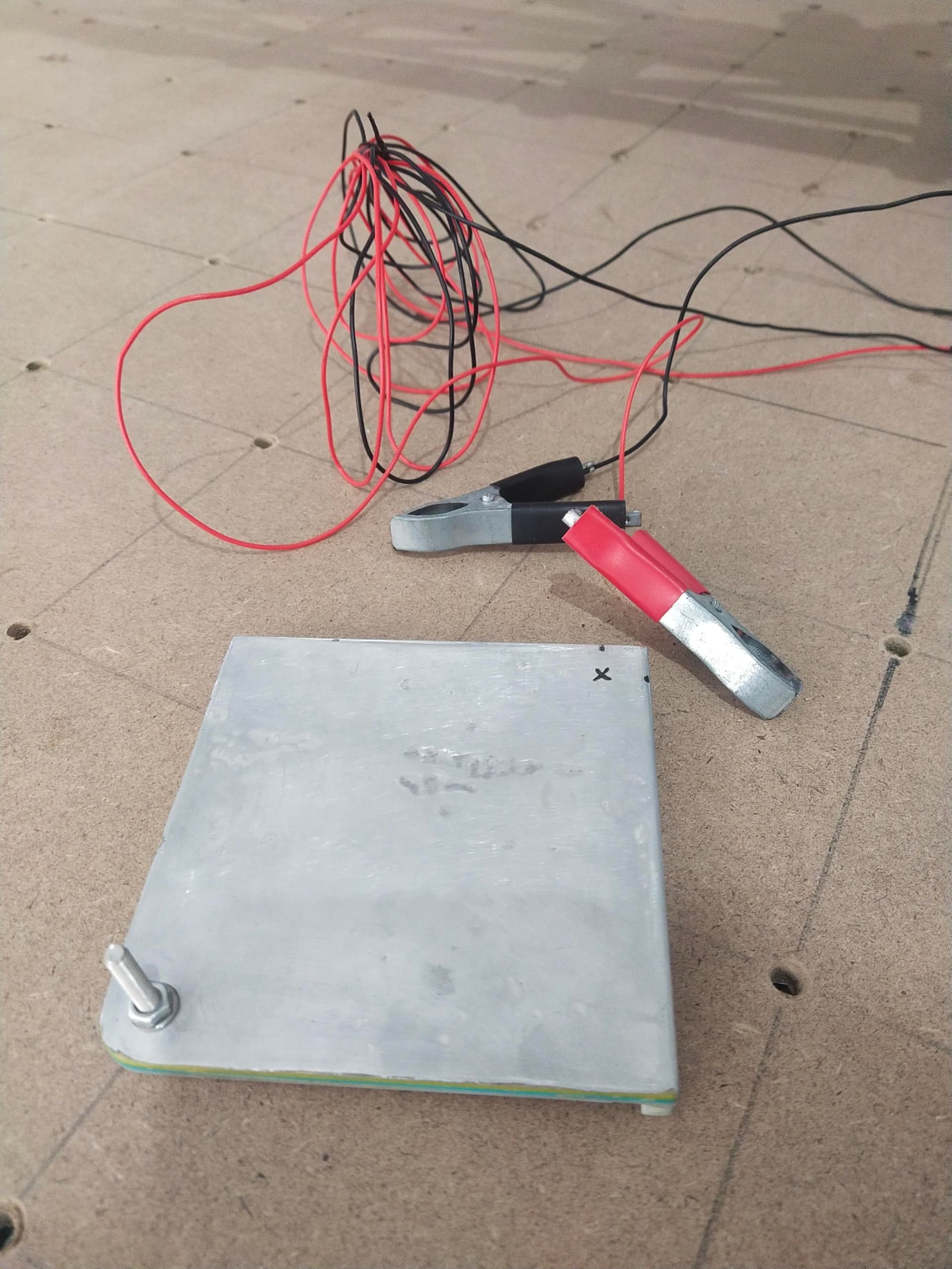

Finally got my LR3 hardware and table setup with few modifications, i’m using klipper and managed to make the XYZ axis, endstops working for now. With spindle and vacuum triggered by SKR Pro using SSR relay.
300 cm x 160 cm foldable table (mdf epoxy resin coated) with full sheet spoil board.
Spindle & Vacuum on off trigger by SKR Board via klipper using SSR Relay
I haven’t tried milling anything yet, and am trying to figure out to the last part to add XYZ Probe and created a simple 3d printed XYZ probe plate coated with alum sheet. Wired it to and it works, i just cant figure out how to get the XYZ probing to work with klipper.
I’m following the guide from Are You Ready to Learn to Write GCode for Your Touch Plates? - YouTube and adjusting the gcode to klipper, the problem is that klipper does not support many CNC gcodes and i’m using the config macros i found from GitHub - vladbabii/klippy-cnc: KCNC - Klipper CNC Macro Package. The only problem is that it seems that it has been coded long time ago and seems like is no longer maintained. (Especially the G38.2 gcode)

  1. For the Z axis, the endstop is at the top. I’m abit confused as i’m used to 3d printing. I got z height of say 70 mm. Should the top endstop be 0 or 70mm? Because i’m trying to figure how it works when we have gcode run thought it and afraid may make the mistake and ruin my gantry.
  • a) If it’s 0 at the top, and 70 mm bottom, does that mean when we mill, it goes say from 0 to 10 mm progressively down?
  • b) If it’s 70 at top, and 0 bottom (i setup like this now), does that mean when it mills, it goes say from 70 to 60 progressively down? Which one is correct a/b?
    Because in 3d printing, i got both setup, Z stop at bottom=0 (cartesian) or Z stop at top=0 (corexy). But milling is opposite of 3d printing as it mills from top, meanwhile 3d printing layers from bottom. sorry for these questions, i havent started in marlin and cant understand how it works.

G38.2 is tricky. Because we use that in Marlin for the low rider. In our Marlin setup, that probes down, until the Z touch plate closes the probe endstop. Then backs off 5mm (IIRC). You can combine that with G92 Z5.5 to set the Z height to the top of the workpiece. You can spend as much time as you want working on macros. They are a fun part of klipper, IMO.
You don’t need any of that though. You can cut right away with G92 to force the Z to be zero while the bit is touching the surface.

  4. Z probe should be easy, not much different as using BLTouch etc. I dont use Octoprint as i think it may be heavy load on the PI after reading. So im using both FluiidPi and Mainsail in the same machine that i can switch whichever interface i like, to control as many device as i can. I had to figure that out the hard way as not much tutorial but work like a charm running 2 prints on budget.

I home at X=0 Y=0 Z=0 of my spoilboard because in my fusion 360 CAM setup i specify the size of the stock. I use the MPCNC klipper post processor for fusion360 found by going to github and searching for cristianku/mpcnc_config (new fusion 360 post processor folder).
In fusion 360 i made sure i specified my stock size and set the start position to the bottom left of my stock (not the workspace)
My standard workflow looks like this
  1. home xyz to 0,0,0
  2. jog router up and to the bottom left (x,y,z =0) of my stock
  3. use G92 to set the workspace origin
  4. run the program
hope this helps! let me know if you have any questions and i’ll try and help the best i can.

Hi @RockinRiley. I think bed mesh isnt hard. U can use touch, or i use my own version of diy unklicky probe that can probe any non metal surface.
The only prob is prolly as @jeffeb3 stated, for cnc the bed is not fixed, if after homing and G92 is set, i dont know of it works, havent tried tho.
I myself disassembledy LR3 as im in need for space and havent used it.
Now in the midst of reworking it into a modified 3 in 1 table woodworking table (table saw, router table and mpcnc).
Still WIP. Havin tough time squaring the base and still, going to try work the klipper out next.
IMG-20230531-WA0019|281x500
Interesting, just found the unklicky. The klicky is what I had in mind, will need to see how that differs and see what I can do, thanks!
