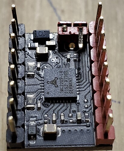

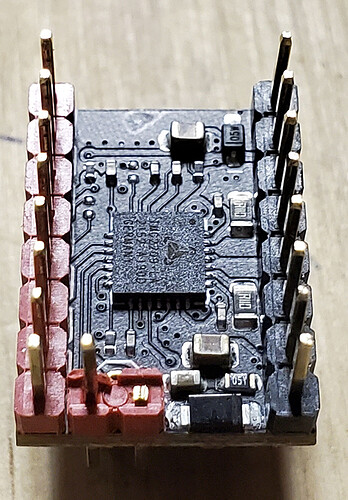

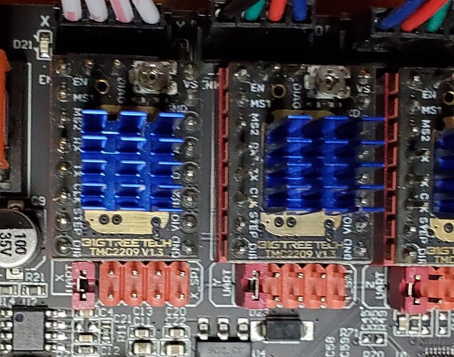

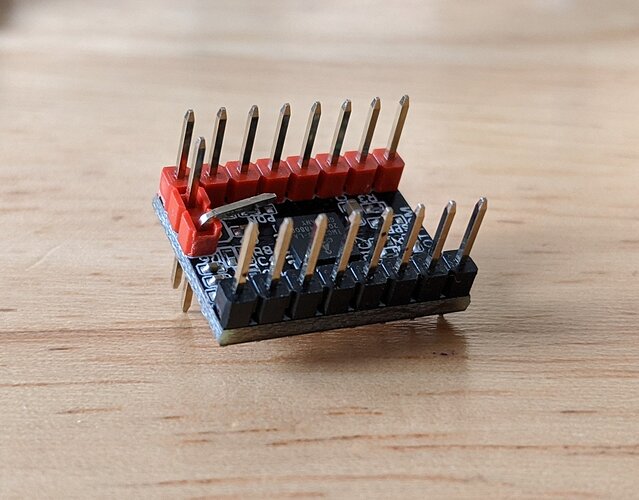

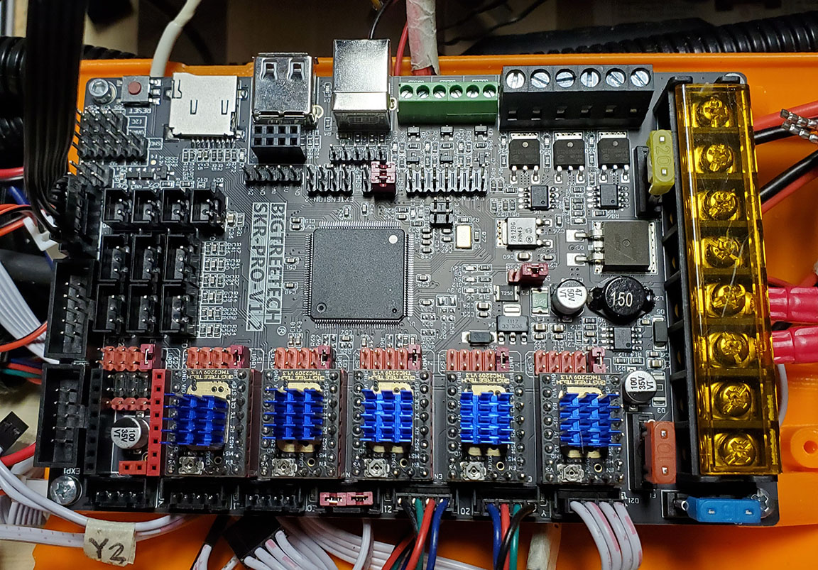

Installed all UART jumper only on first pin-pair for all drivers:

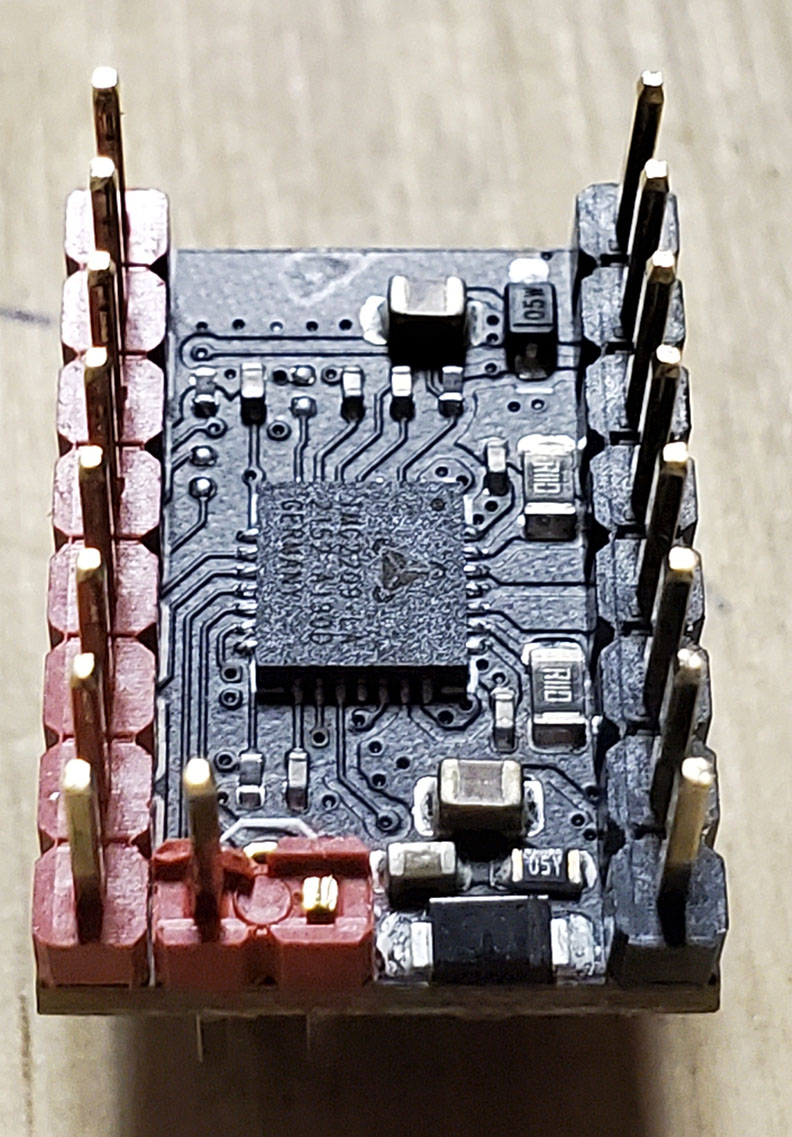

Bent the pin on each TMC2209 driver back:

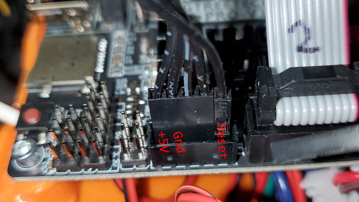

The serial cable connectivity has been checked; end-to-end continuity, and can reset the SKR Pro with the reset button on the TFT35.
Serial cable installed into the TFT35 board:

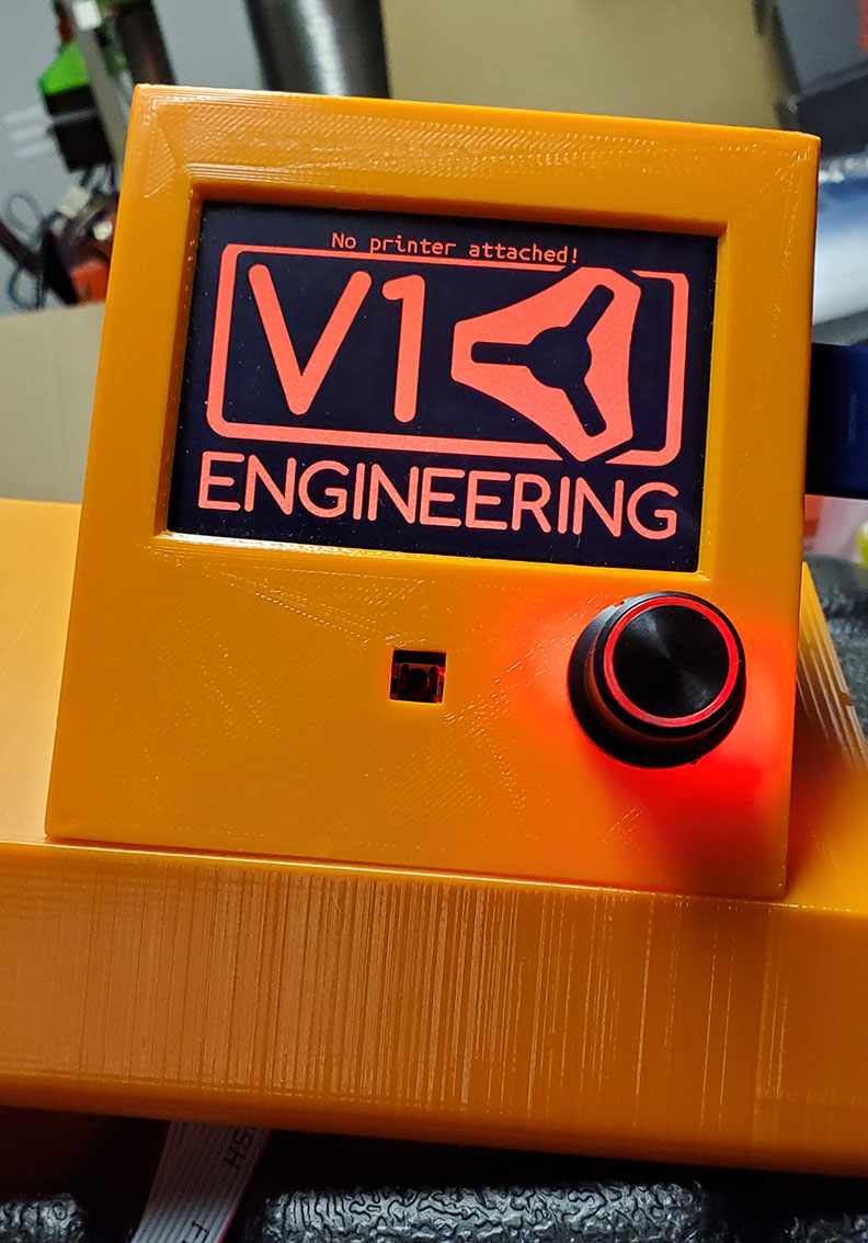

When start up the V1 Engg Splash screen shows up.
After about 30seconds, the TFT35 would beep few times loudly.
Hit the Settings button and shows the custom menu and disappears…

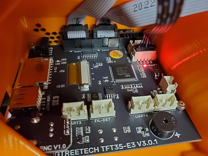

I guess you tried to flash the wrong firmware. You need the “GD” package.
Your TFT is a TFT35-E3 V.3.0.1 version. These come with the processor GD32F207 as you can see on one of your pictures. The correct firmware file for this processor is BIGTREE_GD_TFT35_V3.0_E3.27.x.bin.
That is the wrong pin. You want the bent pin there to make contact. The other pin that has been clipped is the one you need out of the way. Compare to this image from the V1 docs:
The pin seems to have been clipped on your drivers. The pin you have bent is one you still want connected…
I had the UART black wire backwards on my TFT. the JST plug fits in the SKR or the TFT, but the dow pin side with the jumper wire ends was 180 degrees off (meaning I had the pins backwards). you might try that for touch screen mode, but where you are getting both marlin mode and touch screen mode to fail, you may have the firmware version issue as mentioned above.

Hi Christian - thanks for noticing the GD processor on the TFT board.

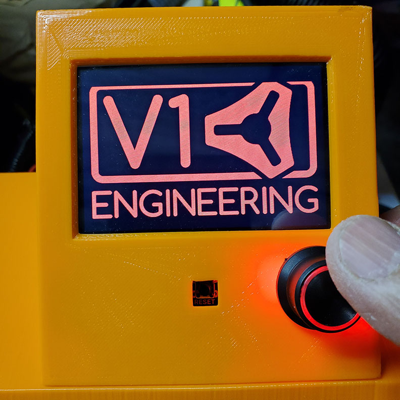

The correct FW loaded onto the the TFT board:
TFT FW loaded
The TMC driver boards pin bent back to the original position:
Verified the Serial cable connection:

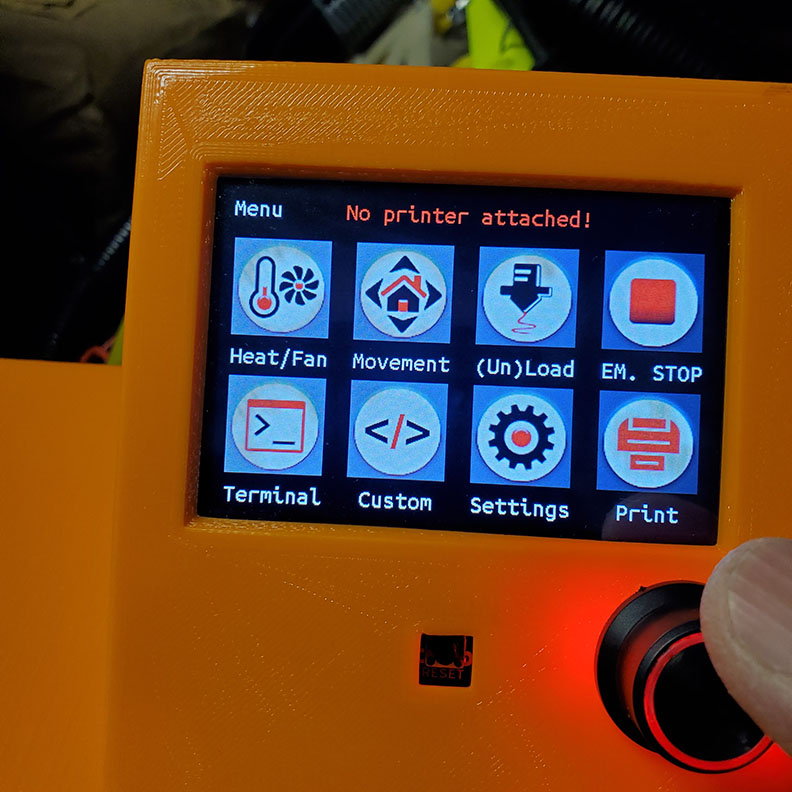

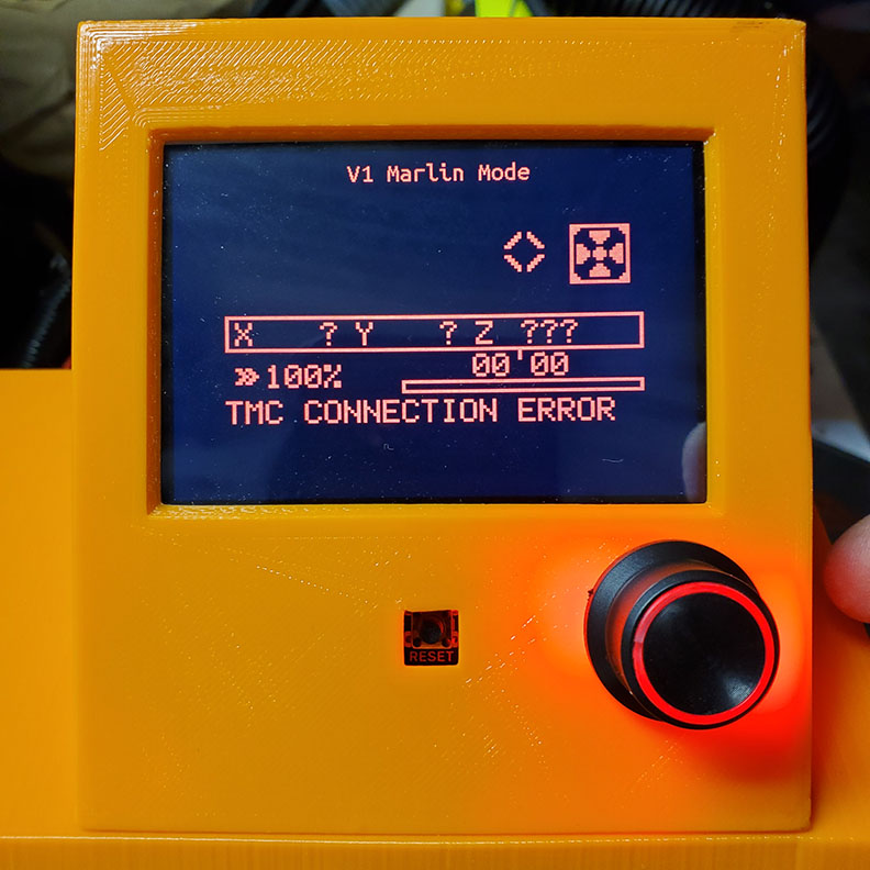

Start up>
Marlin mode:
![20230418_084215|499x499]
(upload://pVcRSXNSjZmu1Om644rZu1DJutI.jpeg)

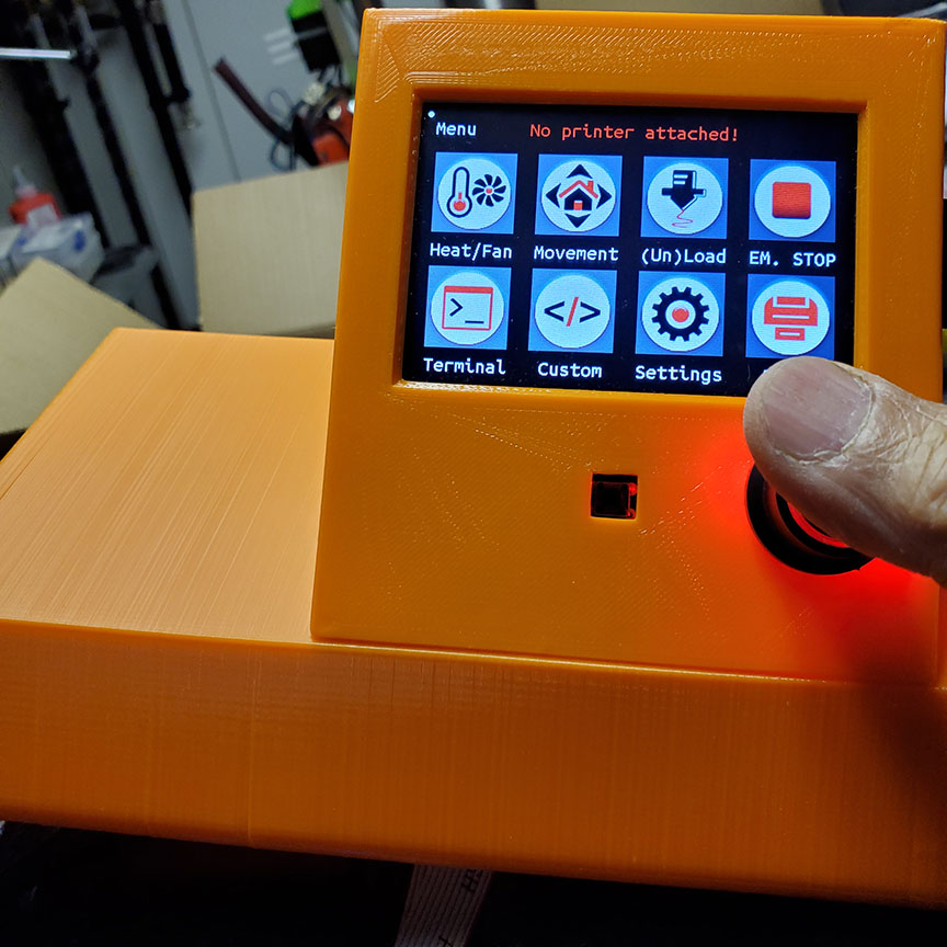

Touch Mode:

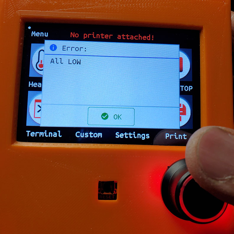

Beeps after a while i guess showing error:
Goes back to the original mode showing Marlin and BTT Touch Mode icons.
Still no printer attached error. :frowning:

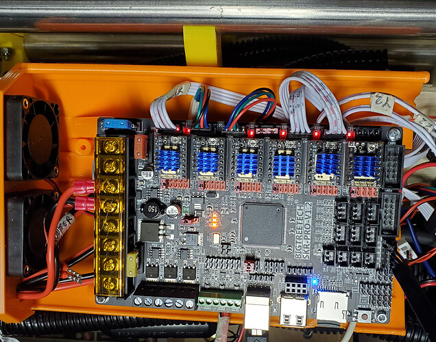

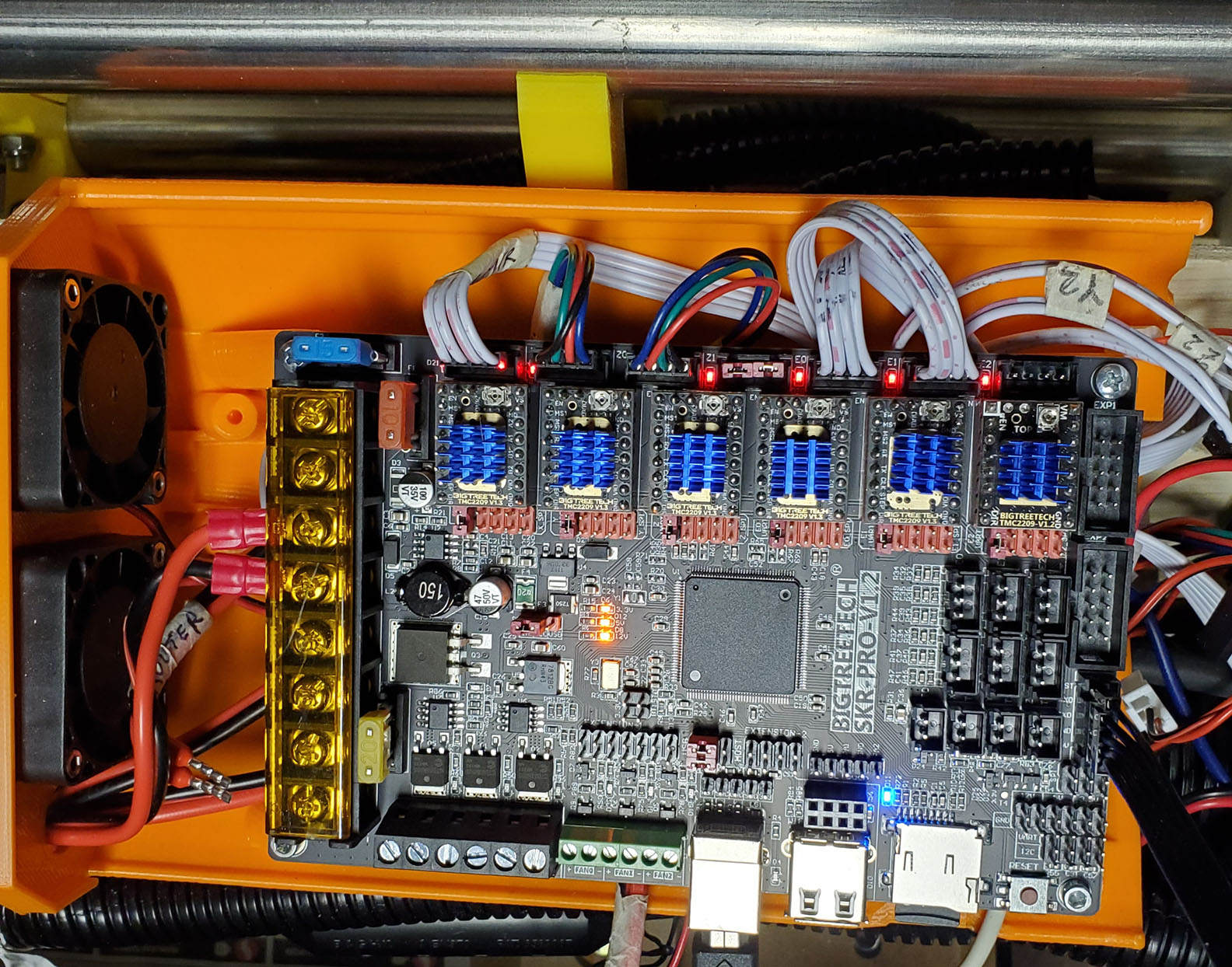

In the picture of the board, I see 6 drivers where there are usually only 5. I don’t know what effect that has.
I also notices that all but one led shows triggered, and the one missing is Y1 so, how are the homing switches wired (should be NO, normally open) and have you checked the wiring to the Y1 switch?

Shouldn’t have an impact. The skr won’t look for any tmc driver if it isn’t configured for it.
That is the screen thinking it can’t talk to the skr. But it is receiving the all low message (which is the same problem as TMC connection error). So it is talking. So my guess is the skr or the tft still doesn’t have the right firmware flashed.

oh, the last TMC 2209 driver was removed when bending the pins back on the other drivers.
No endstops have been connected.
Y2 and Z2 motor wires not connect til the rotation direction has been determined for Y1 and Z1.

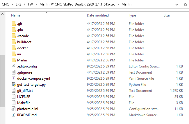

This is firmware I complied in pio for the SKR Pro v1.2 PCBA.
There should be a firmware.bin with the source code. You can just put that on the skr sd card and it will flash it. No need to compile it yourself (unless you are into that sort of thing)…
That looks ok to me. The *.cur extension indicates that the files were properly flashed to the screen. From what I‘ve seen so far, the TFT ignores firmware files that don‘t match its type/version. So it is highly likely that you‘ve now got the right TFT firmware installed.
On startup of the TFT this message always shows up, but disappears after a couple of seconds. This is normal. Can you see this message permanently?
Can you please also check your power supply cables. I couldn‘t see how you‘ve connected power to the motor power connectors of the SKR pro board.

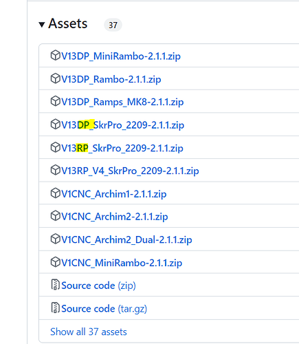

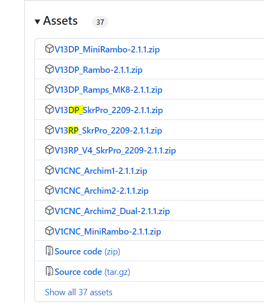

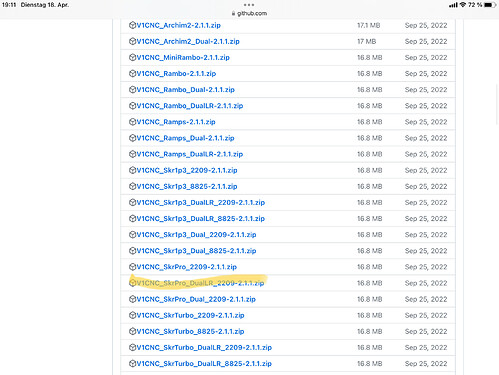

To eliminate potential issues with your VS Code / PIO environment, I‘d try to flash the pre-compiled firmware from the V1 repo: https://github.com/V1EngineeringInc/MarlinBuilder/releases
what’s the difference between DP and RP?
Don‘t know what the difference is. These are for 3D printers. You’ll need the firmware.bin file from the archive V1CNC_SkrPro_DualLR_2209-2.1.1.zip
That’s where the link you referenced goes to…
It links to the whole page. If you press „Show all 37 assets“ at the bottom you will find the file
