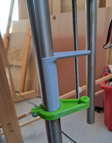

Came in my mind I can make a harware solution for the software problem :slight_smile:
Quickly printed an attach-on 2nd Z endstop plate. Now i can manage the long and short end mills.
