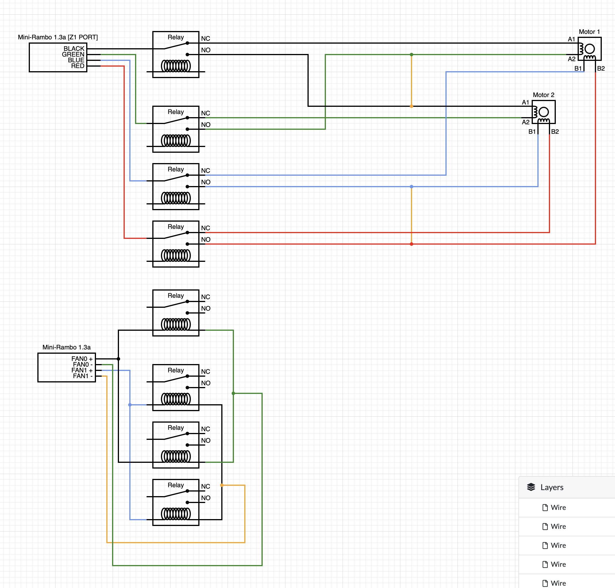

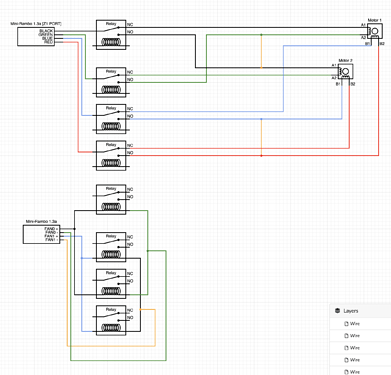

It appears that my board does not contain enough drivers to perform dual end stop homing so I have designed a Serial Stepper Multiplexer board which should let me disable each stepper individually.
The default state of the board is to have 2 motors connected in series, to the input, the A and B pin pairs are directly connected to the relays, when 5VDC is applied then one of the motors will be disabled by having both of its coils disconnected.
My first prototype boards will be arriving in about 2 weeks and If this works well I will look into a third revision which includes hardware debouncing for the ends stops and some straight through connectors for a third probe/end-stop to assist with cable management, and another to allow for an external Z-Probe attached to the board (again, Optional assistance for cable management. )
I hope that the 2 FAN PWM outputs can provide enough voltage to trigger some HK19F-5V relays or if I can find a nice source of “4 cleanly grouped outputs” which could trigger said relays.

so some questions for the community:
  1. will the EMERGENCY_PARSER directive work with the mini Rambo ?
  2. does anyone know how to enable max endstops in marlin ?
  3. Is there a definitive list of settings for configuring the marlin for the mini Rambo board to control the LR2 ?
  4. are there any spare pins which I can utilize to trigger relays without loosing GPIO functionality ( currently I only have the fan pins, I read somewhere that some of the end stop pins can be utilized as a PWM.
  5. Can anyone please poke holes in my design ?
