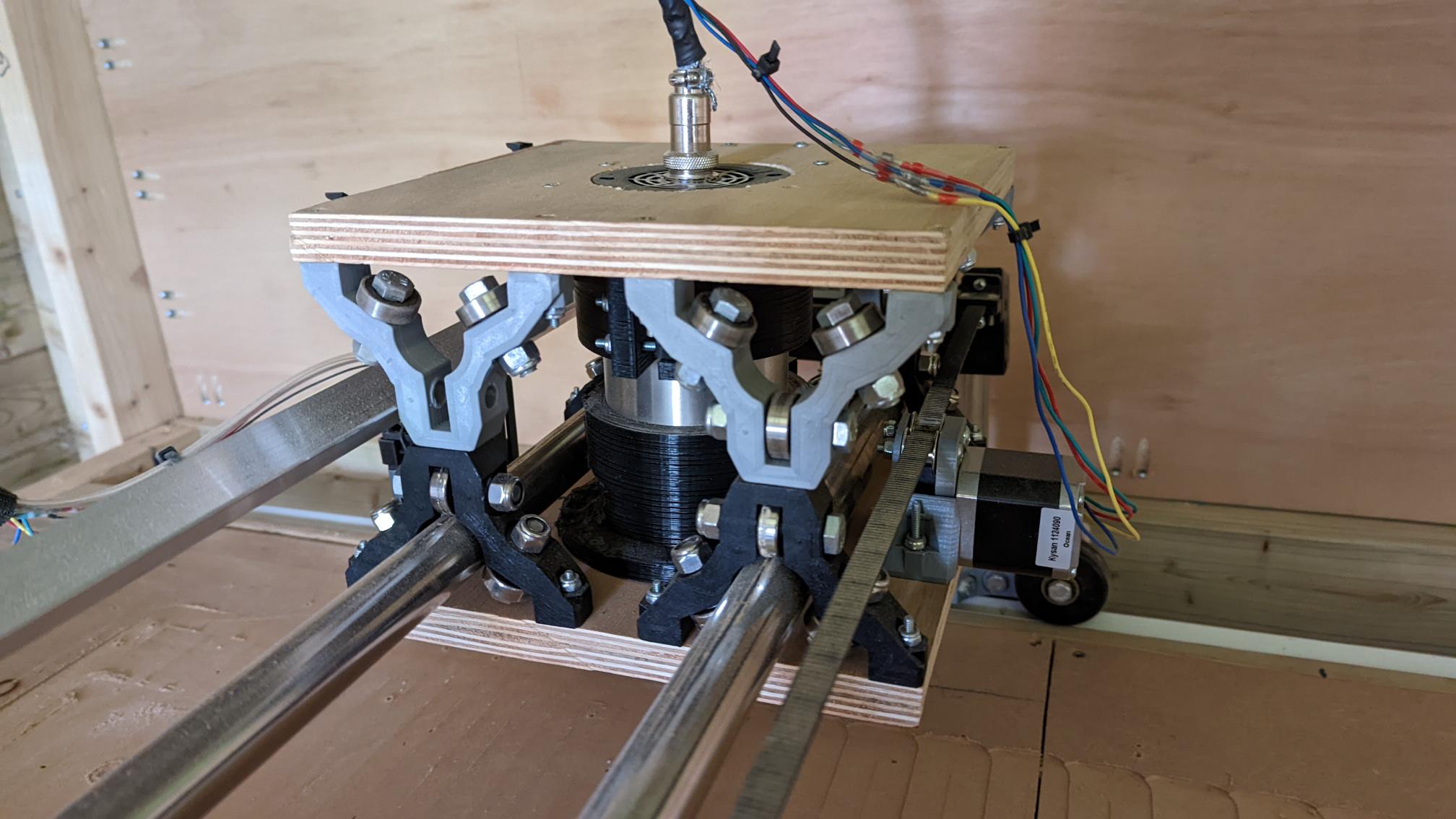

Started last year and gave up because my bits where always burning, this year I reached out on the forum and was told to check the rotation of my spindle and it was the spindle spinning the wrong way why it was’nt working. 1.5kw chinese spindle and a Sculpfun S9 laser. Putting cnc in a sound proof box as it’s in my garden shed so don’t want to annoy the neighbours. Printed Y plates on my 3d printer and then printed at about 3mm depth in ply and cut them out by hand, changed plates over and finally printed plates using 18mm ply. Still a lot of tuning and tidying but she’s getting there.
