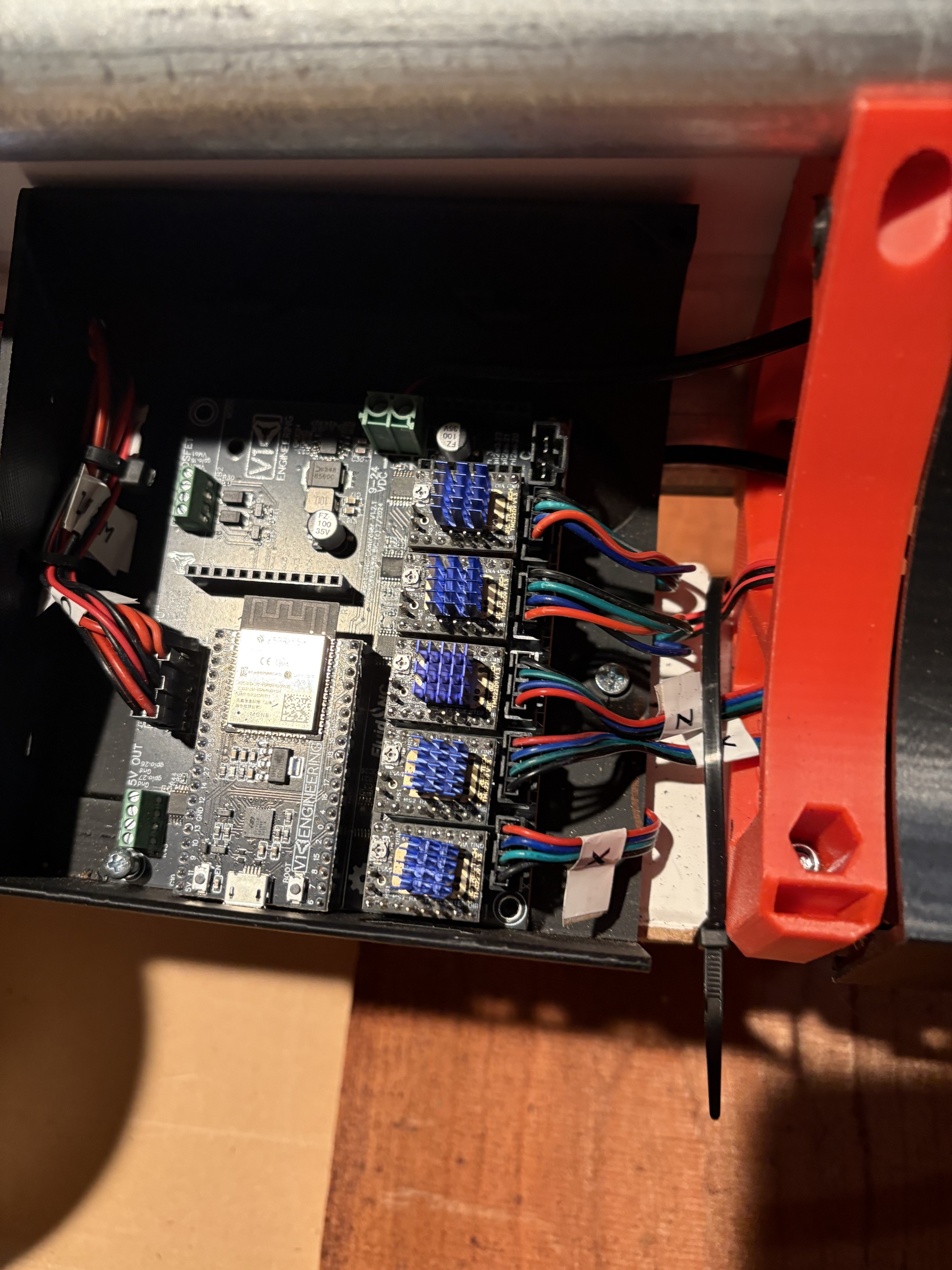

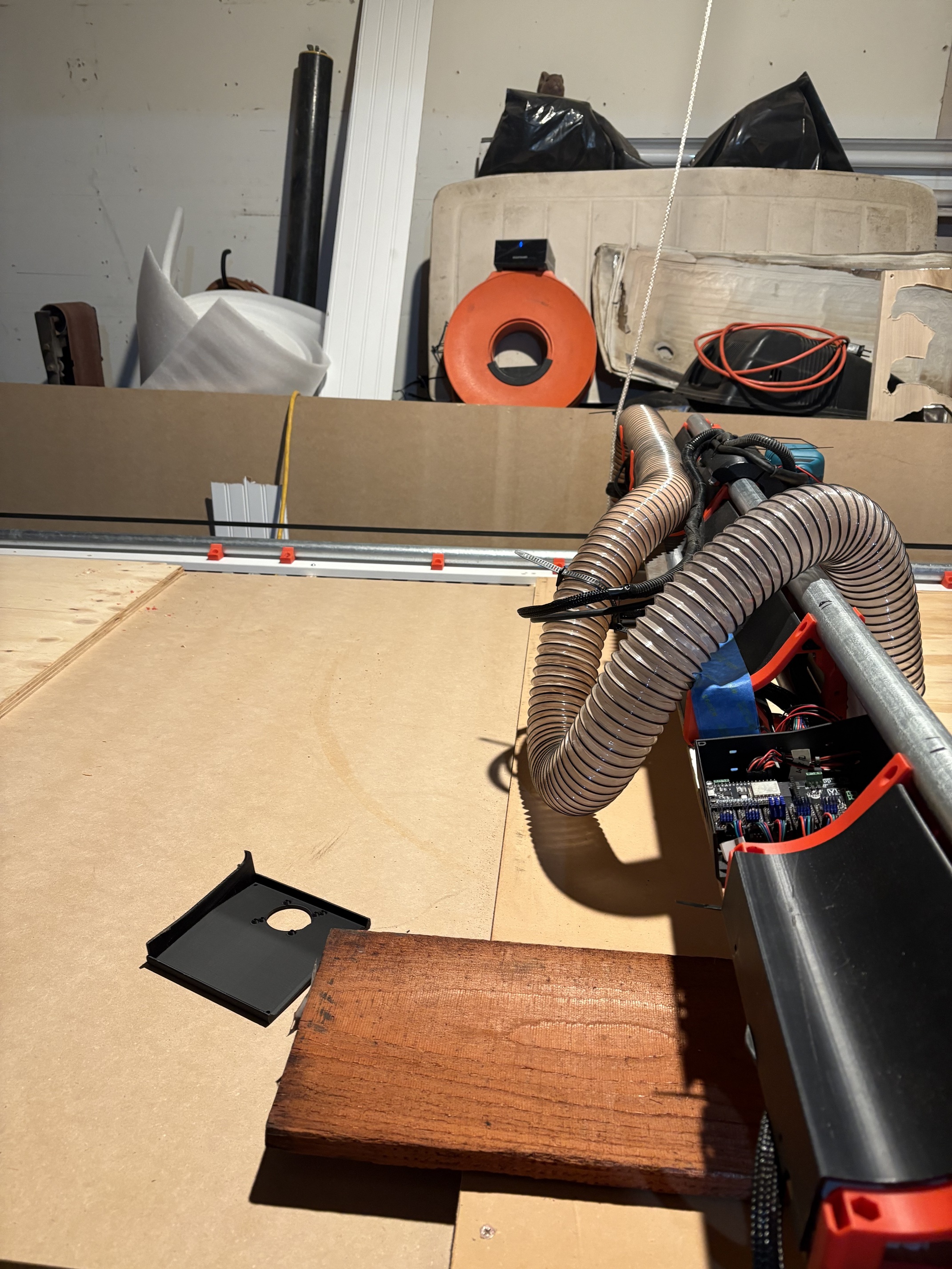

One picture is the controller in the wiring seems to be plenty of clear of the antenna. The second picture is my satellite for my wireless. it’s like 6 feet away.

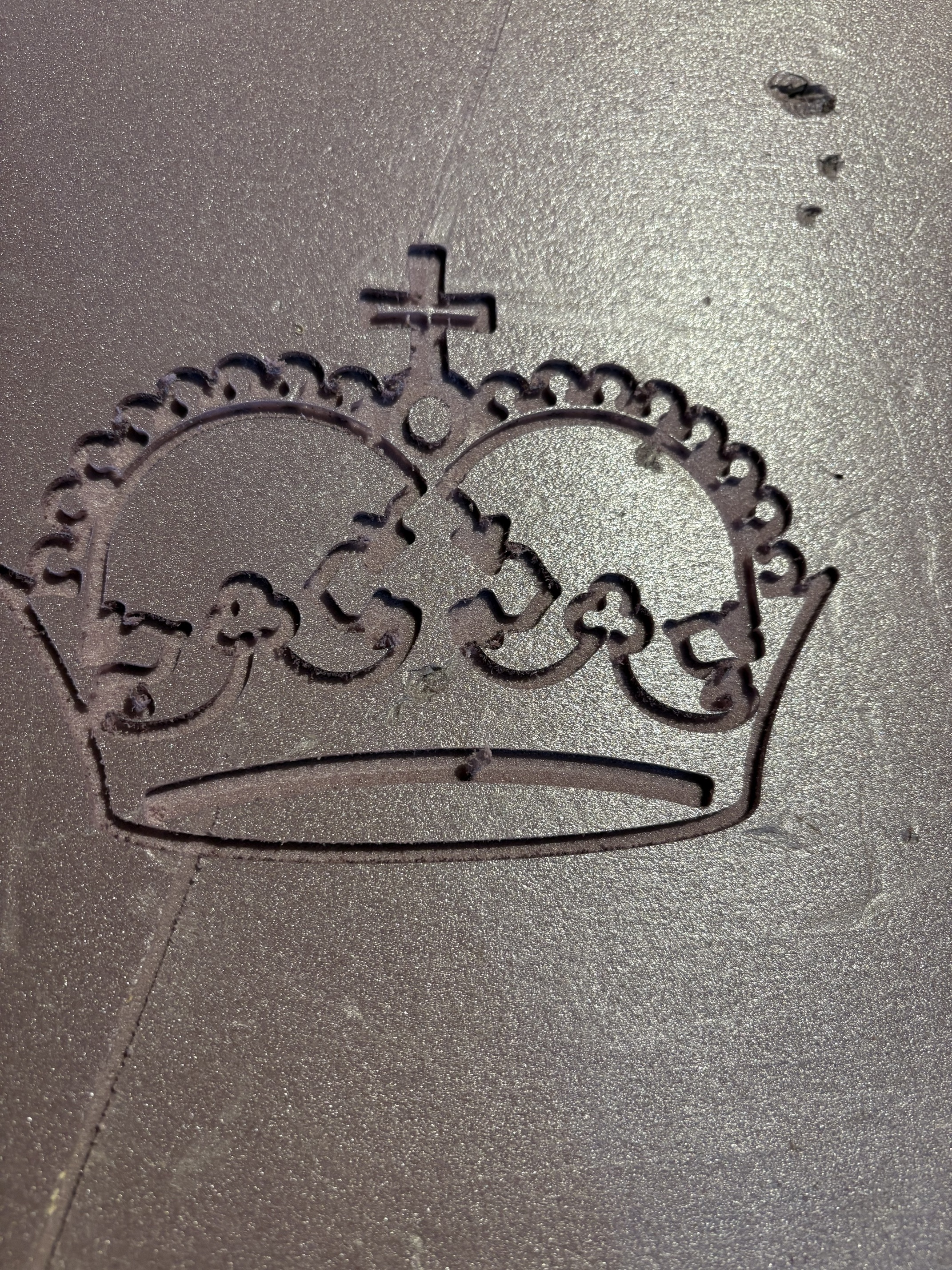

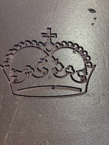

This afternoon I brought down my new hp Laptop and it seems to be a lot better. I did five air crowns 4 of five went through The first one stopped at 60% also cut some foam
I have done the Z tests it seems to run G code fine but if I sit around, I go back to it. It’s nothing works. I have to shut it down and restart. I ran five crowns back to back no problem, cut crown, and foam picture on last post
