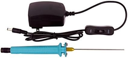

Was looking at this and the possibility of doing a hot wire cutter that would do all of the rough cutting of the Y-axis. These kinds of hot knives are typically used on Styrofoam - I was planning on using this material to make my bucks.
So, not sure if that will work for me. But worth a shot! Thanks for that link.

Here’s info on hot-wire-cutting: http://gallery.hotwirefoamfactory.com/faqs/faqs-foam/ good luck with your project, however you choose to proceed.
Awesome, thanks for those links and that info! Once I have things going will be looking into a way to add a wire to the Y-axis that I can cut the rough shape out with, to save on time and help cut down on time needed to do pssses with the spindle.
