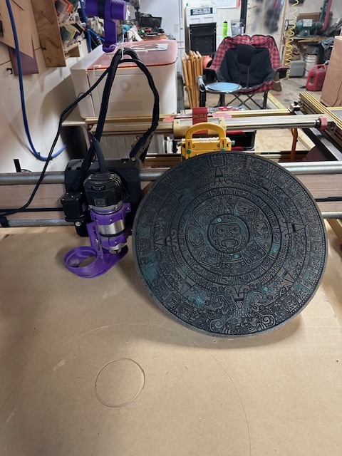

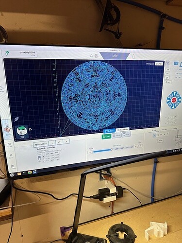

This has truly been an enjoyable experience. Thank you, David (dkj4linux), for your guidance and assistance with the miniPC setup. I now have the option to control the machine from my laptop or simply use my miniPC. I love the flexibility to use either option.

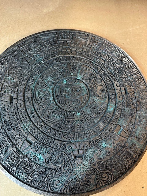

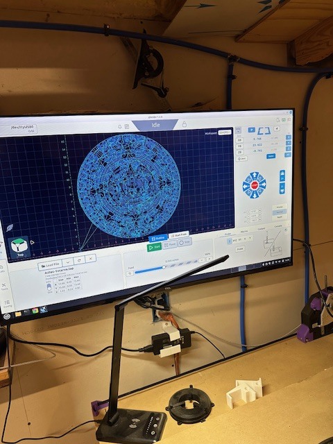

Okay folks, here are the answers, and I hope I’ve addressed everyone’s questions.

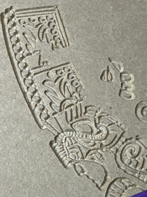

I used Aspire software, but you can also use VCarve. I got the image from the web and used LightBurn to trace it, then exported it in Illustrator (AI) format. You can also use DXF if preferred. After that, I sized it in Aspire to the dimensions I wanted; in my case, it’s a 15” diameter design.
I selected the entire design and used the VCarve option with a .25” 60-degree V-bit. I followed the recommended speed, which I believe was 15,000 RPM. In Aspire, you can choose the depth of the carve, but I left that setting alone and let the software calculate the depth based on the thickness of the material, which I used as .75” MDF.
Once I generated the G-code, Aspire offers several post processors, such as “Generic Gcode ARC inches.” I then used the cut option and utilized a .125” end mill with the recommended speeds.
As David mentioned, different controllers may have variations. I prefer using G-code sender on a Linux mini PC. I will load the pictures shortly. After generating the G-code, always double-check it, especially if you’re working in metric versus imperial units.
For my files, I simply edited the G-code by adding “G20” at the beginning so it recognizes inches. I ran a test to ensure my home point was set correctly, and voila!
As promised, here are the pictures. First, seal the MDF with black primer from your local hardware store. Then, spray it with a patina color several times. I utilized the cap from the spray bottle, building up a puddle of this color and splatter it all over while continuing to apply the patina color. Let it tack, then spray the entire piece with metallic bronze. Finally, seal everything with clear gloss.

Oh yes, I completely forgot to mention this very important detail: it took 3 hours and 34 minutes. This project was definitely a test for this machine, which again impressively handled the job.
Okay, I hope this answers all your questions. I used a budget-friendly Genmitsu 710W compact router with a 65mm variable speed setting.Amazon.com

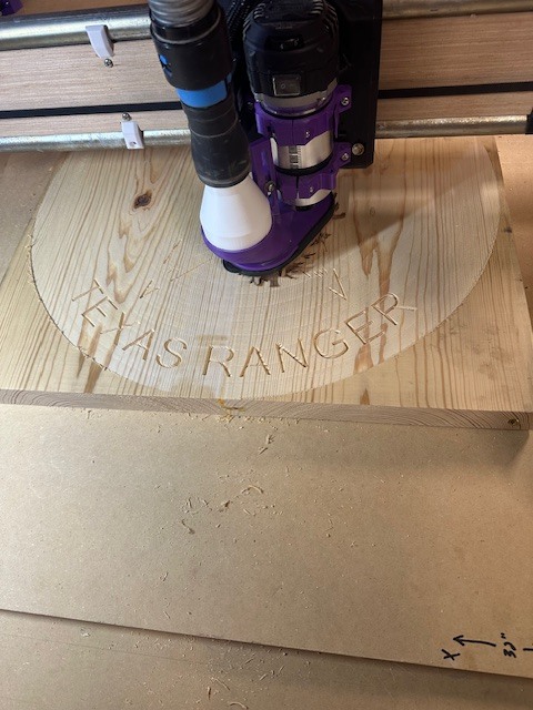

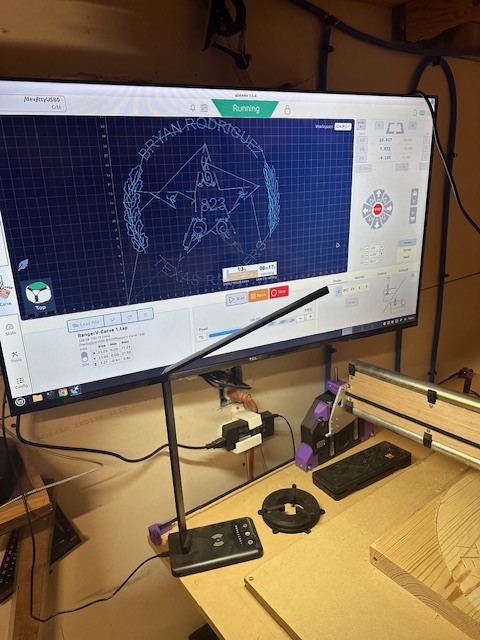

Well gents!!!

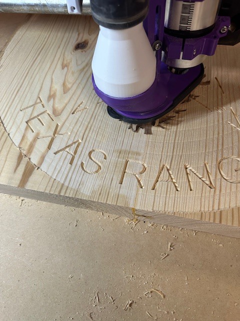

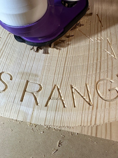

I’ve put the machine to another test: carving a Texas Ranger Badge as a gift. I usually make these on my “big” CNC without issue, but that machine is noisy and aggressive.
I wanted to see if the LR4 could match that quality, and honestly, the results are amazing. The carving detail is excellent—I actually prefer it over my big machine for this kind of work!
“The noise reduction is a huge plus, too. I’m blown away by the carving quality and detail—it looks fantastic!”
