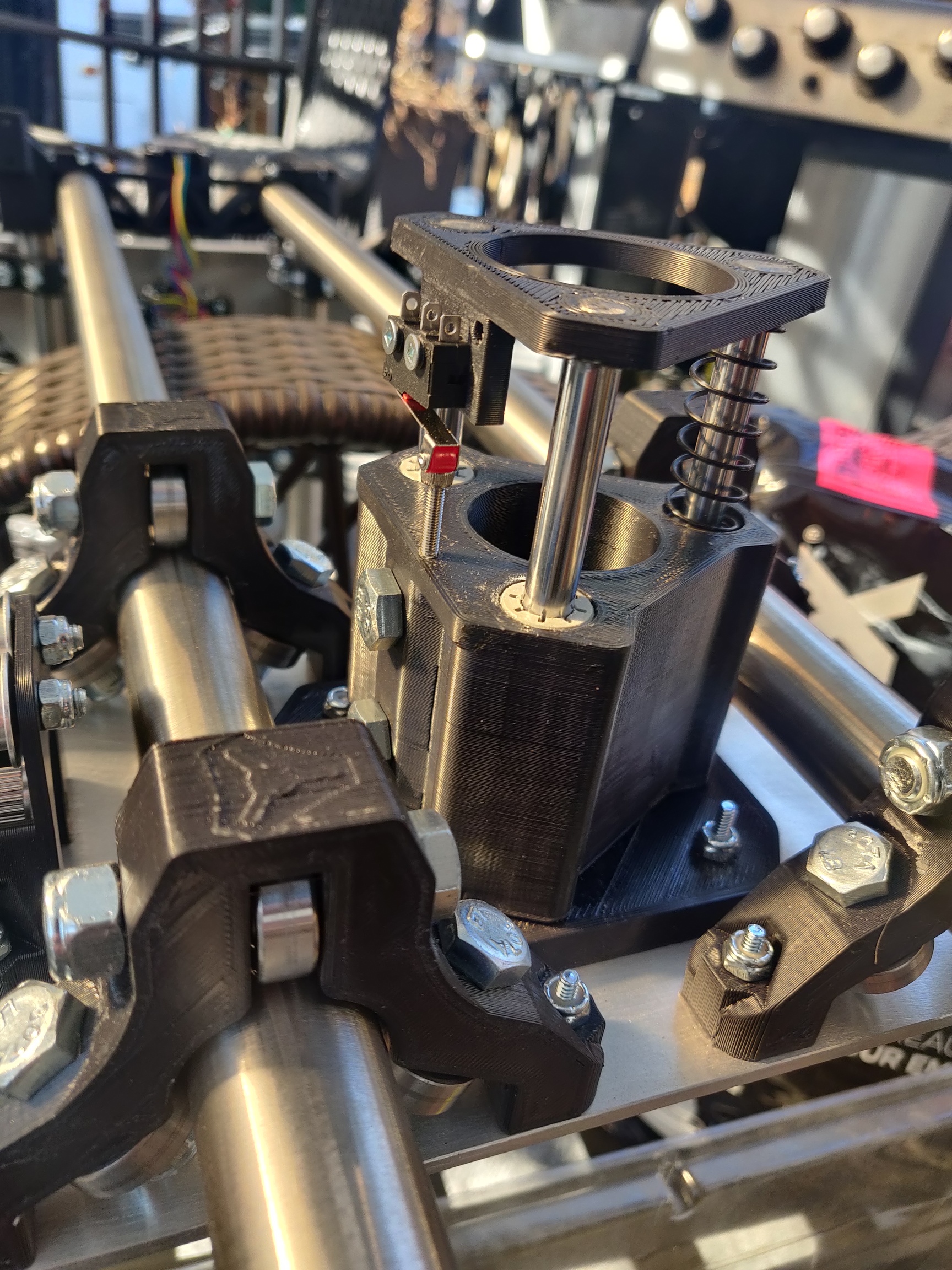

Here’s the stl files for the torch holder. TorchHolder.zip (176.2 KB)
What length rod did you use? I have everything ready to go and went with igus bushings for the 8mm rod. I ended up Raptor lining my table.
163573953_204176891463671_179686294073570645_n
3 each of 8mm diameter x 100mm long linear rail shaft rods
6 each of LM8UU 8mm linear ball bearings
1 to 2 each of hex nuts with set screws (I don’t remember the size, 3/16" or 1/4" maybe)
1 to 3 each of springs that’ll fit over the rods.
I ordered the rods and bearings off banggood and got the jumbo set screw and spring at ace. I only used 1 spring and 1 set screw. I took the whole assembly with me to the ace hardware store and rummaged through the spring bin to find the right spring for the job. It doesn’t take much spring.

Cool thanks, I got that all assembled now and installed. I have moved onto wiring now. Going with UCCNC, THC, Ohmic sensor, crash sensor, x and y squaring should be fun! Raptor lining is a 2 part coating that’s insanely strong and durable
How does the crash sensor work?
From what I understand ill be using the Ohmic sensor on the end of the hypertherm CNC torch for doing initial touch off and the limit switch on your torch holder for crash detection so if the torch head gets bumped up the controller will get the signal. Im hoping I can auto square the Z axis by having it square on the top of the axis.
Oh okay. I usually see some kind of magnetic mount and a break away switch. A downside to what you describe is if a tip up catches the side of the torch lateral pressure won’t slide it up to activate that switch. I’m thinking it will only reliably detect crashes in the z direction.
I was hoping at least with the conical shape of the shield it would provide the vertical force for a trigger. the mount moves verryyy smooth.
Only one way to find out! Lemme know when you get it burning metal!
