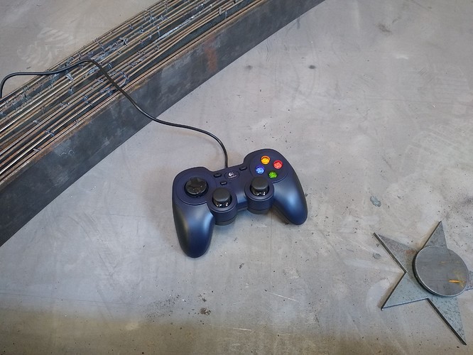

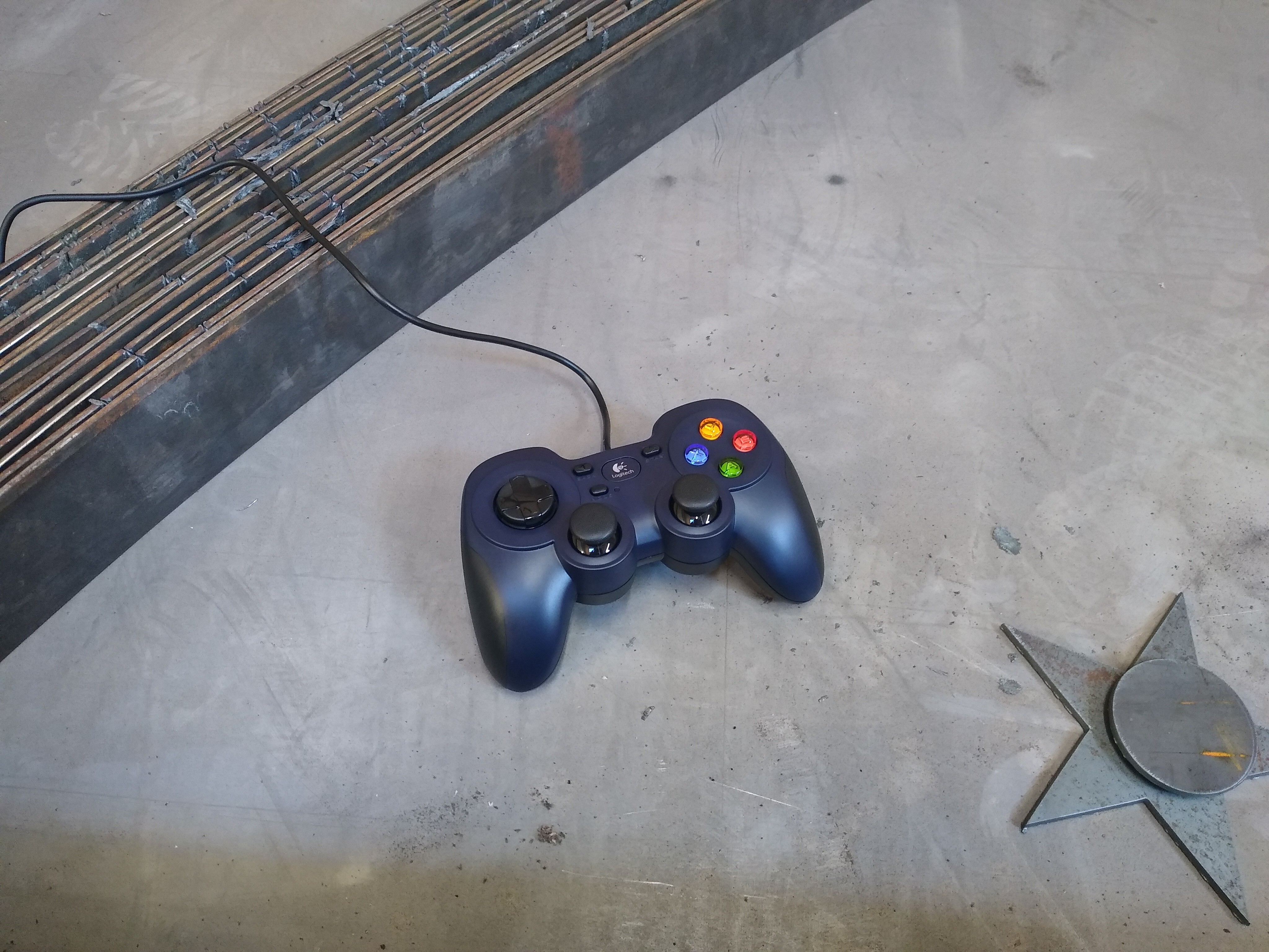

After $14.99 and quite a few expletives I’ve got a working remote pendant! This thing will probably need a write up of it’s own, in the end it’s pretty simple to setup I just made things hard on myself.
Sorry for no video, in it’s current configuration it requires two thumbs to jog the gantry and I didn’t have enough hands for jogging + holding the phone
