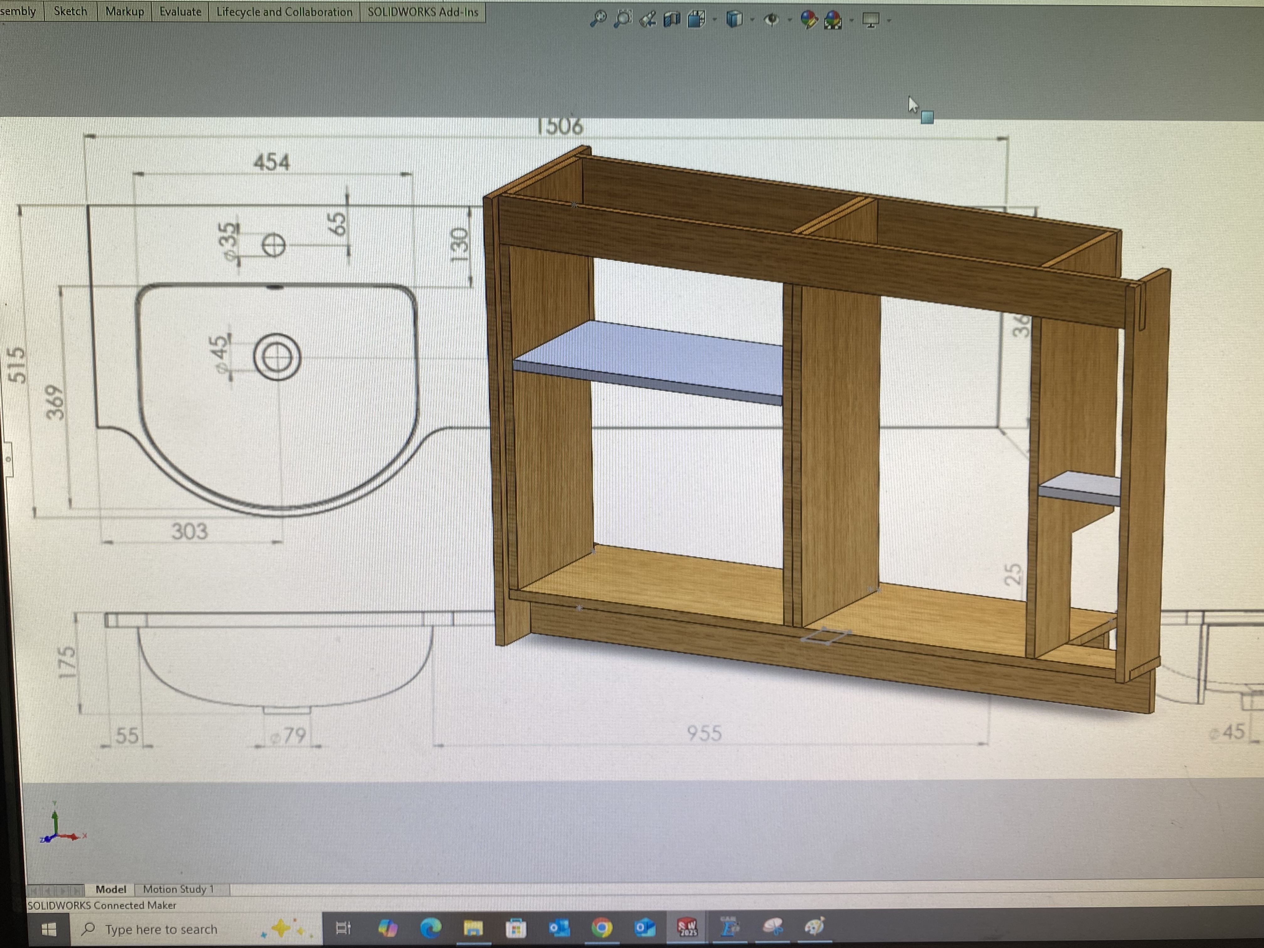

The pressing project for this build is a vanity unit for the bathroom I am renovating in the house. Nothing off the shelf fits, so I have designed my own ikea style unit, and will be using recycled Ikea Pax Wardobe sides as it’s hands down the cheapest way to get faced chipboard - light oak veneer in this case. Less than £20 for all I need for this, and probably enough to do the bath surround too!
(Sink, doors and toilet not modelled, but the end result will hopefully look like this)

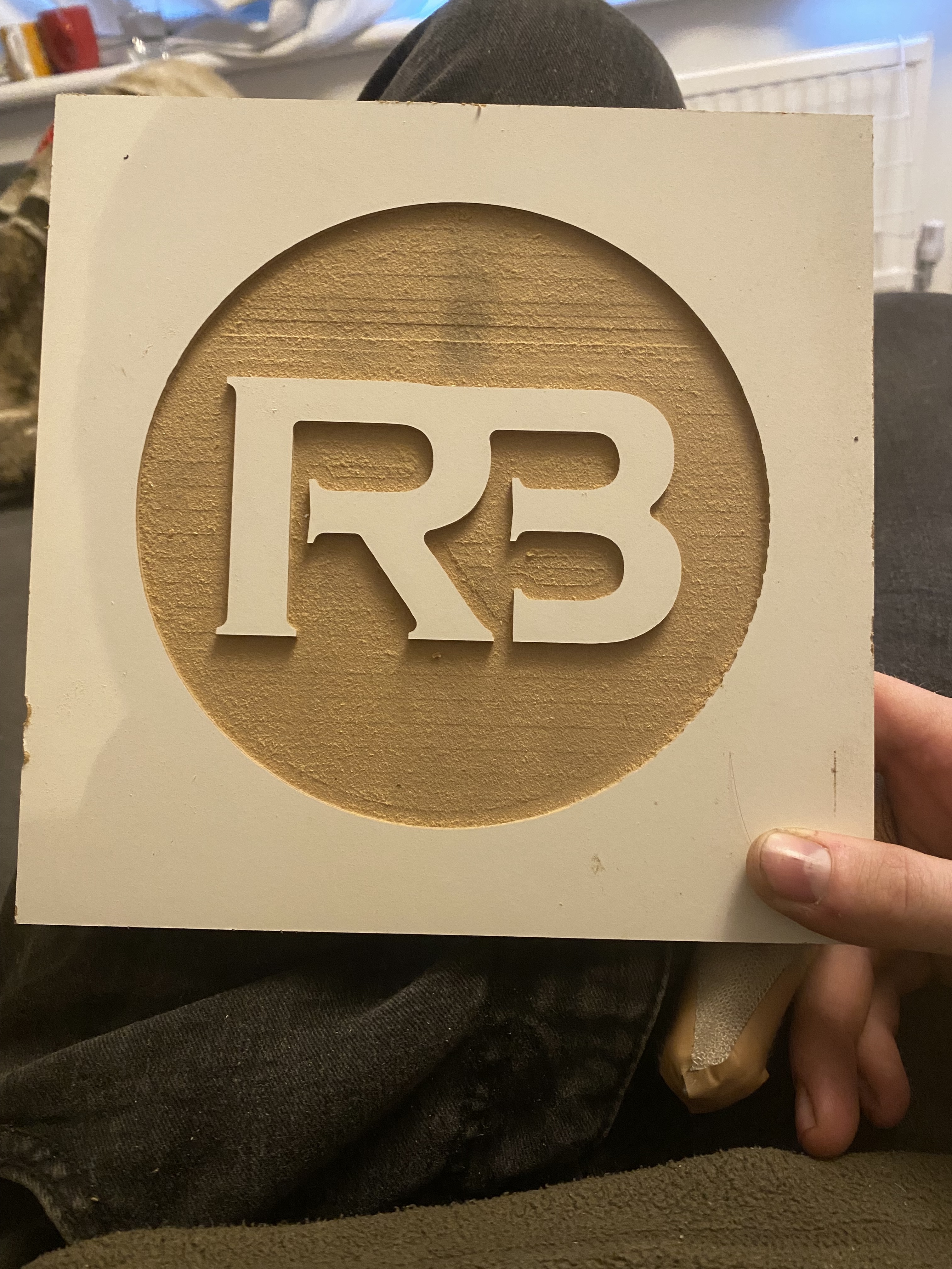

200mm square, parted with tabs. 2flute up upcut, 3.95mm dia
150mm pocketed circle. 2flute downcut, 3.9mm dia
Different bits as trying to learn about how they affect tear out of the facing. Looking at the the pocket though I think I haven’t got the step over set right as have wide lining
The square comes out 1.6mm (.8%) under in X, and 1.8mm (0.9%) under in Y
Circle comes out 0.5mm (.3%) under in x, 0.8mm (.5%) under in Y
Concerned that the deltas arent constant but I am also not sure I have the workflow right for the finishing pass?
But based on the above how should I move forward? Is this primarily a belt tension issue ? I know grub screws are first thing, but they are loctited to the moon and back so confident they are not the issue. Or do I need to adjust steps per mm? If so is there a step by step walkthrough for this?
