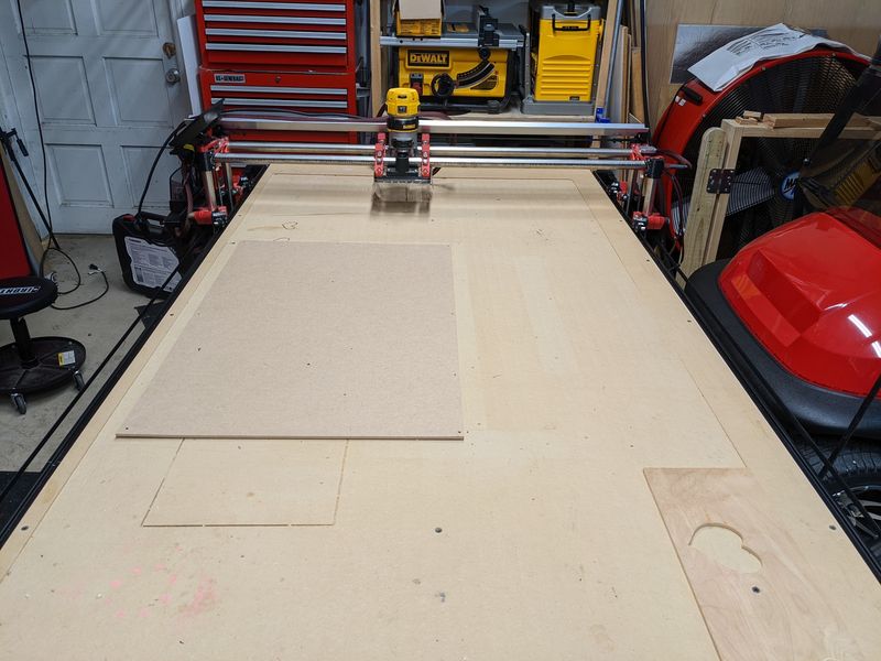

Somebody JUST posted a picture of his build like this on the Facebook group. Looks like 20x40.
I don’t know that THAT is where you lose rigidity, though. I’m sure it would help with tracking straight if that becomes a problem, but plenty of LRs run just fine.
Sure does LOOK cool.
