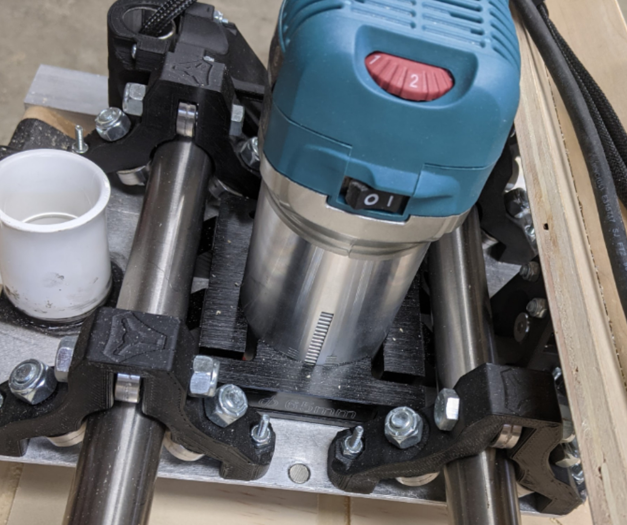

I am using one of these for my Makita router for multiple reasons which I won’t go into here.
It’s very tight but works. I had to make my 611 plate wider so my dust shoe would fit but without a dust shoe you might just need to drill new holes.
