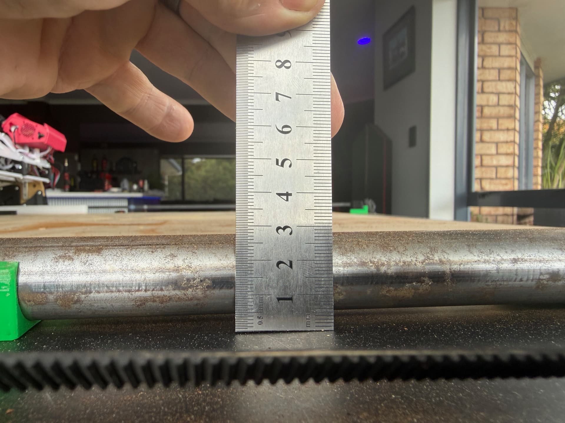

Pipe is 25.3 OD according to my callipers

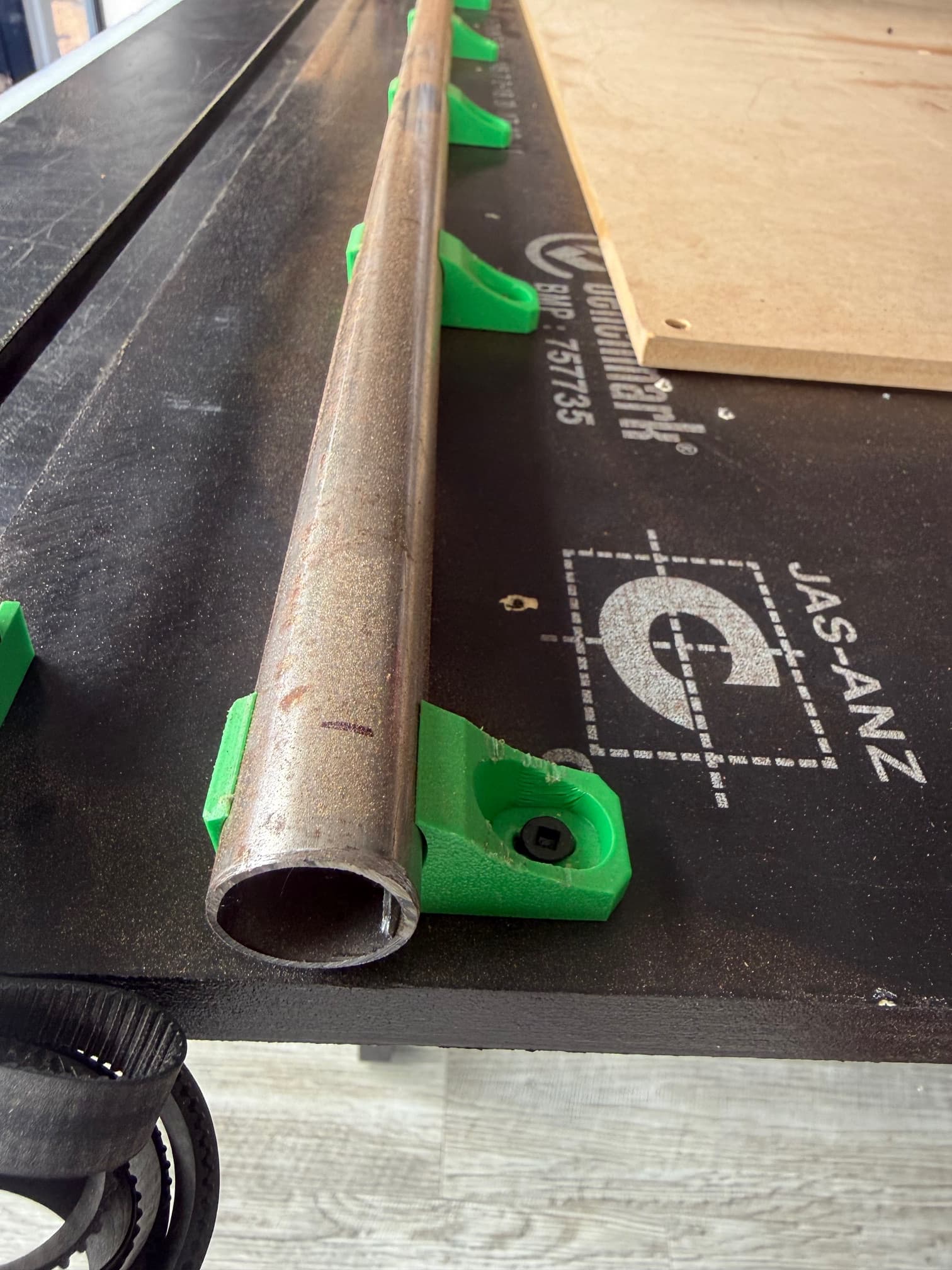

Thanks for the pic and dia info.
Please share pic that helps us guess approx clearance between bottom of pipe and the table. Am trying to understand if Y clips are too thick (to help make cleaning easier, but are skewing your Z).

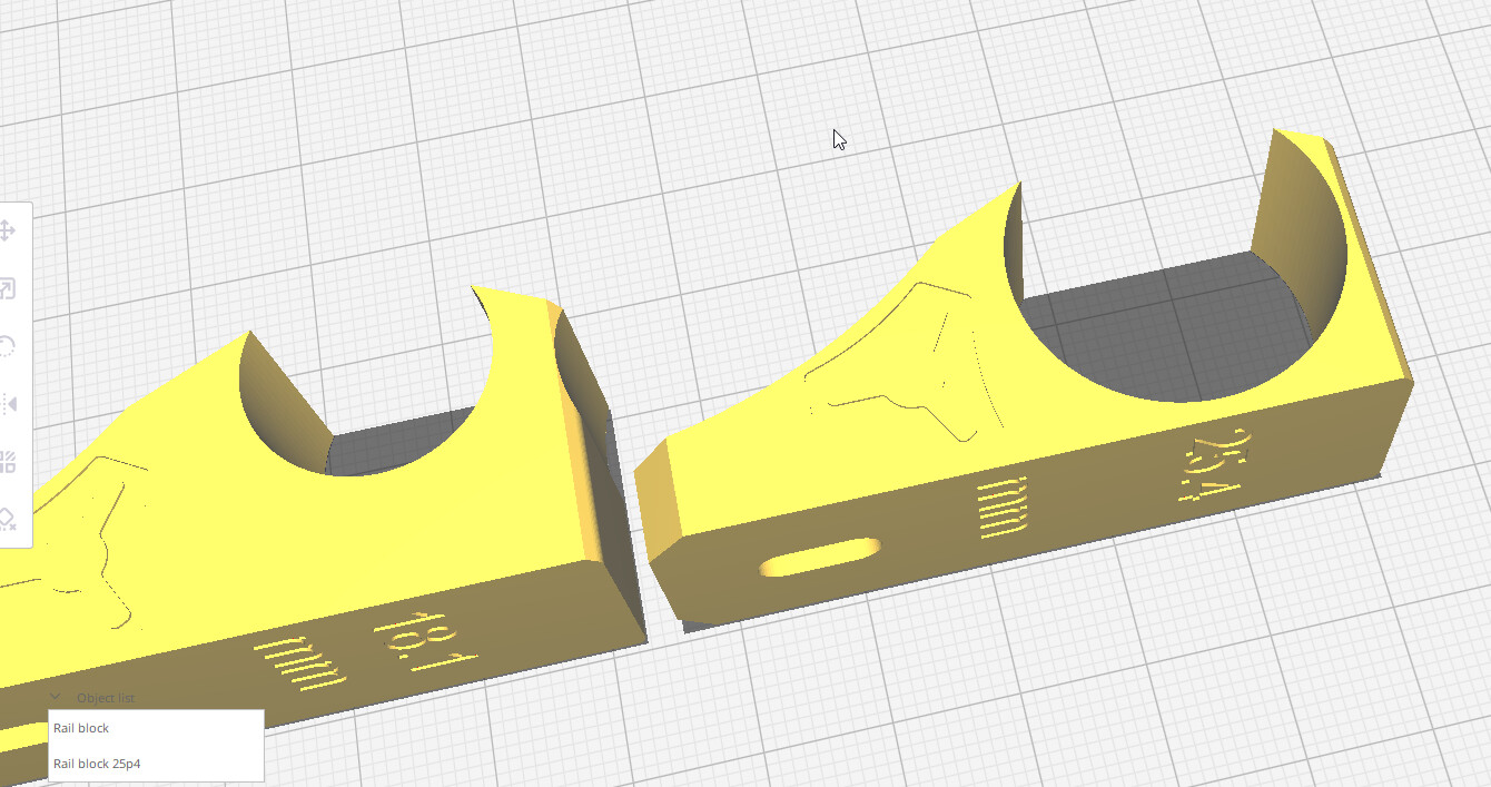

Y Clips Close up
Great, they look like stock Y Clips (Rail block 25p4) to me.

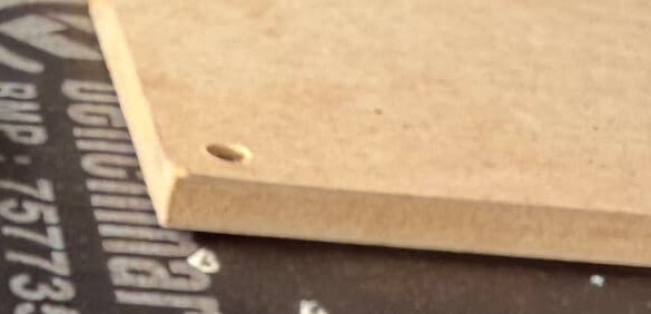

Unrelated, but spoil board’s lifting a bit.
