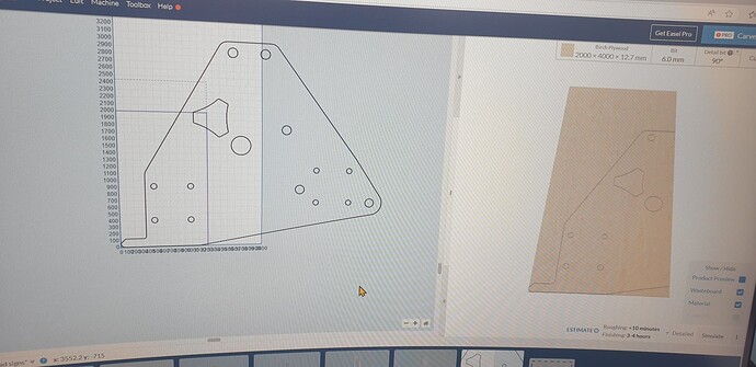

Im slowly printing all the files, think the old ender 3 is on her last legs. Trying to work out the aluminum plates, i would just order but by the time they get here its about $170… does anyone have the file so i can cut out the plates myself. I have dxf files but the size is off, and cant find what size the plate should be, or what size bit to use…

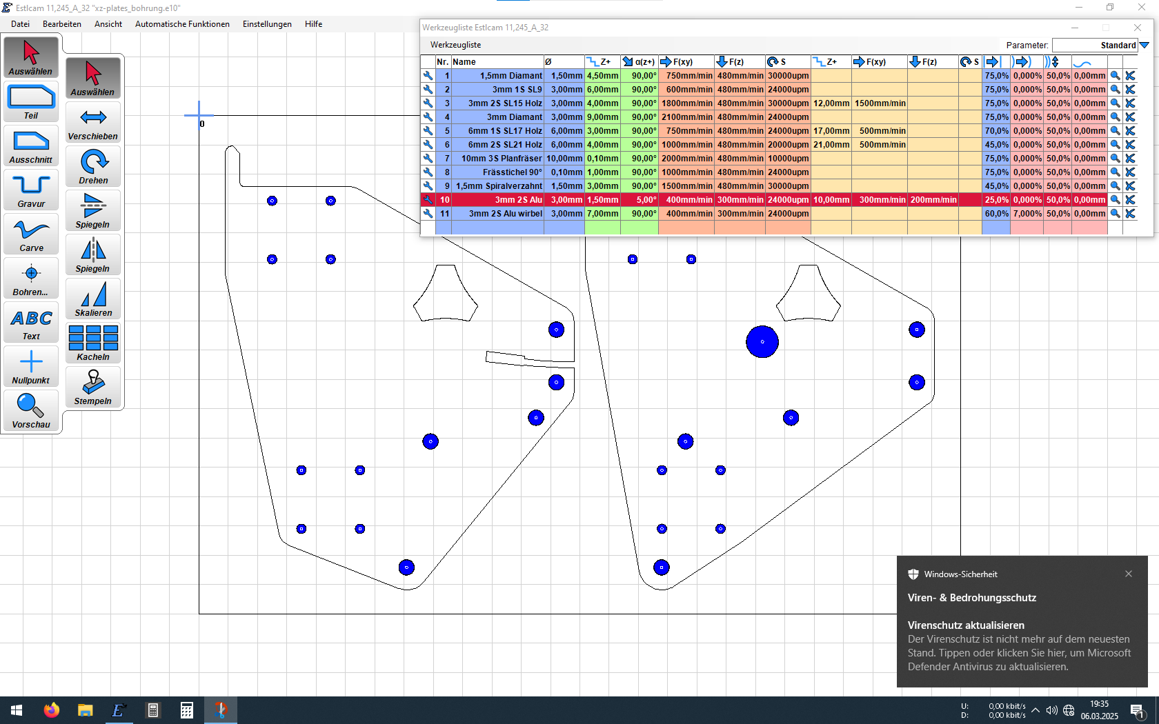

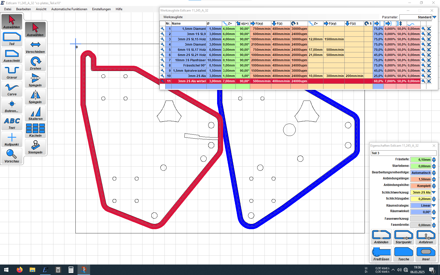

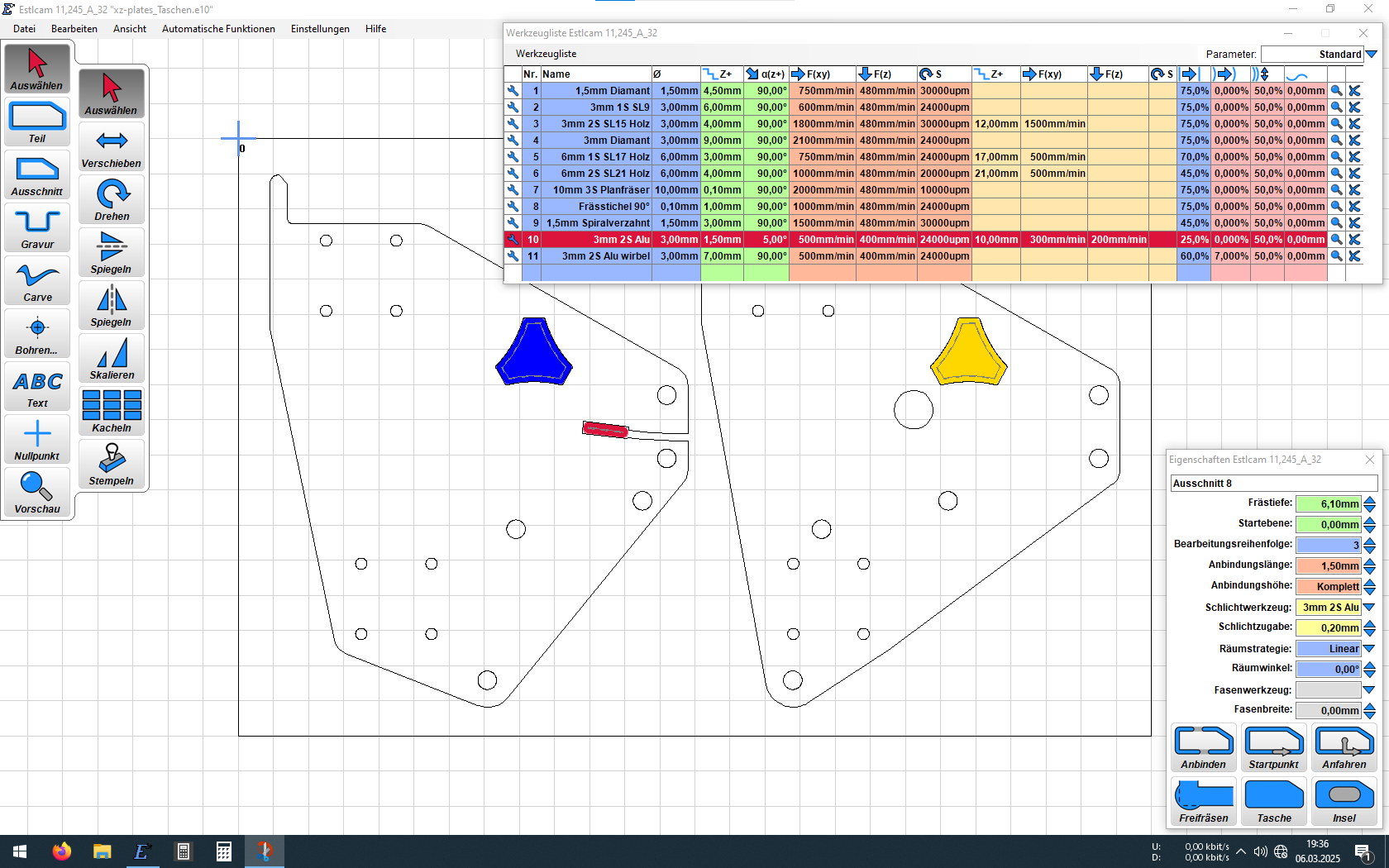

Sorry for the late reply, but here are the screenshots of my three steps on the xy-plates with my speeds and feeds.
Thankyou so much…
