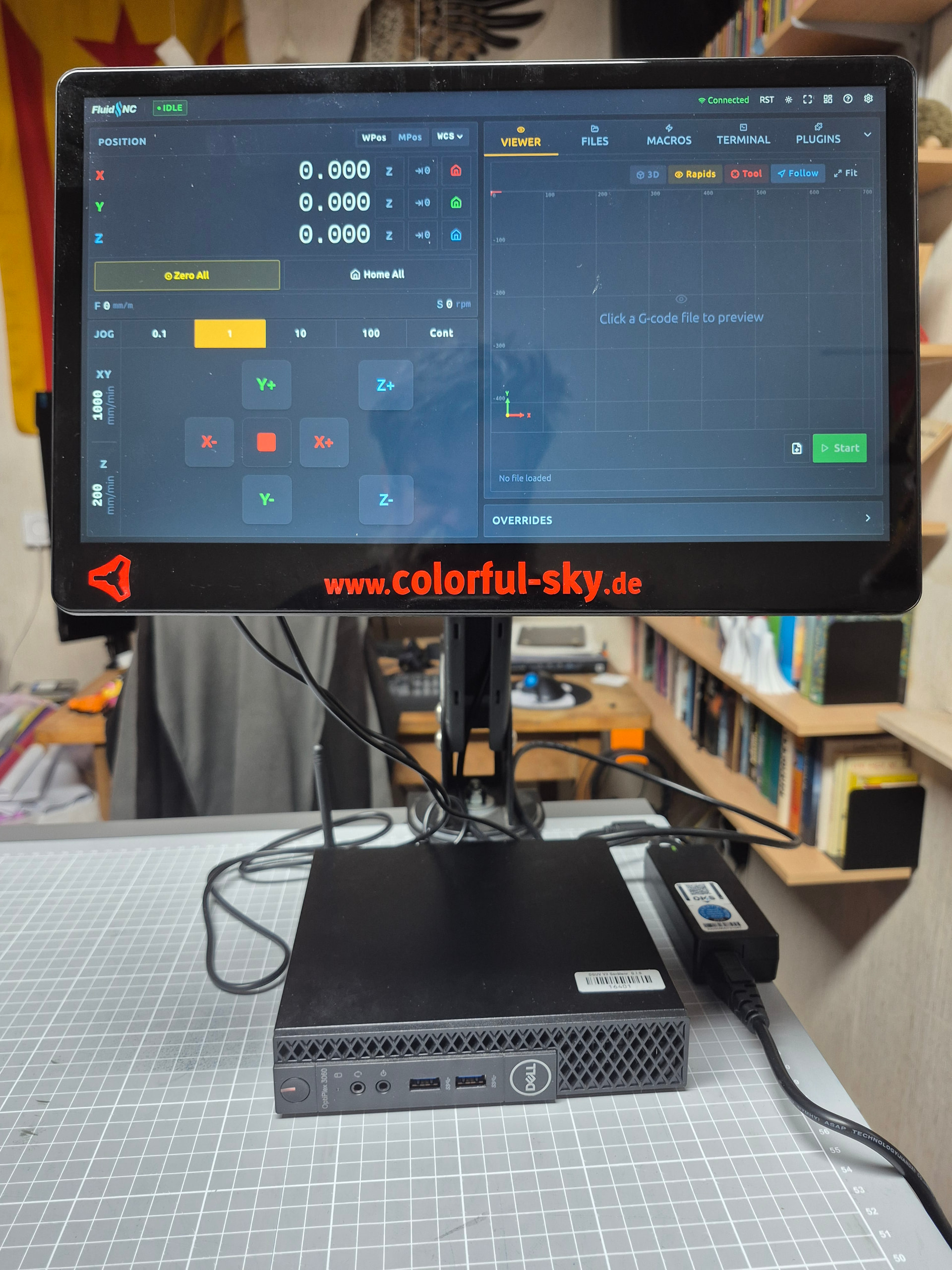

But I was in the mood to do something for my Lowraider. I sourced a touchscreen (13,3 Zoll, FHD 1920×1080) on amazon. And I got me an old computer from work. They don’t have to pay for the recycling, and I get a computer for free.
With Ubuntu on it, autologin for an unprivileged user, and autostart of chromium into fullscreen, this gives a nice console for my Lowrider. FigUI looks great (demo mode in the image, bit it works on my Lowrider too).

I’m thinking about changing the monitor arm. The one in use is one I borrowed from the office. I may print something smaller for the small monitor.

I tried first with an old laptop to. But I didn’t like the feel of using a touchpad and keyboard. I have a very similar construction with a touchscreen for my old 3D printer, and I love a touchscreen for maschine control. It just feels so natural.
If I hadn’t the opportunity to source an old pc for free, I would have stayed with the old laptop! But rescuing the computer from the landfill and giving it a second live seams a good idea to me.

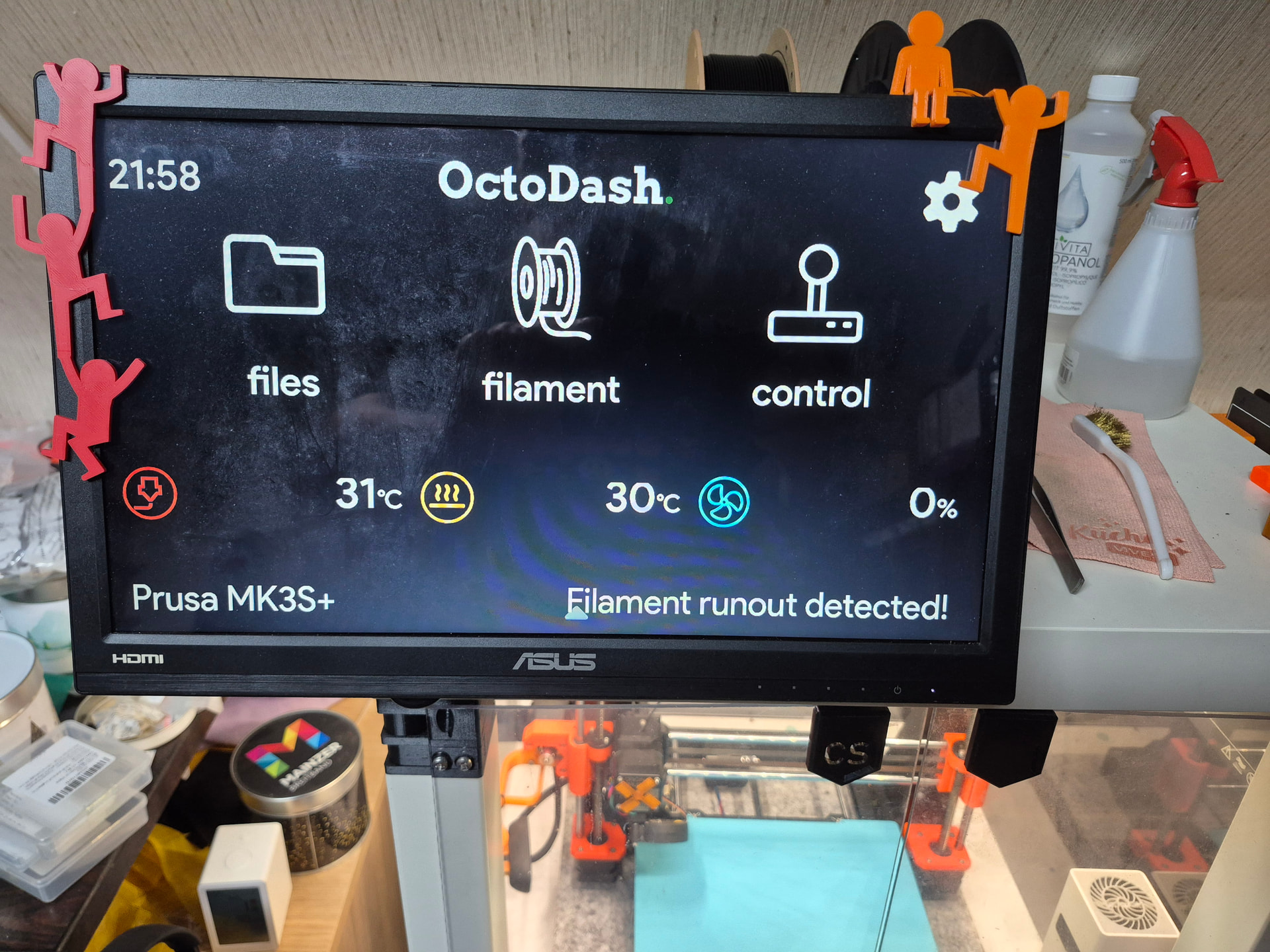

This is the console for my 3D-Printer:
-oO(Yeah, my man cave just looks a bit like a mess!)
This OctoDash, and AddOn for OctoPrint an Raspberry Pi 4B.
Yeah, it’s a bit of an overkill sizewise of the screen, but my eyes getting older and my finger thicker.
And yes, it’s really and old Prusa MK3S+, and I printed all parts for the Lowrider with it. It’s still a very reliable printer.

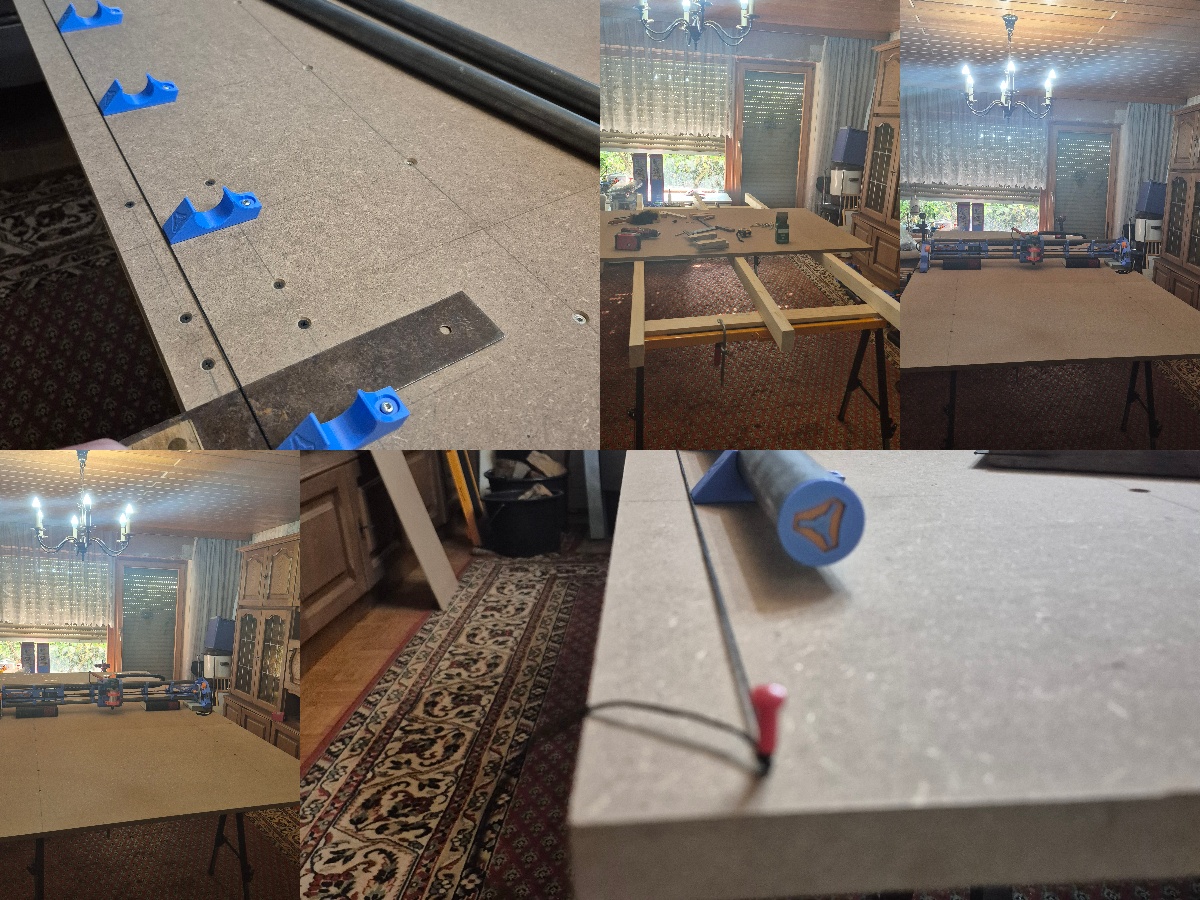

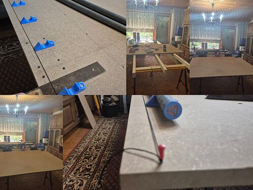

Time for some news from my build! I found someone with a pickup truck, who brought my wood to my home. Finaly, the build could go on.
Now is stop again, I used the last screw. I will buy some new ones tomorrow.
Here some impressions from my build until now:
(Don’t look at the interior design, it’s my parents old living room! :laughing:)
I don’t think, this is the last table I will build for the lowrider. But it will do for the first steps.
The only thing I don’t like is: I had to use 3 boards for the table top, and 2 tubes for the railing. And there are some minimal jerks, when the gantry is crossing the connection points. But I believe, this will be no problem! fingers crossed
