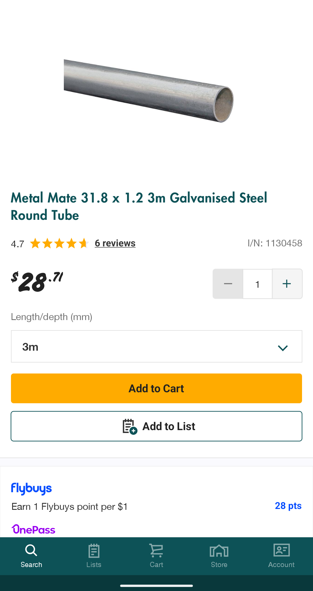

Hey guys I’m about to start my first lowrider build, but I’m having trouble finding the right sized rails. Will these ones be acceptable? They are galvanised and I’m not sure if that will lead to inconsistencies across the tubing. Has anyone else in Australia have any recommendations on steel tubing/where you got some from? Any advice is greatly appreciated

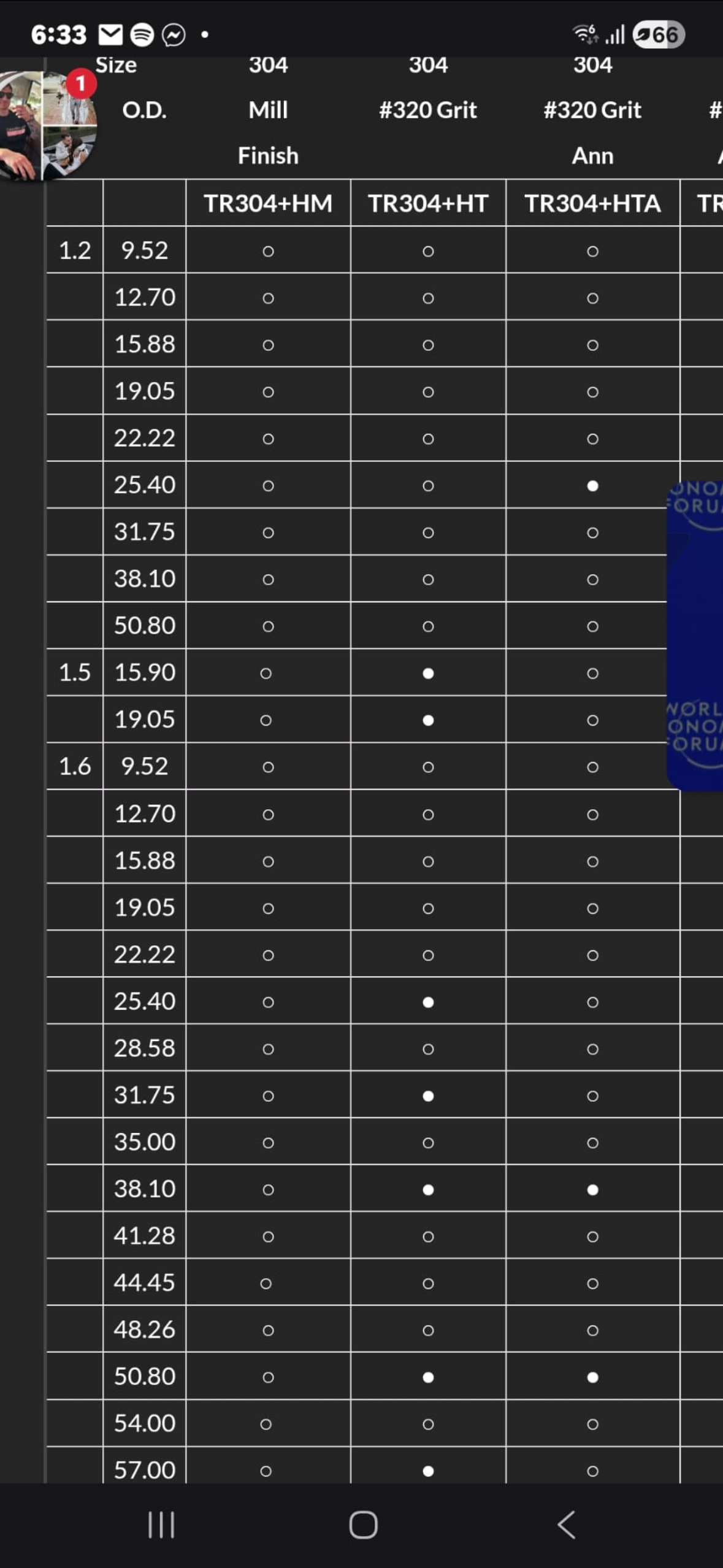

I’ve recently built a LR4 in Melbourne. I used this tube for my rails:
With the bunnings stuff, I wouldn’t be too concerned about the gal as it’s generally electro galvanised rather than hot dip, so the surface finish is much more uniform. The main reason I decided against it was because I thought the wall section was a bit light.

Yeah it’s Bronte baths from when I went to Sydney, I’m from WA and that was while I was doing some travel in my gap year. I think I’m just going to get the Bunnings one even though it’s a little thin and see how it turns out. If it doesn’t I’ll have to order the ones you linked from tube supplies and fork out some cash for shipping ![]()

I’ve just ordered everything I need from v1, should hopefully get here in about a week. Once it arrives I’ll just go for the Bunnings one and see how it turns out

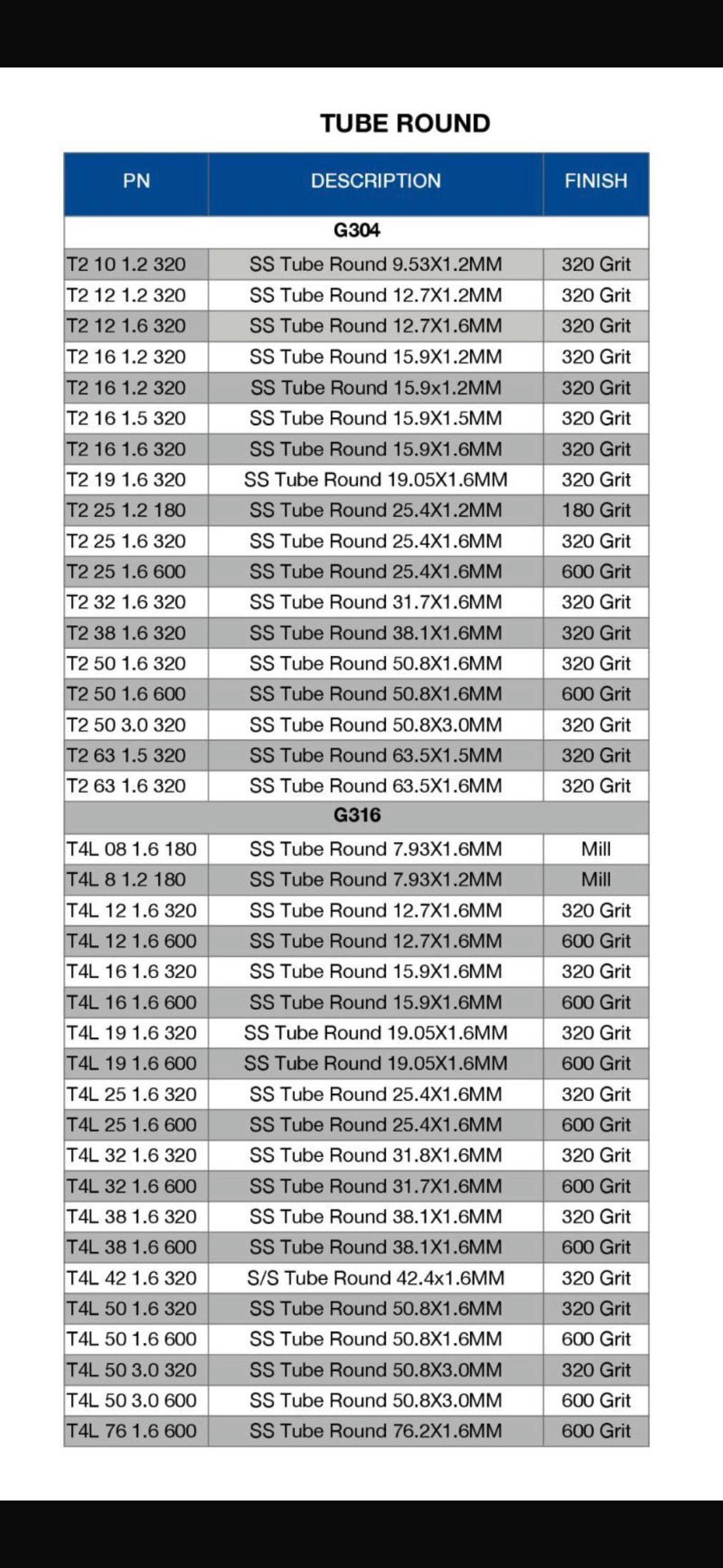

Hey mate, I am also in Perth WA.
Stirling Metals in Bibra Lake will have all of these listed stainless steel tubes in stock.

Hey mate - This is what I used - https://tle.mmem.com.au/wmi32vhd - pretty happy with it (fits the 32mm printed parts no issue.

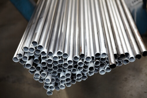

I see this is resolved, but I just thought I’d put you at ease by saying I used the bunnings galv for both my v3 and v4 builds and got much better accuracy with my parts than I ever expected. Steel tube sometimes has a rough part, just turn that away from the bearings. Same goes for any inperfections on the tube.
