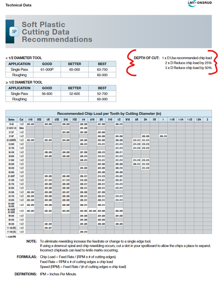

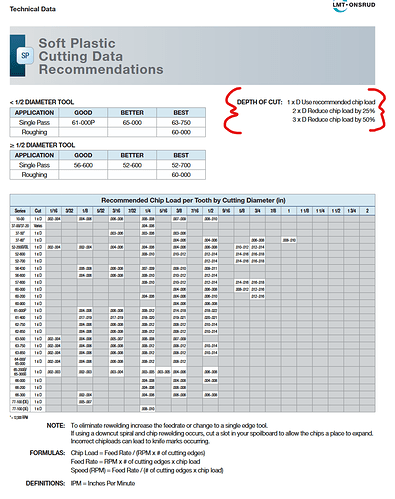

See the part highlighted in red. The chipload they give you is for 1diamter depth of cut. Now if you cut 3 times deeper you only need to slow down half the speed. 3x 1/2= 1 1/2. So slower and deeper equals 1.5x faster.

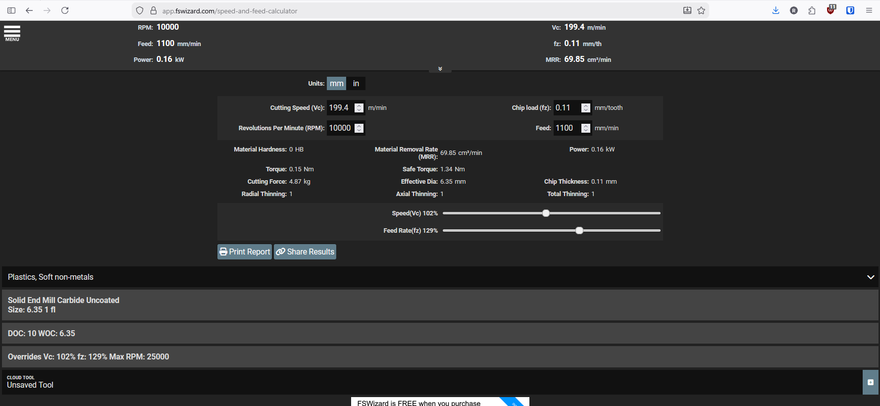

I threw all that into the calc,
This assumes a 1/4" single flute upcut slotting. Correct chip load (lower end), 10k rpm, 10mm DOC, 18mm/s.
What you need to keep an eye on the most is that cutting force. The LR is designed for about 9lbs/4kg. This is a bit high, so maybe a slightly shallower or slower cut, but I think this would work fine for most builds. The MRR, is the gauge on how fast you are actually cutting, same diameter bits will let you compare directly.
These numbers are very far off from what you are showing so I am assuming you are cutting super shallow. Shallow cuts wear out the tip of your endmill and waste the rest, and deeper cuts remove more material. Go as deep as you can while still being able to remove the material out of the slot.
