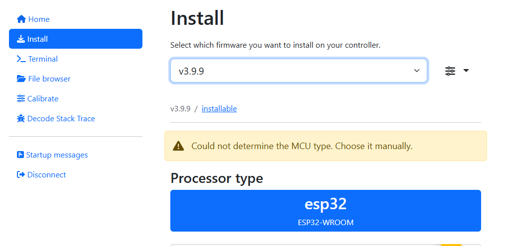

I have the jckpot controller. havent used it in a while. just relocated it and fire it up but got this. jot sure what it means.
**Config File Error
Fix it or FluidNC will not work**
MSG:ERR: Showing startup log from previous panic
MSG:INFO: FluidNC v3.9.1 https://github.com/bdring/FluidNC
MSG:INFO: Compiled with ESP32 SDK:v4.4.7-dirty
MSG:INFO: Local filesystem type is littlefs
MSG:INFO: Configuration file:config.yaml
MSG:INFO: Machine LowRider
MSG:INFO: Board Jackpot TMC2209
MSG:INFO: UART1 Tx:gpio.0 Rx:gpio.4 RTS:NO_PIN Baud:115200

MSG:INFO: Probe gpio.36:low
when I clear the alarm. the machine will say idle, then when i try to jog the machine it gives code like its moving but dosnt move. it wont home either. here is the code it gave me on start up. any help would be awsome thanks.

The recommended version of Fluidnc now is 3.9.9. I would update to that.
Try typing $X in the terminal window.

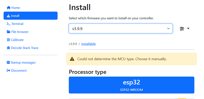

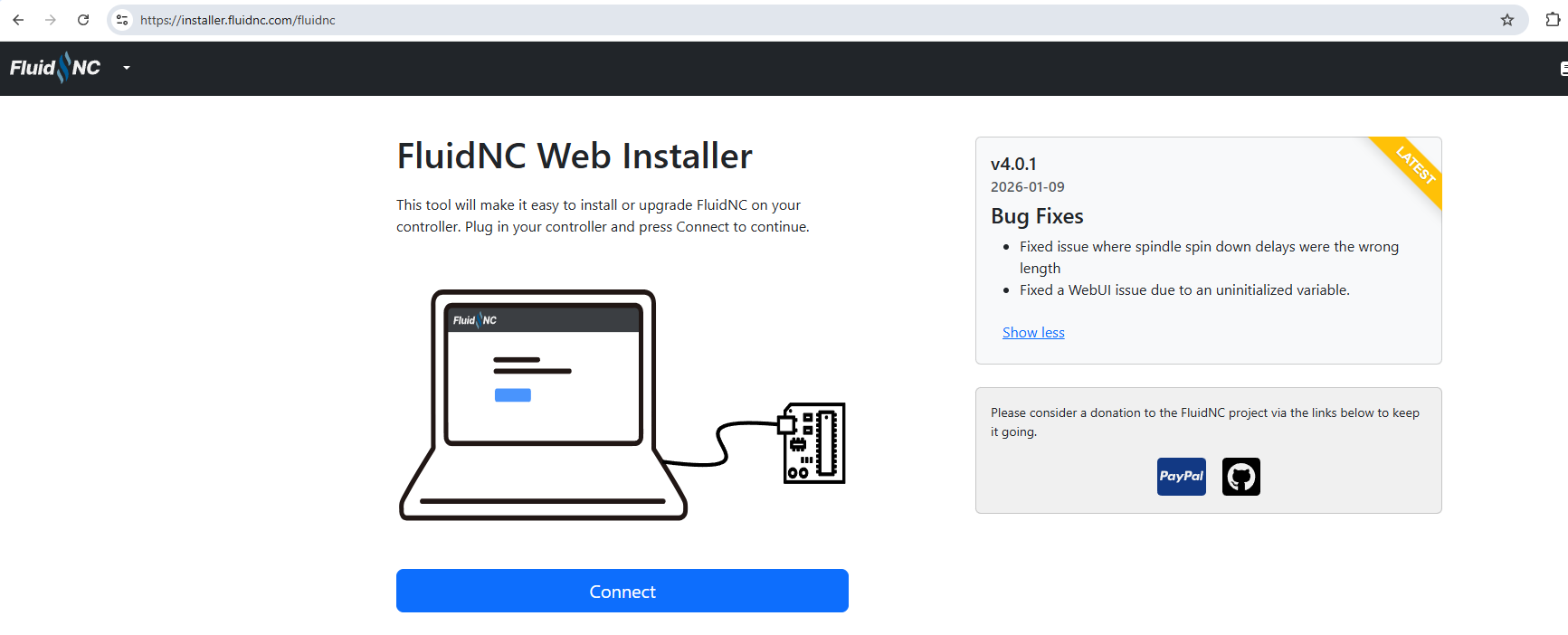

thanks for the reply should i upgrade to the V4.0.1. showed it in the pic
No, 4.0 is still stabilizing. Stick with 3.9.9. It lets you select the version to install.
copy thanks. I need to find a data port mini usb. i think the one i have only does pwr. on the hunt threw the house.

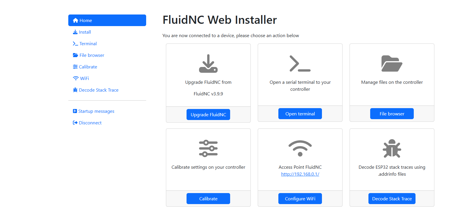

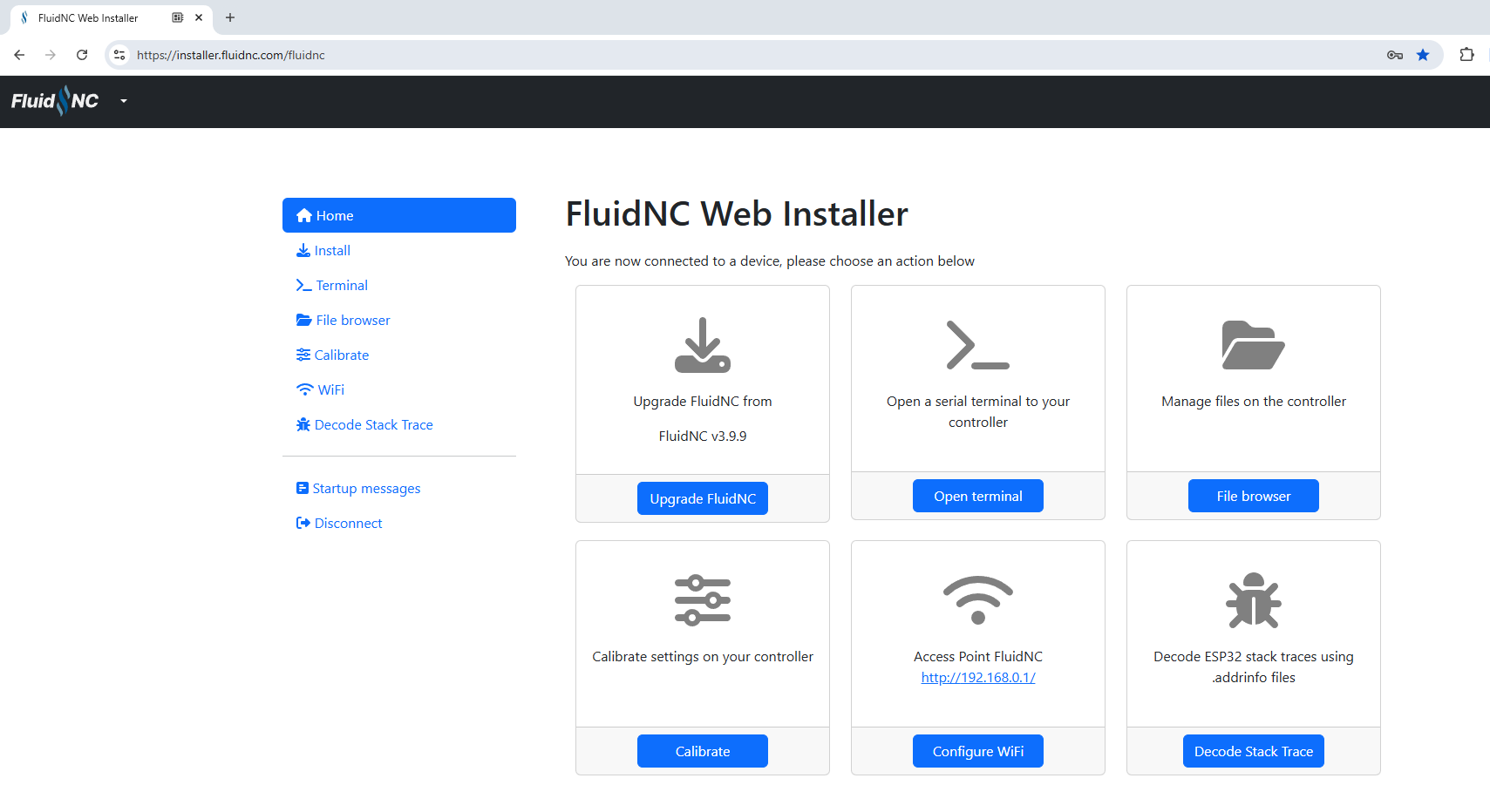

got 3.9.9 installed did fresh install.

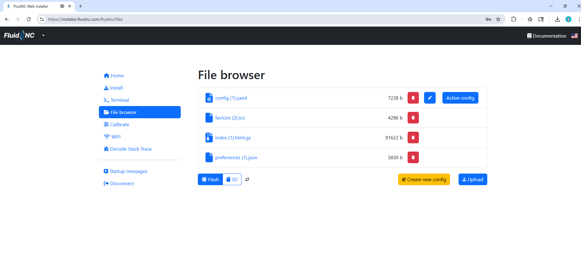

when i open file browser this is what i have.

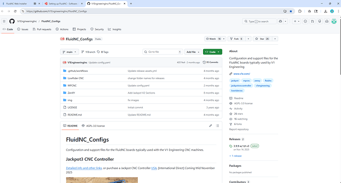

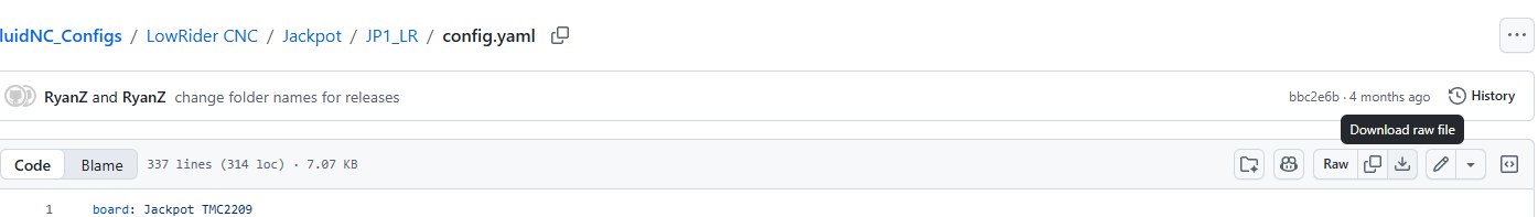

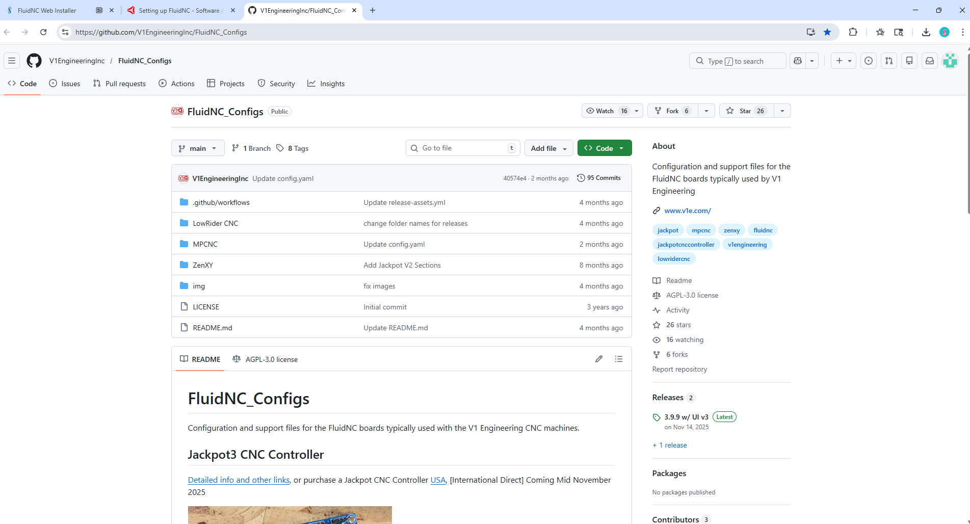

I was folowing the fluidnc set up directions and went to the download it from github link but dont know what to pick or if i have to. this is the screen shot of i get when i hit the link.
not sure what to dnload or how from here, or if i need to
heres the link it sent me to GitHub - V1EngineeringInc/FluidNC_Configs: Configuration and support files for the FluidNC boards typically used by V1 Engineering · GitHub
i have the jackpot 1 not suer if that matters
Download the files from here for a Jackpot 1 and a Lowrider:
FluidNC_Configs/LowRider CNC/Jackpot/JP1_LR at main · V1EngineeringInc/FluidNC_Configs
You’ll have to click on each file and then download them using the download link on the right.

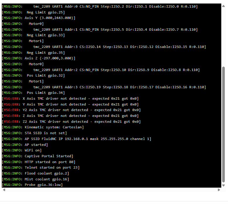

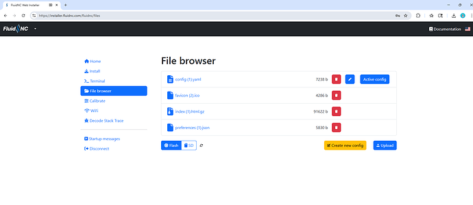

found got them loaded. this is what it looks like now.
here is my home page

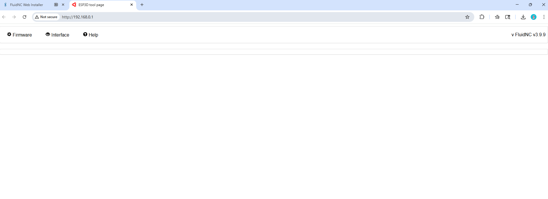

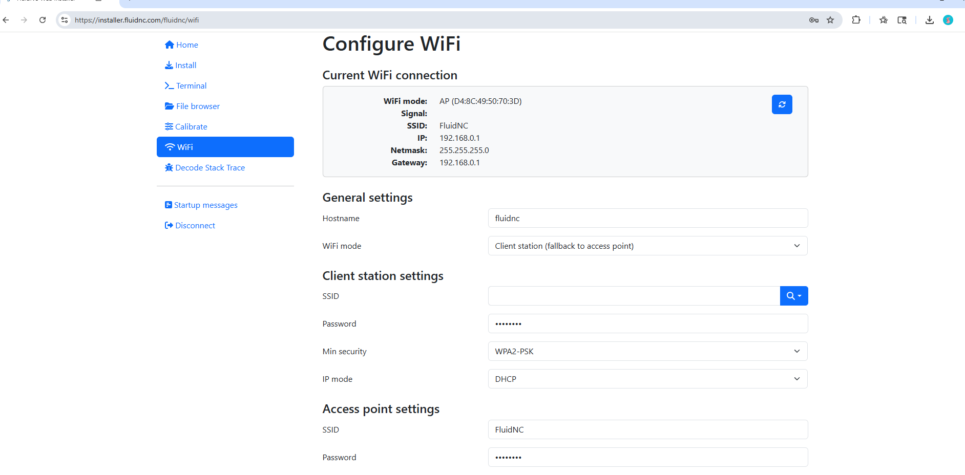

when I go to my acces point this what it looks like. I dont have it hooked up to the machine though.
it dosnt show the controls, not sure what i did wrong here is a pic of my config wifi

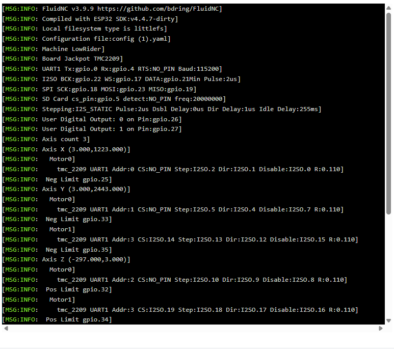

here is my startup code
You need to get rid of the (1) and (2) in the filenames. The filenames must be what they are in the repo.
that worked. going to install and try it out thanks
