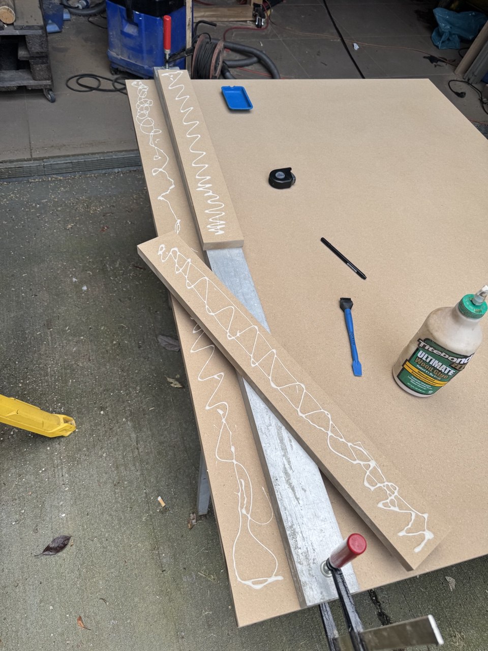

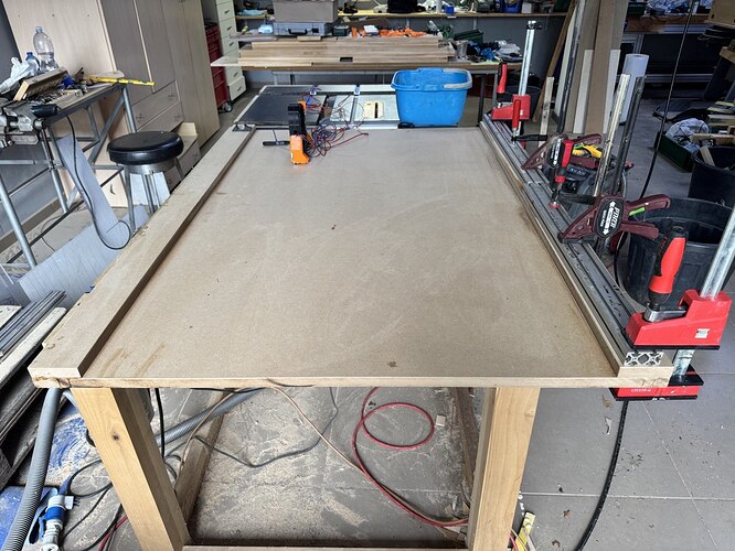

I assembled all the parts and glued the table today.

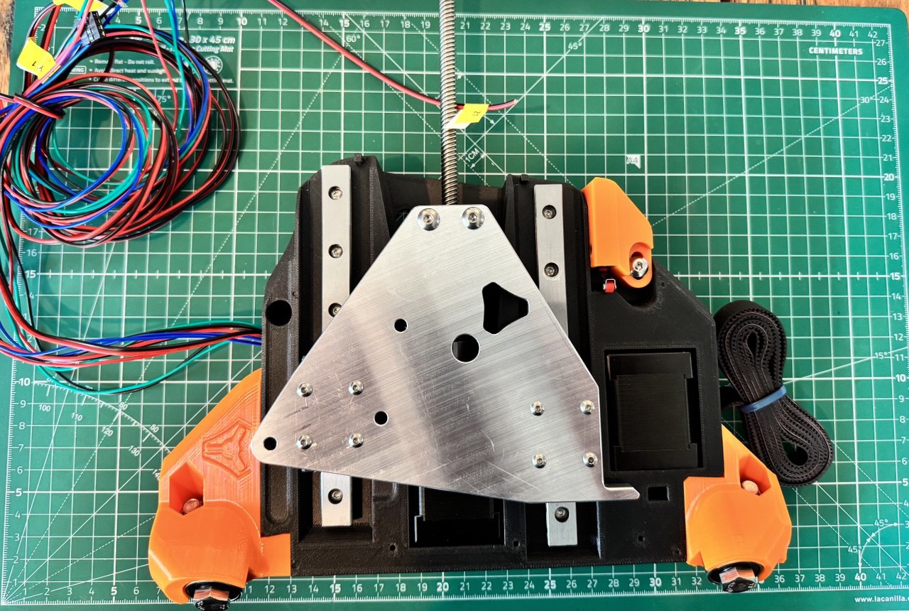

Today we start with the Beam assembly.
And these finally ended. :champagne:

Did you mill your own plates or get them from Ryan?
I had them made by the machine tool department in the company where I work.

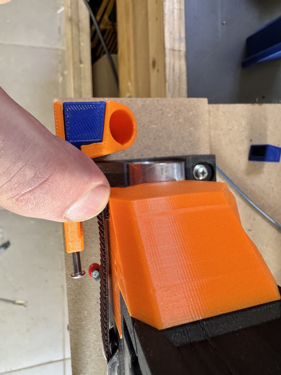

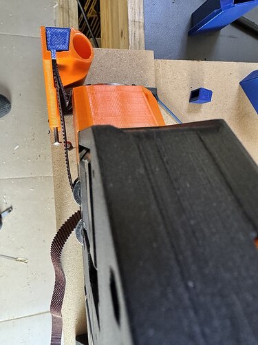

Hi guys from northern italy,
after days between rain and sun spent fixing my vegetable garden, now I have finished transplanting the strawberries, now I resume assembly.
Issue:
32 mm rod with its supports. i mount Ymax but the screw does not go to the endstop.
What did I do wrong? :sob: :sob: :sob:
Beppe
Can you not move the Ymax belt holder towards the rail? It looks like the current position will pull the belt “outwards” which can’t be good? I’m still not sure what the relative placement of the belt holders “should be”. I probably missed something
Sorry everyone and I take a bow,
I just saw the youtube video of @francosmith9, I am ashamed of myself…
I had to move the tube stand further forward.
Might want to go back to working in the garden and drink less prosecco.
