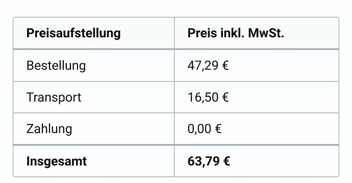

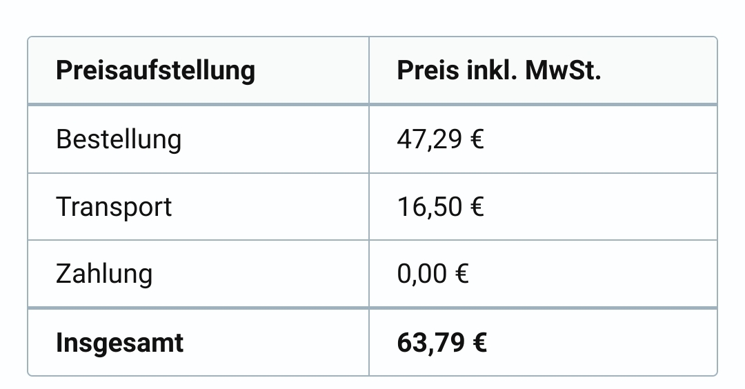

Phew, that’s only 30mm and a lot more expensive…
Gemme 4x 1500x30x2:
Preis Brutto 107,10 €

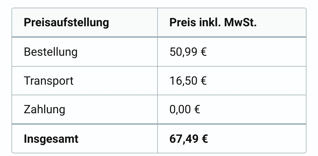

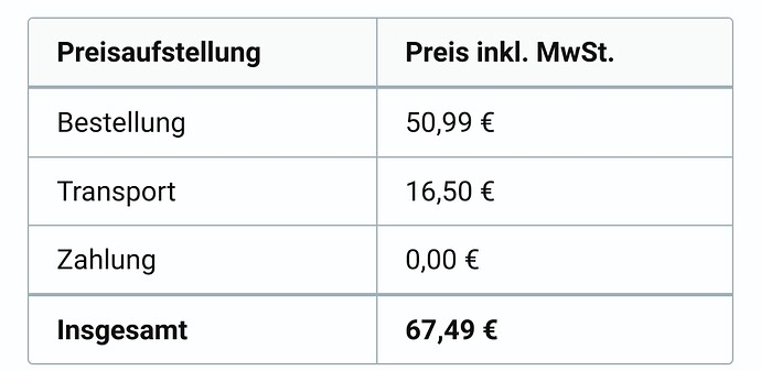

Jabimetal 4x 1500x30x2
Jabimetal 4x 1500x32x2
I am not sure whether gemme had the shipping included in the price.
Then Jabimetal is the significantly better source; the price at Gemmel for 4x 1500 30x2 is 152.25€ including shipping.

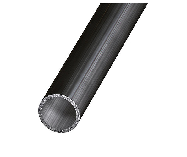

30mm steel tube source for France
This store is part of the “Kingfisher” consortium, so you may be able to find similar products in other stores like screwfix or b&q

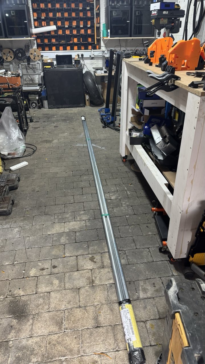

My tubes arrived today.
