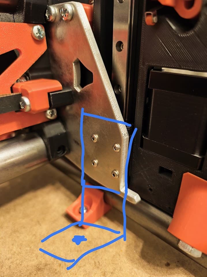

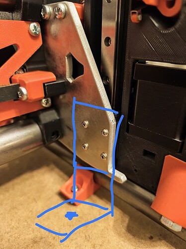

i built my first LR4 with smalest table 800x700mm (working space 310x480).
my aim is exactly to have smallest possible form-factor table which i can store vertically (or flipped) when not used. the best of course is that those fix-brackets are not getting out of the table surface.
Have anyone done something like that?
My todos:
  1. evaluate best options of brackets to fix the Core to the table
  2. find or create bracket’s 3d models
  3. try and adapt
I would take the LR4 off of the table for storage. It is simple to release the 2 Y belts and lift it off the table.
seams i am on solution already - core aluminium plates looks solid. so i just need to add 3d printed small platform and longer connecting screws. than vertical M6 can be screwed to the table directly (where wisher is incorporated from the bottom)

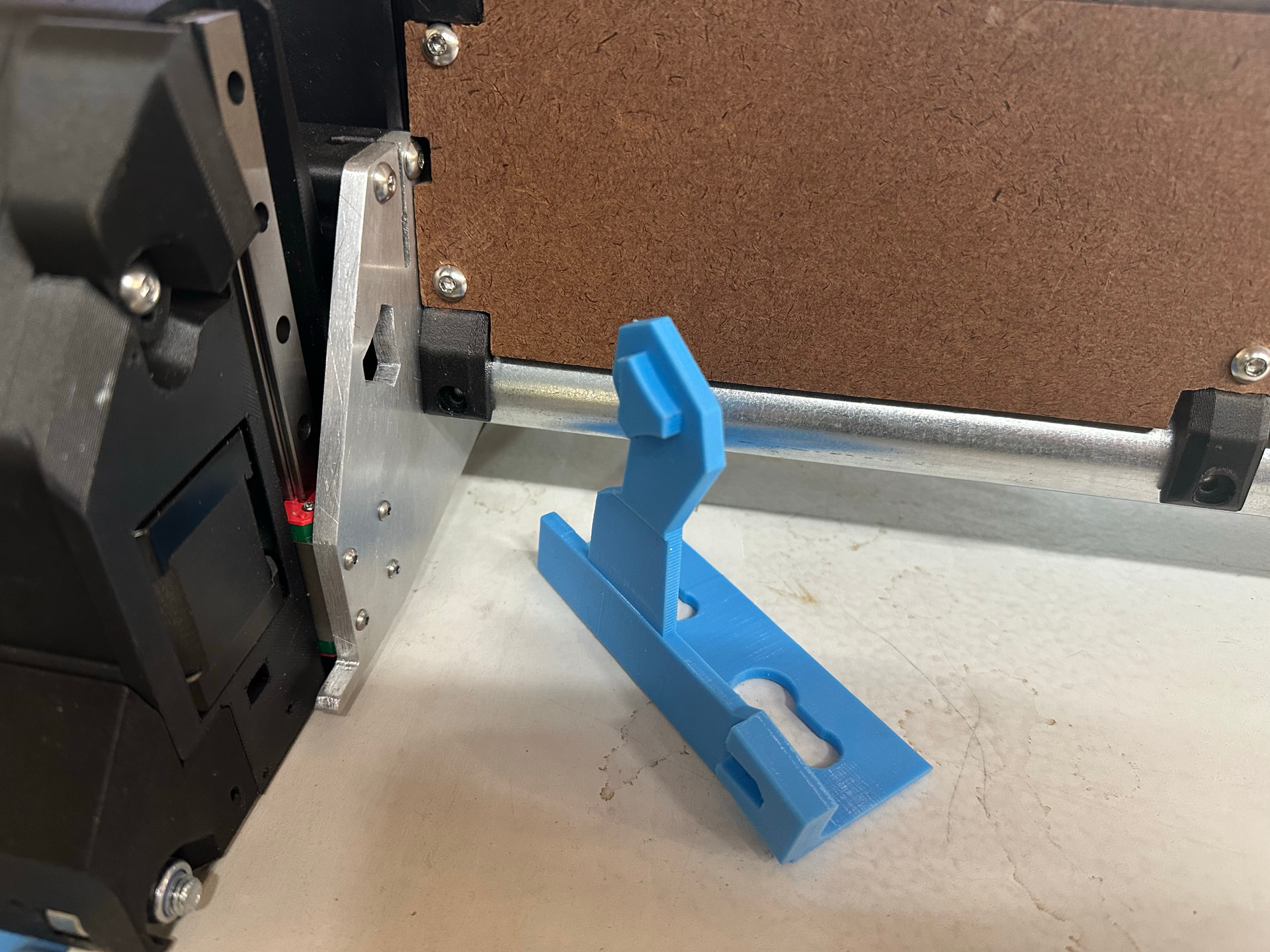

Made this bracket should work fine:
Hi there. How did the bracket work out? Love the idea. Is there a file to it so I can print them as well? Thanks
With my flip table I built ‘Z’ shaped brackets out of wood. One end of the brackets hooks around table edge. A flat piece of wood lays on table and slides under gantry beam and then a upright piece hooks the back of the gantry. Seems to work. I look for picture of it.
I seen someone posted a Pic of theirs where they just used a nylon strap from the the table edge to under then over the gantry and back to the tables edge. Seems even easier.
It’s working well.. just takes a couple seconds to clip it on. I posted it here for you:
Low Rider V4 Vertical Storage Bracket - Free 3D Print Model - MakerWorld
