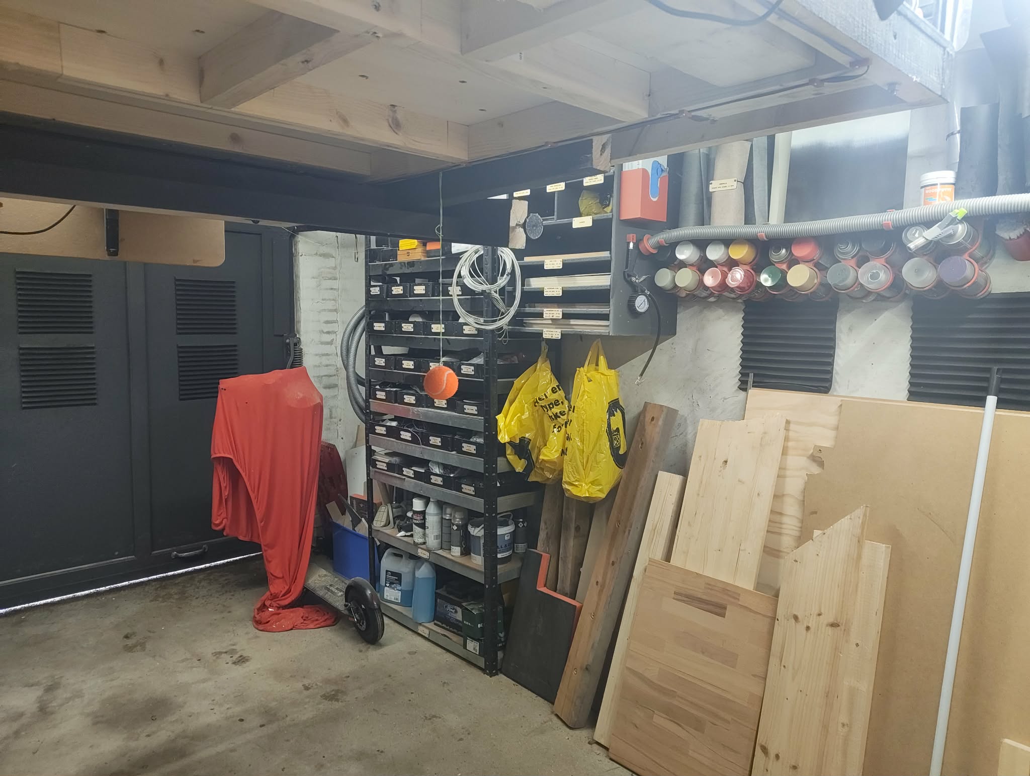

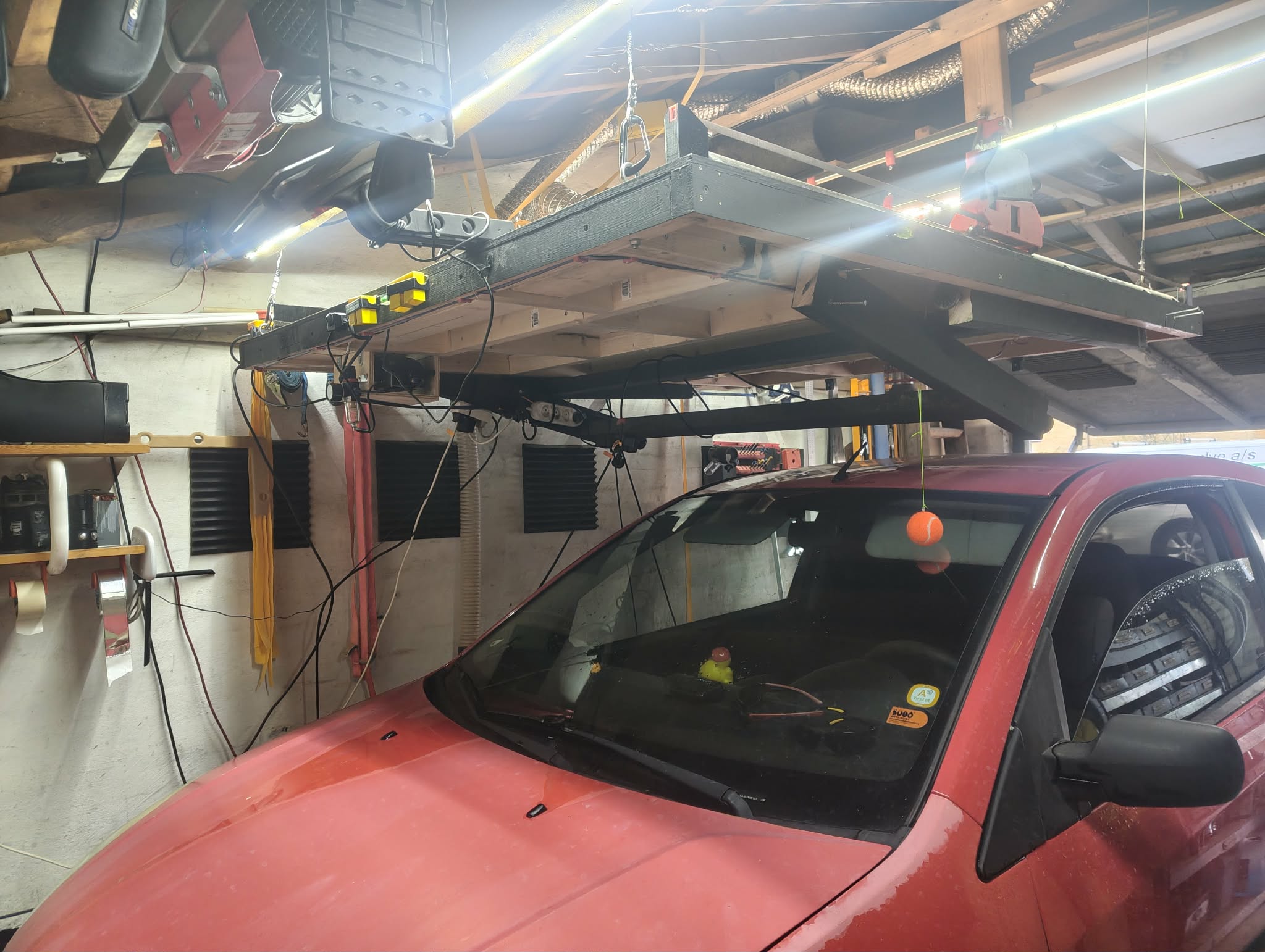

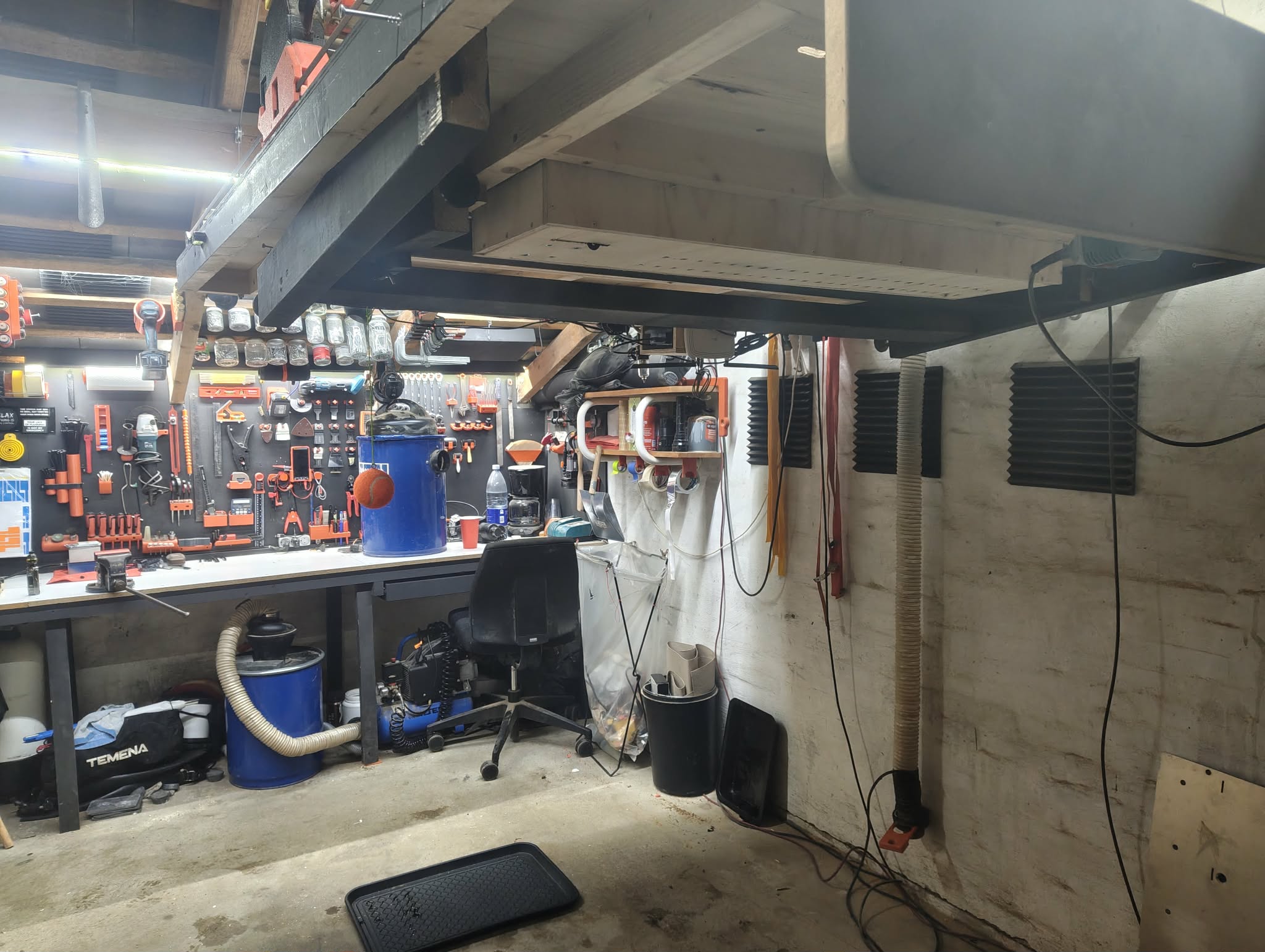

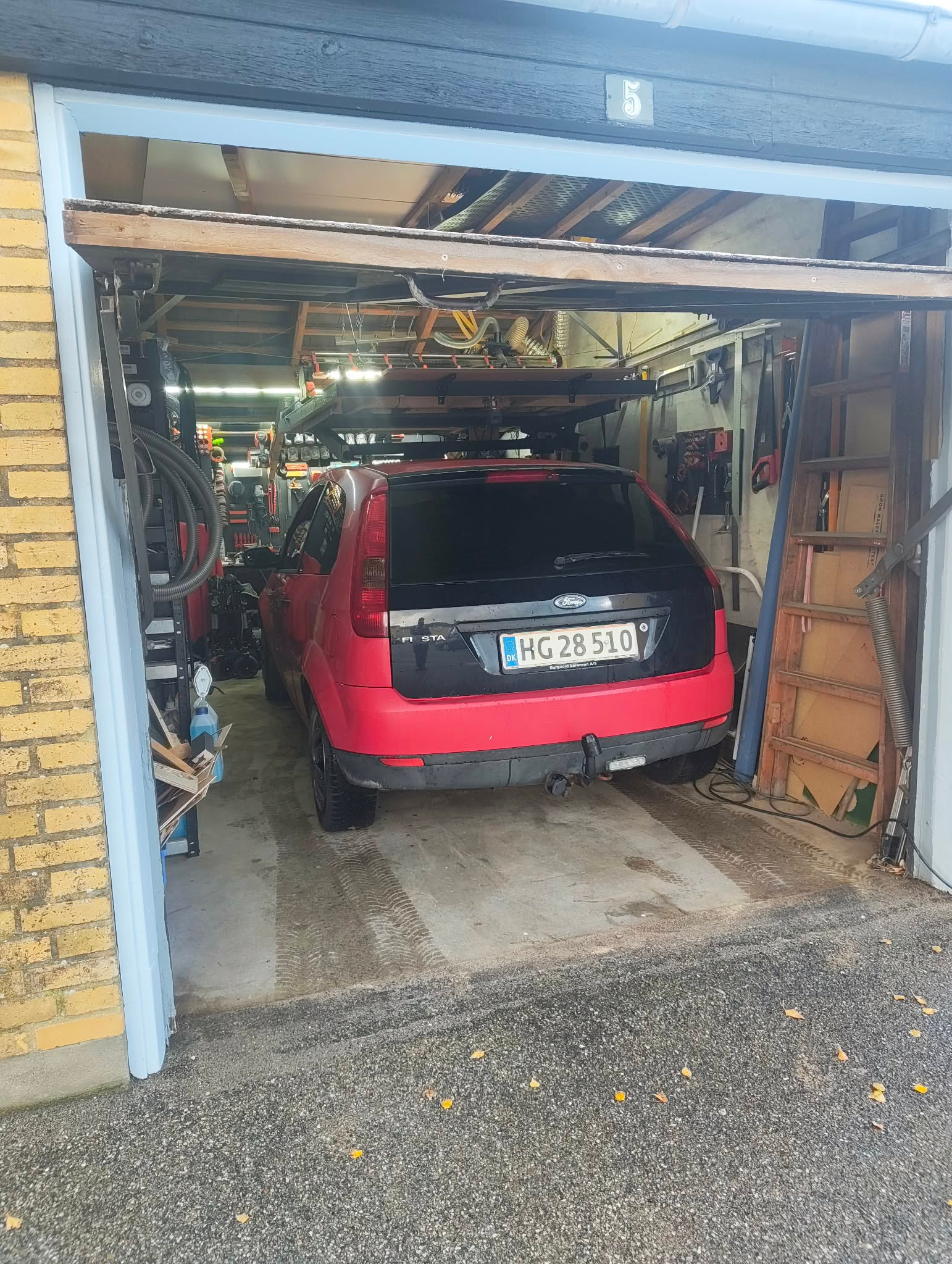

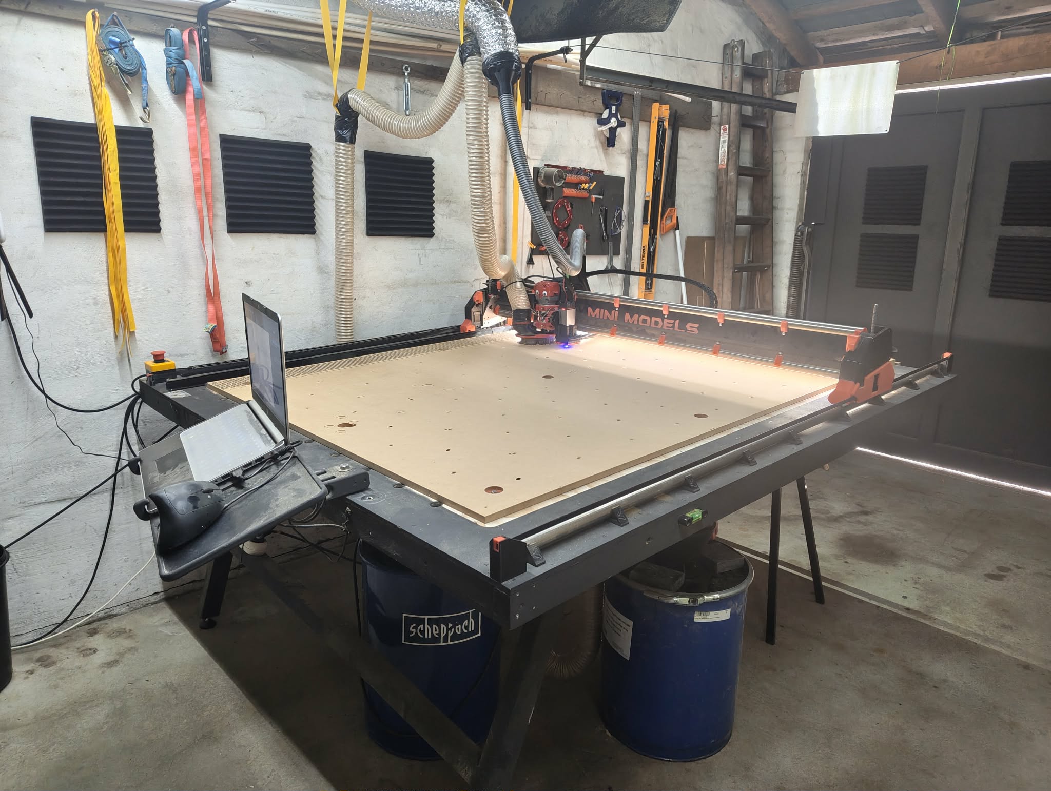

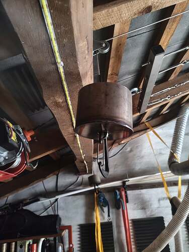

My setup.
I like your fiesta! Always interesting seeing the different makes our u.s. car makers make outside the u.s. My last job took me to Mexico and seeing the quote “chevy’s” there was interesting! And finding Mexico still making Vw bugs when no one else was! What a world!
