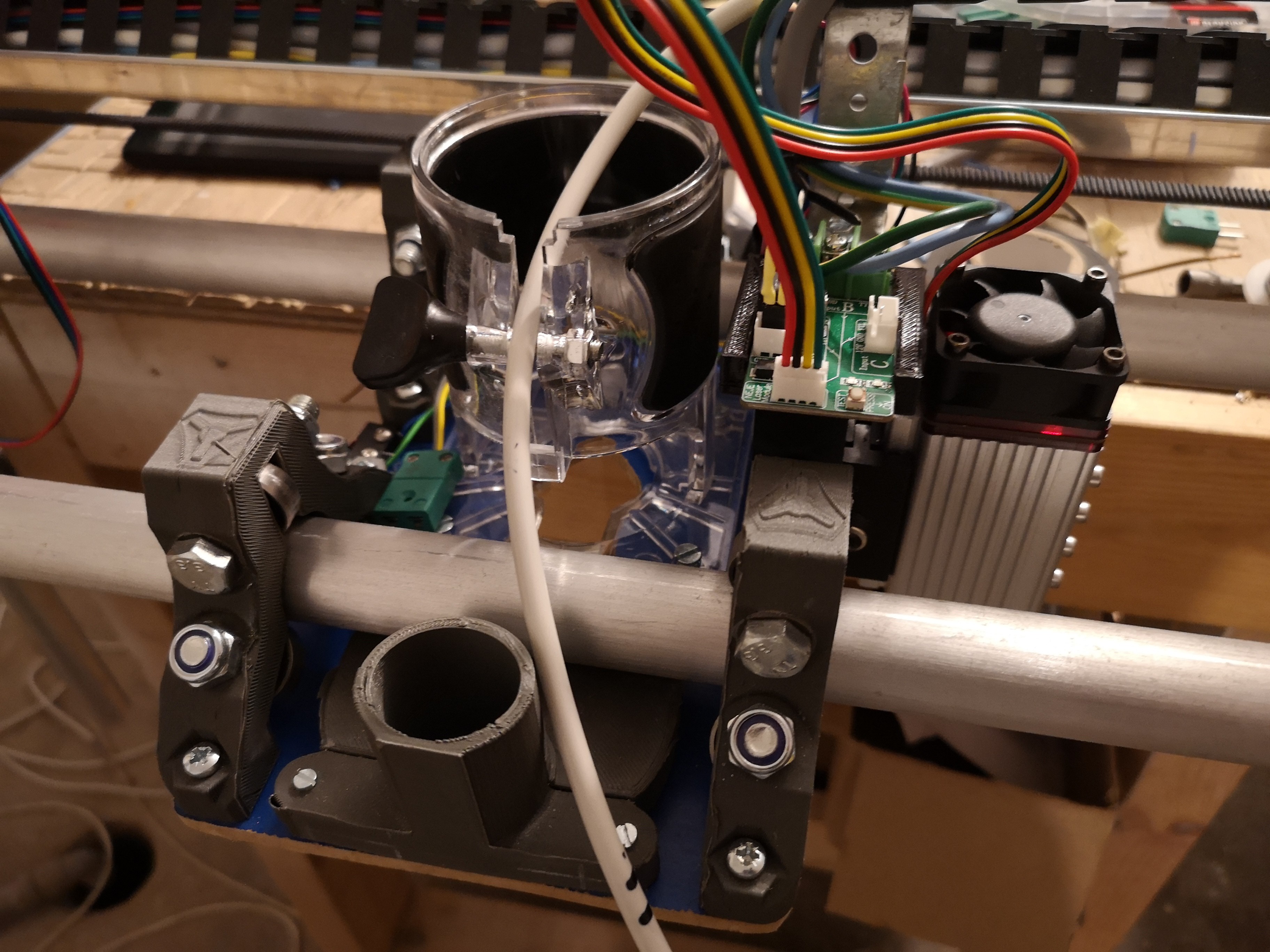

Lowrider SKR 1.4 Turbo 2209 build with laser
First of all thanks to Ryan and everybody else making this seem possible :raised_hands:
I am almost there, it has been a challenging journey, hours of googling and assembly…
I went for the dual endstop, i hope it is worth the extra hassle…
Electronics and programming is always a challenge for me, i need full guidance :grinning_face_with_smiling_eyes:
Hardware:
SKR 1.4 Turbo with 2209 drivers and TFT 35
NEMA 17 from stepperonline, bipolar 1.8°
12V PC PSU
Neje 30W (4W) laser module
Makita knock off China router
Firmware choosen was Marlin_V1CNC_SkrPro_DualLR_2209_2.0.7.2_510-src, have no idea if this board is different from the turbo?
For the TFT i think i used this BIGTREE_TFT35_V3.0_E3.26.x.bin will check…
I 3D printed my own box, very bad design, it is horrible to wire the board in the box.
Working area is 3000x1300x200mm. I reused some old tables, it is kind of a proto to learn what i need to do with vac table and so on. I used some alu 30x30x2mm angle profile for rails, it is to flimsy since i have it sticking out 400mm, maybe with some support it is ok.

Laser TTL, you think it is all good you have 12V TTL so you are fit to just put in on F0. Dos not work, the modulation is done on the gnd, so there is always 12V on the signal pin. Cant help you yet, need to find out how to fix that…
I am missing Z1 endstop ( see picture), so i am unsure is it because of i have skr pro firmware (and not Turbo) or is this just the way it is? and what to do about it? where do i wire Z1, an can i keep the Zprobe?
Stepper wiring or steps/mm? I have done no adjusting what so ever, used all recomended GT fittings, when i make x move 10mm it moves 47mm, so did i wire the stepper wrong or i just need to change steps pr mm like when you calibrate a 3D printer?
Being off by this amount is strange. Is this true for all axes including Z? Is this amount consistent no matter where the router is position relative to the origin? The V1 maintained firmware is setup for the spec’d hardware, so before changing steps per mm, I’d check the following:
  • Do you have the right pulleys on the steppers?
  • Do you have the microsteps set correctly for the steppers? I believe for the 2209, it should be set to 32.
With being off by this strange amount, I’m thinking you have a combination of issues. Perhaps check the grub screws on the pulleys as well.

Not sure what you mean by “library folder.” When you open the ZIP file, inside you will find a compiled binary file plus a nested ZIP file. You have to unzip the nested ZIP file in order to access the Marlin source files. As for laser support, V1 only enabled lasers in the firmware for boards where they tested the laser support. There is no explicit problem with lasers on the Turbo. You will have to do the work. Using Meld to compare the configuration files, you can identify what lines need to change, plus you have to identify what pin to assign for laser support. I don’t know enough about the boards to say whether the pin used for the Pro will work for the Turbo.

Almost succes, i fired up the laser…
now just need to get the endstop working and installed a safety stop :stuck_out_tongue_winking_eye:
