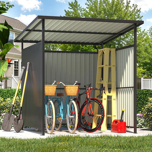

I’d like to keep my MPCNC outside under a shelter. It would be protected from direct rain and wind but exposed to outside air. I’m in the UK so it rains a lot, gets cold, humid etc.
I know there’s a an Ice Man on here who keeps his in a freezer! So I don’t think what im planning on doing is crazy. If I can keep it in the garden I can use it more often.
My question, Would the control board be better off in a semi sealed container like a food storage box. Or open to the air with natural airflow?
Any advice would be appreciated.
More context. I have a garden but it’s a rented flat. So can only build a temporary structure.
thanks guys!
thinking something like this.

I would think if you released the belts and brought the actual LR4 inside when not in use you would be ok with this. I would also cover your table to protect it from rain as well.
Would that required recalibrating everytime?
I currently carry my MPCNC outside everytime I want to use it. And it;s a real pain. And then pack it away again.
So im hoping to keep it out there 24/7
No it shouldn’t. The actual mounts where the LR4 homes from wont change.
Agree with Jonathan, bring LR4 inside when not in use, otherwise…
Previously built an outdoor electrical/LED project that’s enclosed but not sealed. Similar weather to UK but less miserable. Only lasted 3yrs, wish I’d proactively sloshed some conformal coating onto electronics to help last longer. Enclosure needs to allow the MCU and heatsinks to dissipate heat to avoid stepper drivers overheating and shutting down randomly.
So I’ve accidentally tested this idea because the shed my lowrider is in leaks. At first it was slight. Now it’s catastrophic.
I too have the electronics in a waterproof box, so they’re ok. My MDF table has essentially dissolved, and the steppers and rails have started to rust… doesn’t seem to have unusably buggered them up yet….
But it’s definetely less than ideal! I reckon you could build a table that would mostly survive being outside and bring the gantry indoors, as others have suggested. Or put a felt roof and removable side panels on the table…basically turn the machine into its own shed?! :rofl:

PLA is susceptible to UV degradation. You may want to consider printing parts with PET-CF.

Waterproofing the electronics would help as Aza alludes to above.
