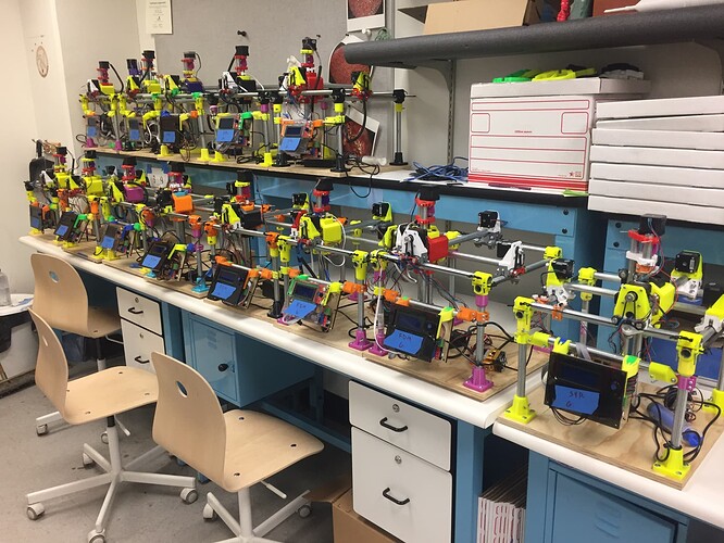

The first one I remember, was a while back, 2018, but it stuck in my head. The students all built their own MPCNC. From there the assignment was design, build, code, use your own attachment.
I know of a few high schools that have had half the students build up the machines and table and the other half learn about CAM to use it.
Some schools just build them and have the students use them for projects.

Wow, I love that picture of all the MPCNC’s! I am very interested in an ongoing discussion of ways to get these into schools and help people use them.
