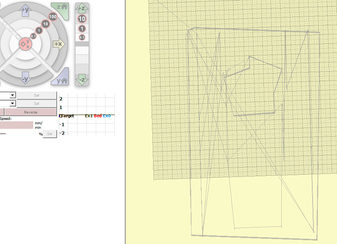

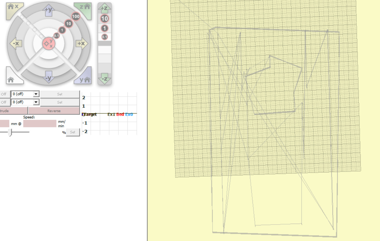

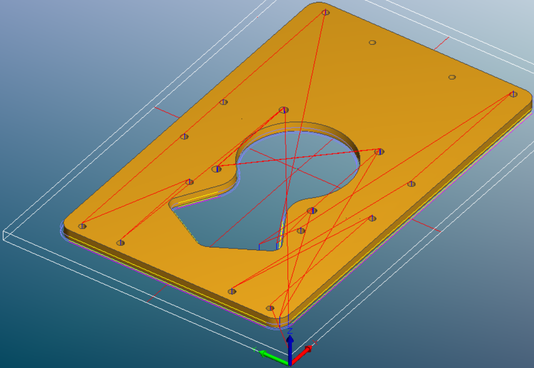

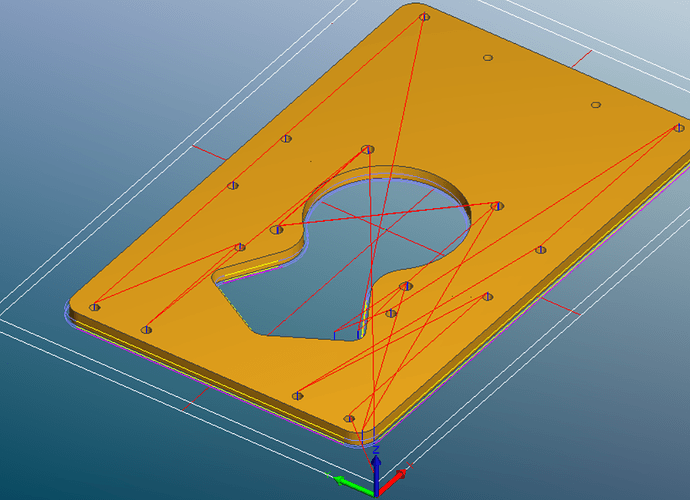

Fairly new to CNC here but have finally worked up the courage to post. I just ordered the MiniRAMBo to drive my lowrider CNC and am curious if anyone has had any luck flashing the GRBL firmware on it? I THINK I will be better off if it was flashed with the GRBL firmware rather than Marlin because I have experience controlling CNC machines through a host program such as Linux CNC but am not familiar with LCD and SD controllers. I have not found a good host program that can run Marlin on Windows 10. (I would like to stay away from Pronterface, Cura, & Simplify3D) and am thinking the universal gcode sender (USG) will be an easy option to use with the GRBL firmware. Any guidance here or reccamended programs that can opporate as a host for Marline would be greatly appreciated.
Not sure why you want to stay away from pronterface, but repetier host works well. So does octoprint and cnc.js, which are both installed in my v1pi image.
The mini rambo hasn’t been ported, afaik. The grbl for mega is close, but you have to figure out the pin mapping, and set the digipots.
I did have grbl on my LR when I first made it. It was very similar to the setup I had on the MPCNC and there was not much difficulty in the configuration.
Thanks for the response Jeffeb3. Unfortunately I am still having issues and am hoping for some more suggestions/guidance. The shop space I have access to does not have wifi so that rules out anything web based. I have tried pronterface and repetier but unfortunately neither of them will respond to my gcode files properly. I am using MeshCAM to extrude 2d DXF files and produce the gcode. See attached picture of the gcode and DXF file in MeshCAM and also the gcode file uploaded into pronterface. Repetier will upload the gcode but will not display any print (or in my case, tool path) lines.
It is important that I am able to produce gcode from the DXF files and get them to the router. It really feels like I’m cornered here but I know there has to be a way. Any help is greatly appreciated.
The tools Ryan has guides for: EstlCAM, repetier host, work fine with the mini rambo without any wifi. You should look at how he sets them up, at least, to see if you can get them working.
