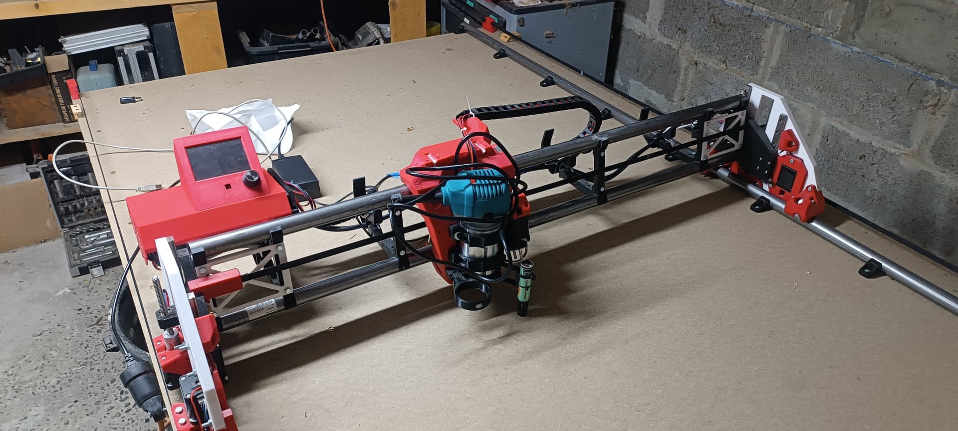

I have made good progress on the lowrider v3 project
-I set up the table
-set origins
-control the diagonals
and now I try to run a test program
but the first movement of the machine is z- (until the collision)

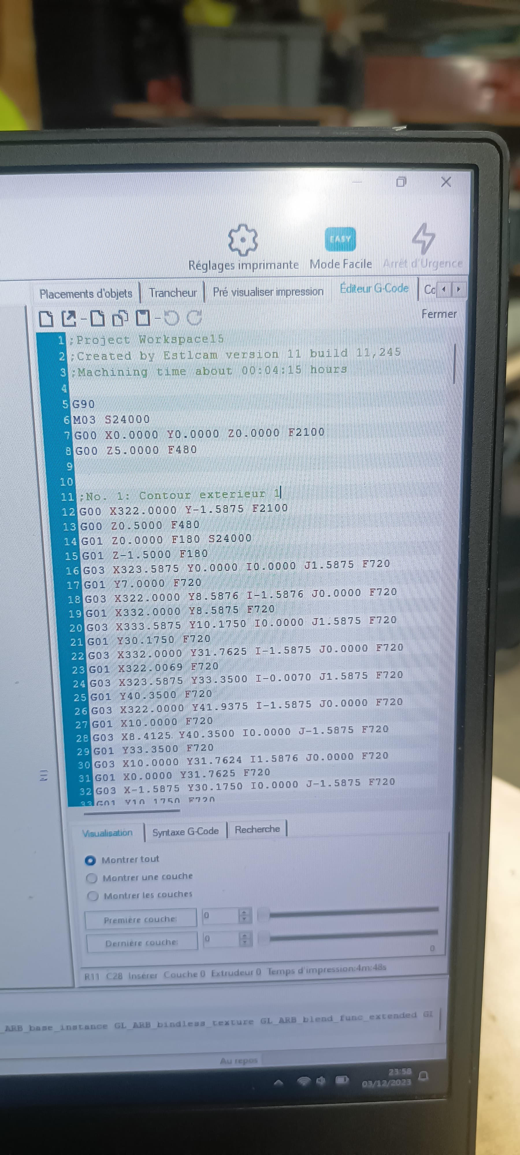

I followed the tutorial via estlcam, recorded my gcode then I put it on an SD card to put it in the LR3
I am attaching some photos
Do you have any idea what I did wrong please?
When you manually move Z in the negative/decreasing direction does it move closer to the table?
Does homing the Z axis work?

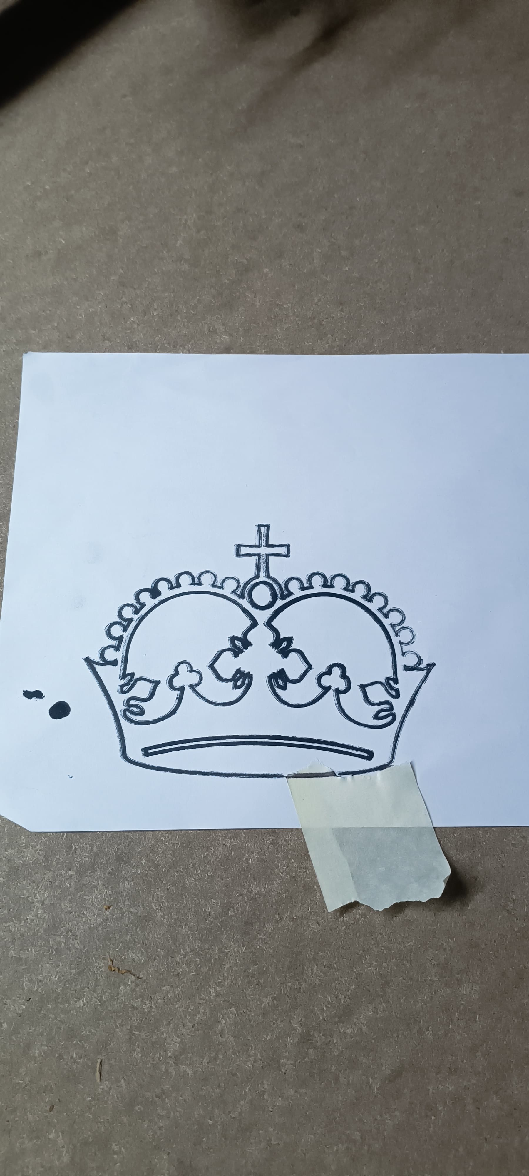

Does the test crown work as expected?
hi ryan
so my z homing works well
the Z+ goes up
for the test of the crown it works if I take the file that you provide in the tutorial but it does not work when it is me who creates the gcode via estlcam (probably a bad configuration I will repeat the tutorial point by point)
THANKS
Pay attention to the speeds, and make sure you only use the probe starting gcode when you are using a probe.
Just to note that EstlCAM doesn’t create gcode files automatically, you need to change the *.nc to *.gcode when you save the CNC program. Not sure if you have already done that.
it’s good I found it I was missing the g92x0y0z0. at the start of the program
