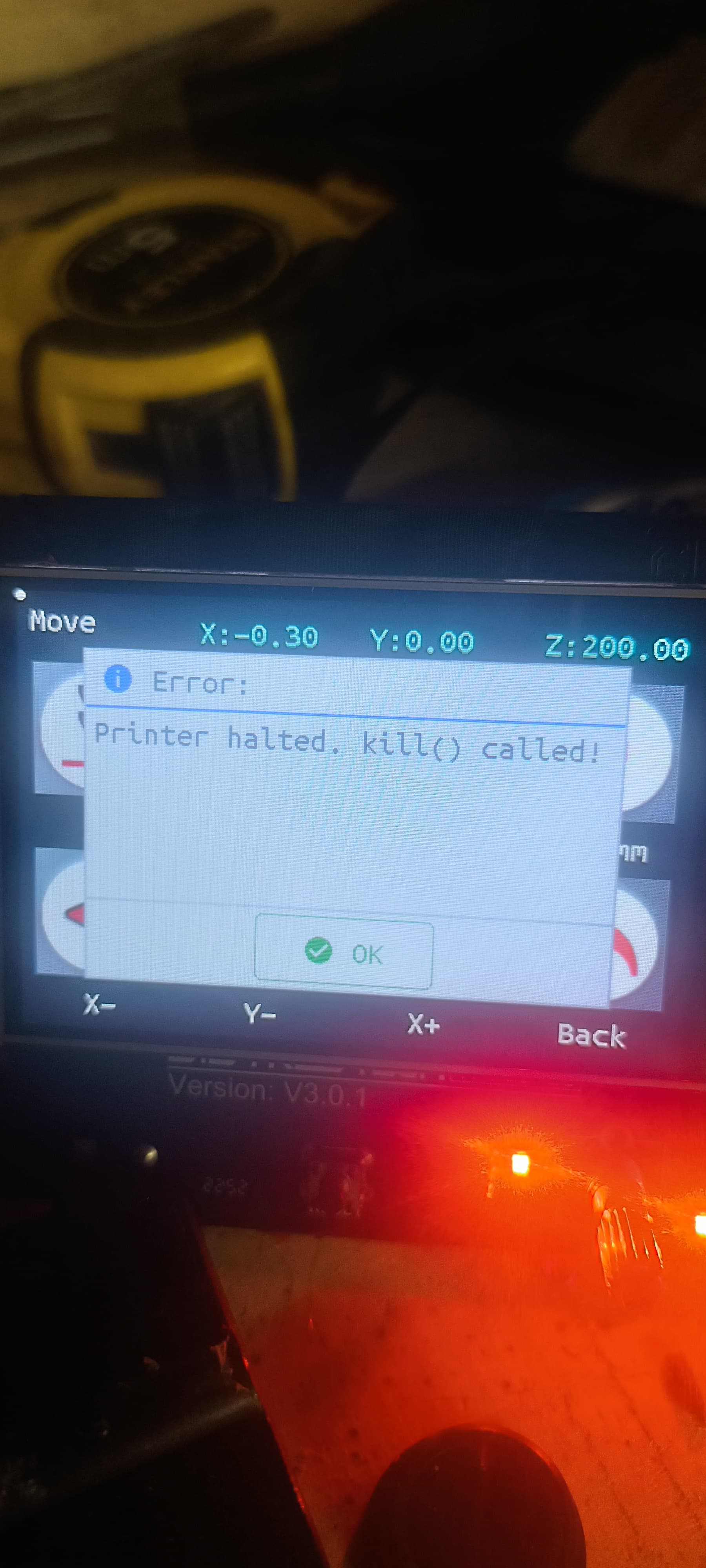

Nothing :sob:
I hear a noise but nothing more
I can’t post a vidĂ©o

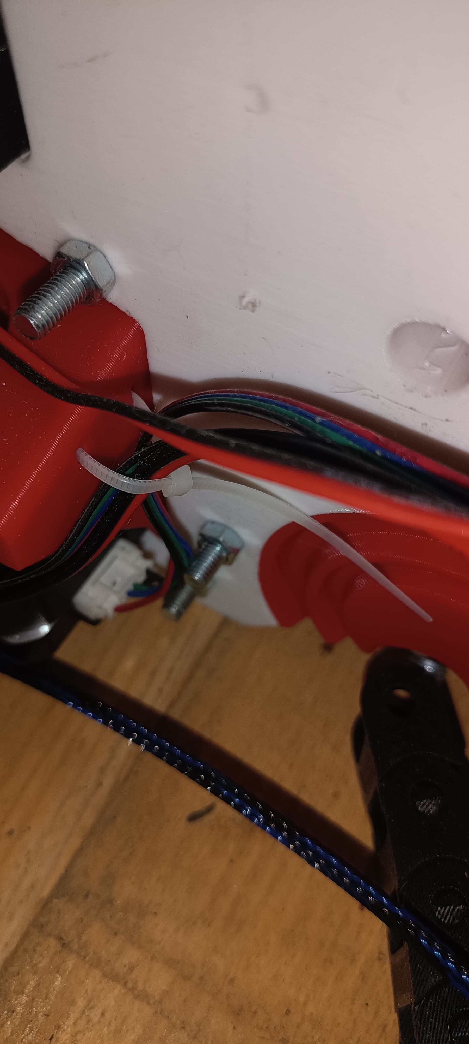

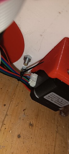

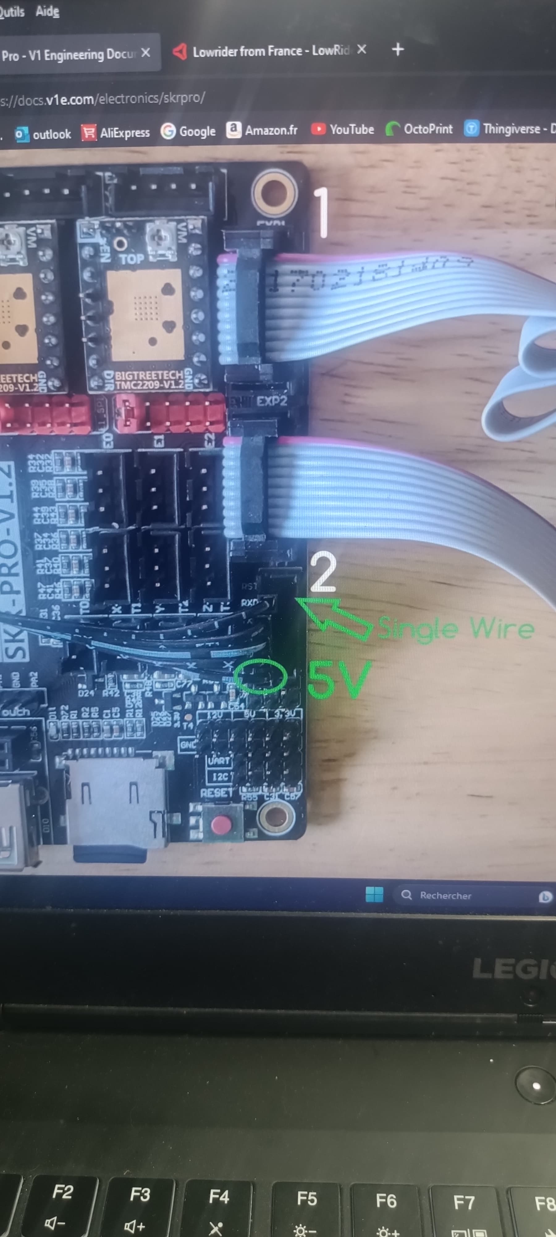

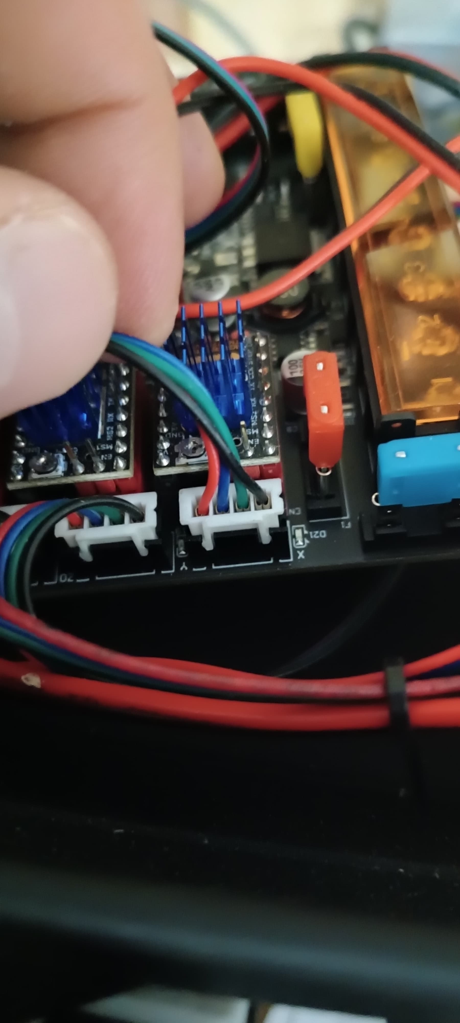

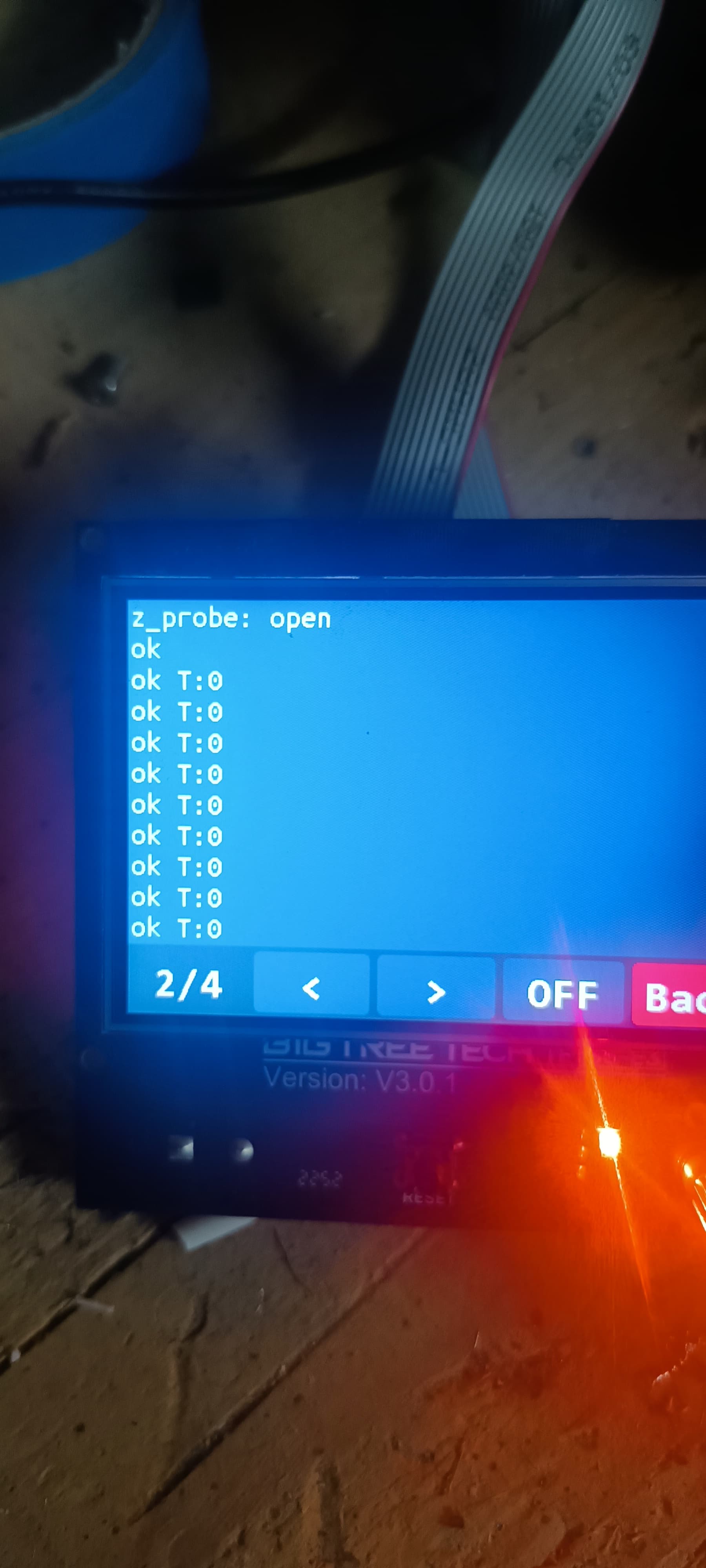

I have a doubt about the black cable I put the only cable on the right (tmc 2209 side) but the other 4 cables seem different to me from the tutorial
You are only moving 0.1 mm at a time, which may not be noticeable. Try moving 1 mm (be careful not to move 10mm, if one motor is reversed it could cause damage.
Also manually move the parts to the centre of the build, so you’re not pushing against the ends
Bread board jumpers would be a good testing solution if you doubt the black cable on the tft
it’s the same for 2 or 3 mm

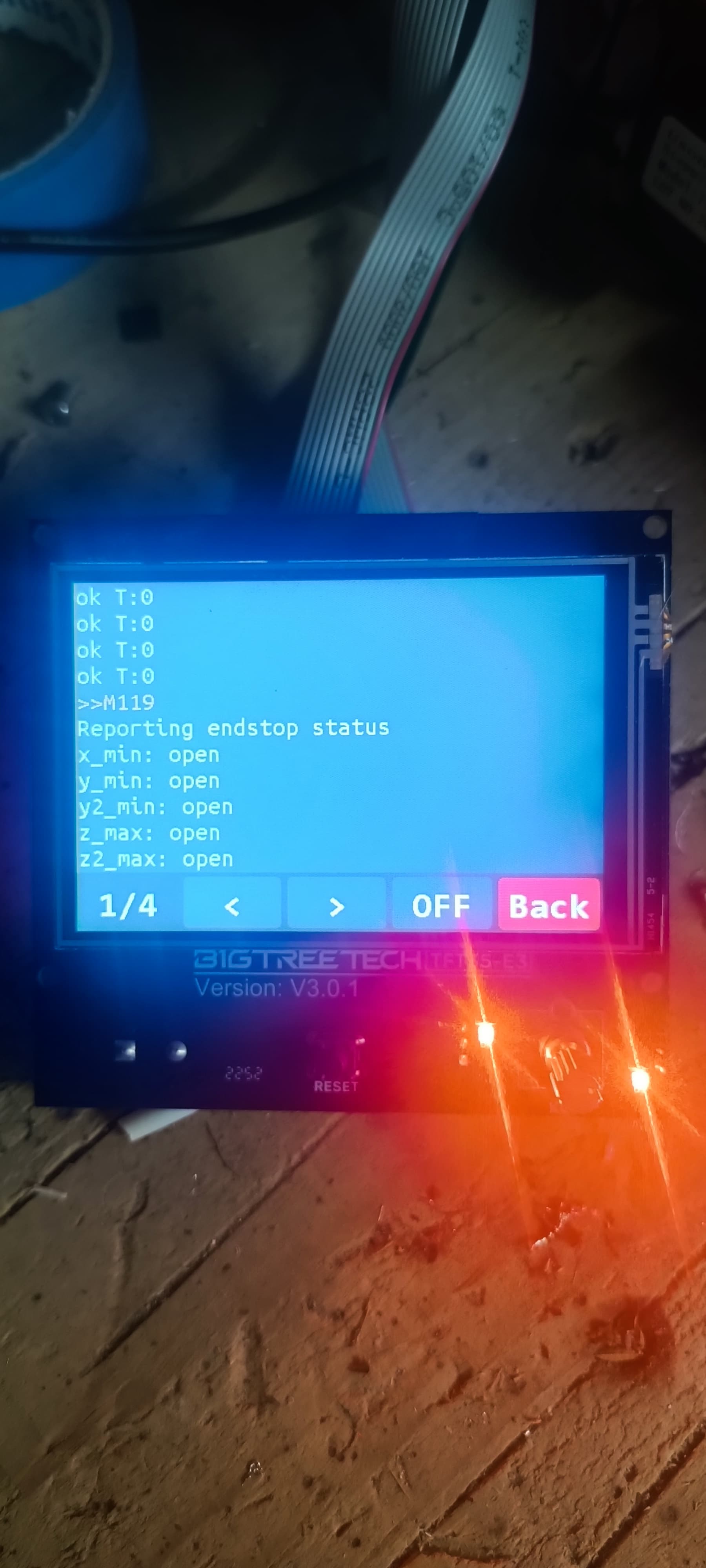

Open the terminal on the Screen and type M119
Typically that means your steppers are not wired correctly. Did you buy my steppers or did you source them from somewhere else? What type are they?

For the M119
Those are stepper drivers, what motors do you have, they seem to be wired wrong. If you want to post a video upload it to youtube and put the link here.

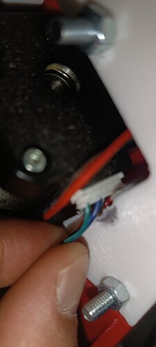

Photos of the connection at the motor would be greatly appreciated, or like Ryan said. A video of the motors and then trying to move would be great!
@vicious1

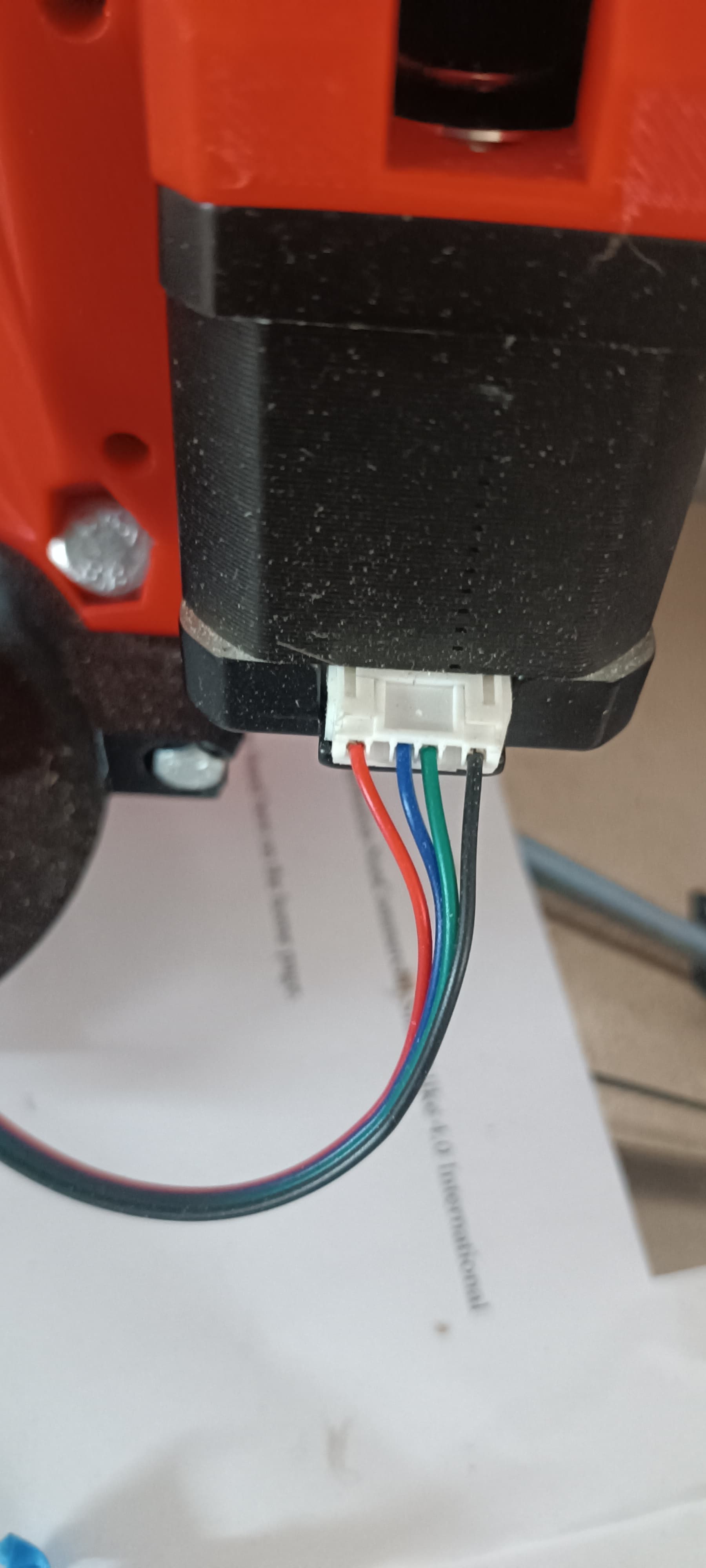

Try swapping your green and blue motor wires.
I think you found my problem
what would be the correct color order?

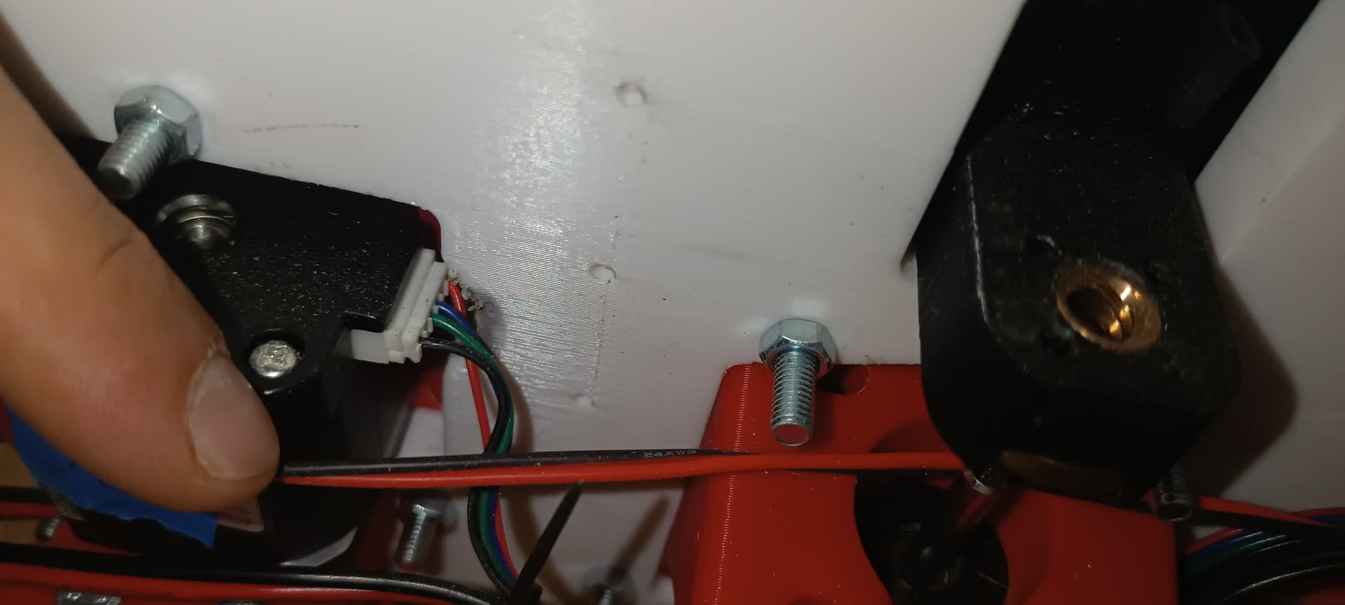

I have 4pin jst on the skr. and 6 pin jst on the motors as you can see my cables are not all the same
I will have
-red. empty blue green empty. black on the x axis
-red empty black blue empty green on y 1
-red empty blue green empty black on y2
-red empty blue green empty black on z2
-red empty blue black empty green on z1
THANKS
Just swap the ones I mentioned and see if it works. It can’t get worse than what you have now. I can not know for sure unless I had one in my hand.

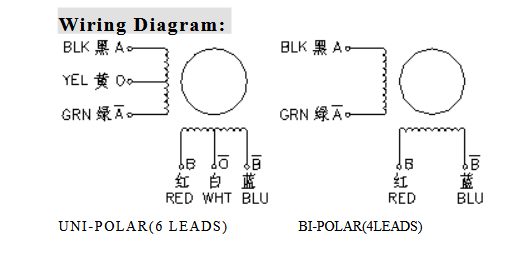

There are two pairs and the board wants 12 and AB, right now you have 1A and 2B.
Oh man what a nightmare. You are going to have to check each one. Once you get a good one you can easily match the rest. Give that company a bad review.
Hopefully this helps
Datasheet for this motor: 17HS8401 datasheet(9/22 Pages) MOTIONKING | 2Phase Hybrid Stepper Motor
Screenshot 2023-11-06 083714
It doesn’t really help because for some reason they wired the motors all differently. You have to manually test for pairs, short two wires and see if it gets really hard to turn.
I just checked what happened is that I had to put longer cables than I already had in stock 1m and 1.5m
I didn’t use the cables supplied with the motors (I think that’s my mistake)
