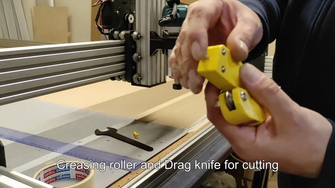

This drag knife seems to request 2 pass while this one need only one : sorry I can add a link:
youtube : CNC DRAG KNIFE and CREASE TOOL SET. CARDBOARD BOX from viewcreative
But no idea if it is a limitation of the MPCNC or if it is drag knife related.

I used to work for a place that made purpose built cncs for corrugated. You need quite a bit of down force for the crease roller to squish the board. I’m not sure the lowrider can do that. It’s pretty easy to deform the stepper couplers.

I believe this is the video you are referring to:
They state
Spring operation 0.3-5kg load for smoth cutting
It should be possible to get >5kg of downforce from Lowrider if you fill gantry tubes with sand. By default it may not be heavy enough, although it depends on what wall thickness the tubes are and what size the machine is.

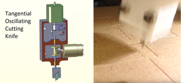

Passive drag-knives that sit in a router collet are relatively common and easy to find. They are also fairly easy to make yourself and software solutions are almost out of the box. Plugins exist for most popular packages, including Fusion360. Here’s a looong video by the author of drag-knife support in FreeCAD which does a pretty good job of explaining how it works https://www.youtube.com/watch?v=40CRimcwAZo
I would recommend to start with a passive solution because motorized (4th axis) versions are a lot more complicated, especially because the software side of things is a lot less mature.
If you go motorized route, consider going a step further and trying an oscillating design. I’m not sure if an ability to simply turn the knife is worth the extra hassle and hardware.
