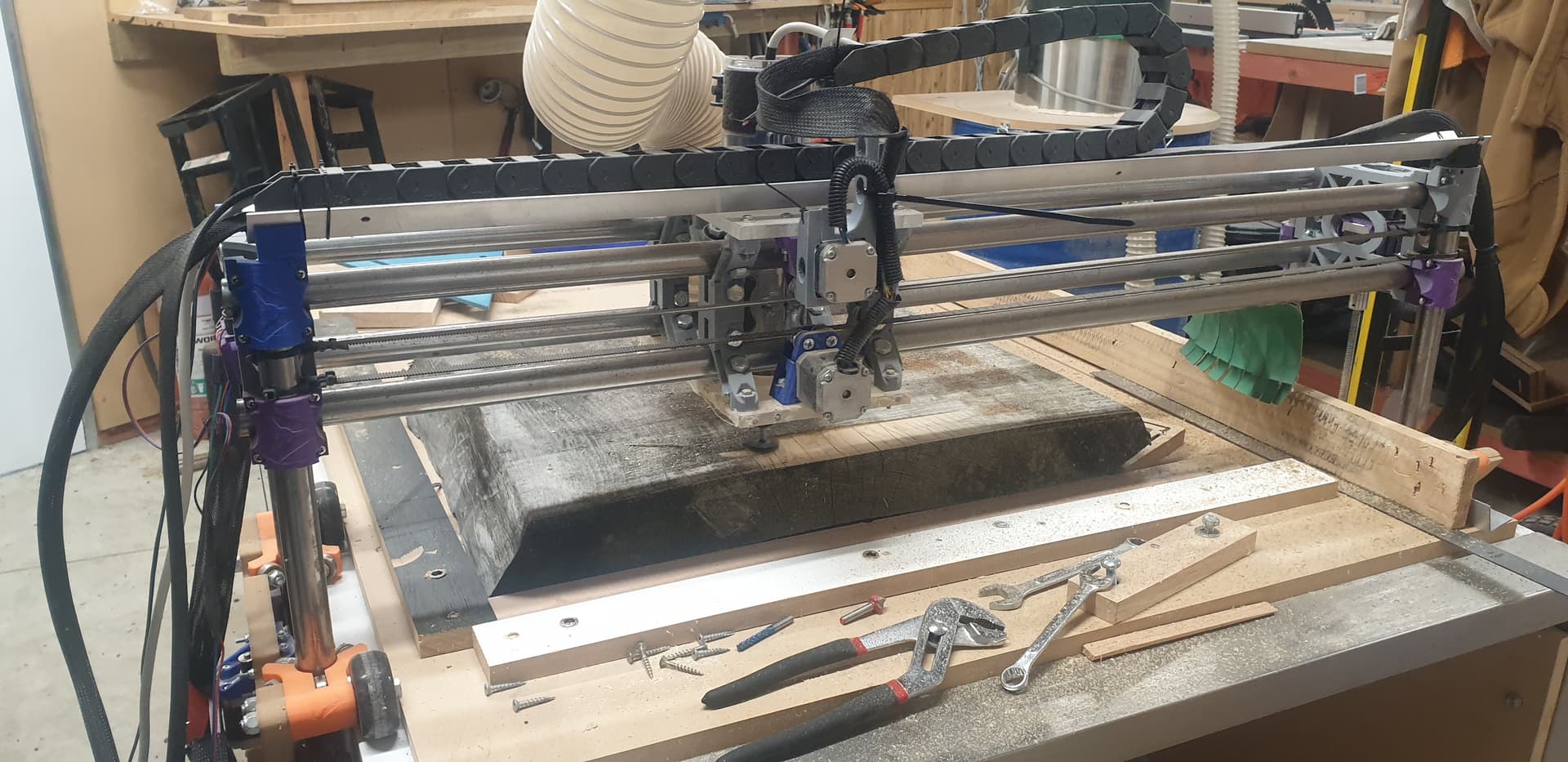

Have you gotten your LR4 assembled? How’s the fit of the core on the gantry?
Me? Yeah fully assembled and the core was snug as I put it on and I didn’t need to tighten down the bolts at all. They’re stainless 1.5mm thick I think.
Although it’s only fair that I say I’ve only done some lasering, engraving and drawing with it so far. I will have more free time after this week so fingers crossed I can sort my table out and make some chips soon.
Also worth pointing out I used different tube for the Y rail - it’s 32mm thinner walled stuff from my local bigbox store since I reasoned it didn’t need the rigidity. So I have enough of the heavy stuff to make another LR4.
I mean, I never will, but I could ![]()
Yeah, smaller for the Y rail makes a lot of sense. I think we’ll end up with the same tube just because of needing to buy it in a 5.8m length.

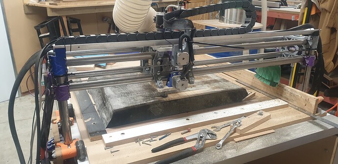

This is my modified LR2…

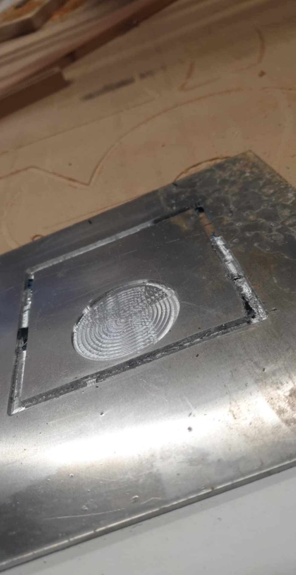

Thanks. I cut my plates on my LR3 before I stripped it.
Not perfect but it was only the second thing I did in aluminium and they work fine

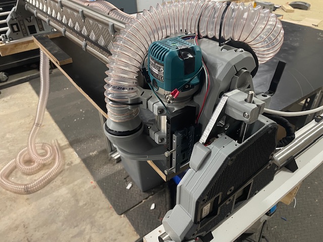

The tool mount on the LR4 is 65mm so it does fit the smaller size of spindles out there. Quite a few people have gone that way.
The larger 80mm spindles are not recommended due to the extra weight and the tool being so much further from the rails leading to more deflection/chatter under the same cutting loads.
From what I can tell, the 65mm spindles are actually way less grunty than a trim router when operated at lower RPM. They are definitely a lot quieter, though, if that’s your goal.
Making a spindle dynamometer is on my to-do list…
Oh its the small sized spindle, was just wondering as they are taller, would think it would need a different mount… why i have 2 levels on my LR2… and yes far quieter than a router…
I think the mount points are much more fixed. They shouldn’t need to be further apart with the taller spindle, all the force is at the same point, the cutting tool, so the mounts are in the same position regardless. If you had a ton of force applied to the top like cable drag etc. that’d be different, but that’s best avoided where possible.

And it looks like i can cut out the plates with the old LR2… very slowly…
