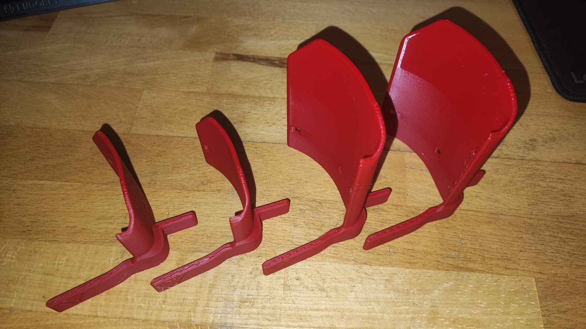

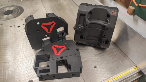

I now have one black/red LR4 in stock (minus the braces and the Y-rail clips, because of the different sizes), the alu plates are coming in Tuesday or Wednesday I hope. :slight_smile:
Don’t forget your Y rail clips :face_with_monocle:
New parts also included. :slightly_smiling_face:

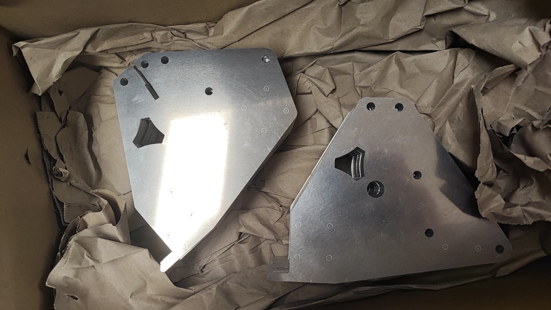

Yeah, well… Can you spot the problem… GRRR. First they forget to send out my package, then they just mark the holes instead of cutting them through. How does that happen???
I wrote them an email, lets see what happens… I could just cut a holder and drill those holes myself on the LowRider but that would cost me a few hours that I currently don’t really have. It also defeats the purpose of having them made…
That is some BS right there. Hopefully they refund you. I would just center punch and use a drill press if you have one….if they don’t remake the parts for you.
They are really nice and since I am in the EU they either have to fix their mistake or exchange the product. Fixing would be really expensive, they’d need to build a fixture etc.
I guess they are going to just send new ones, but I’ll see on Monday.
If I can keep those plates I am going to mill a fixture myself and drill the holes with the CNC, I bought drill endmills especially for the plates back in the day and have some well working settings, so once the fixture is in place it would take half an hour or so.
Get a little clip of the process if you remember. That should be interesting. I don’t think too many realize the power of a fixture for stuff like this. The setup takes a bit but after that it is just swap plates, hit go, repeat.
I do this in my catan video. :slightly_smiling_face:
I talked to them, they are going to send me new plates. The problem is that they can’t laser holes under 4mm and they are 3.25, so they drilled them the last time but didn’t check carefully this time so they forgot.
Seems I am going to mill a fixture later to try to salvage the other plates. :slight_smile:
Easier than I thought… 4 minutes for the fixture, 50 seconds per pair.
