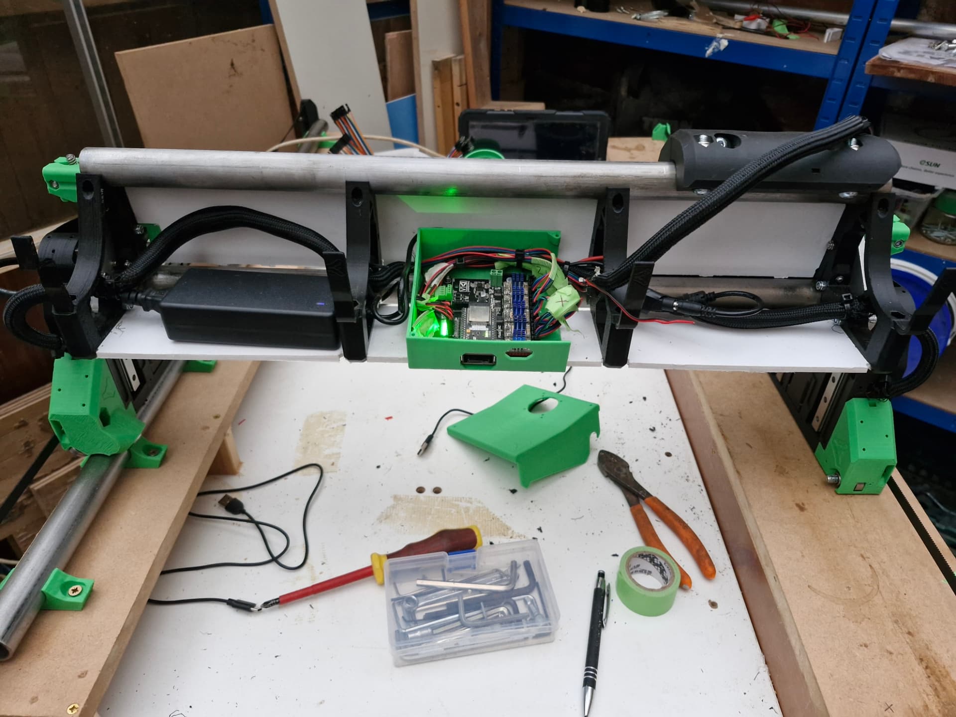

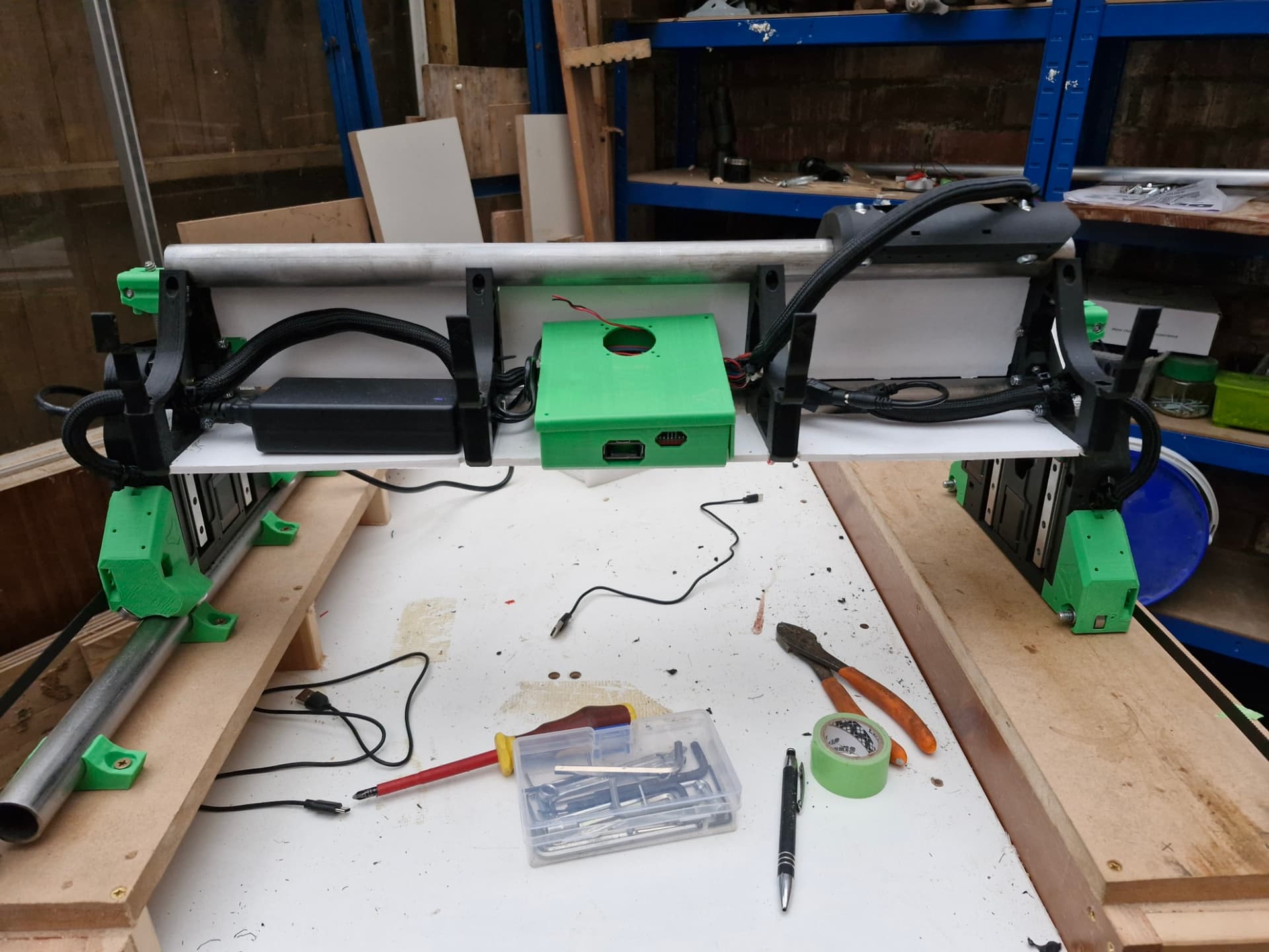

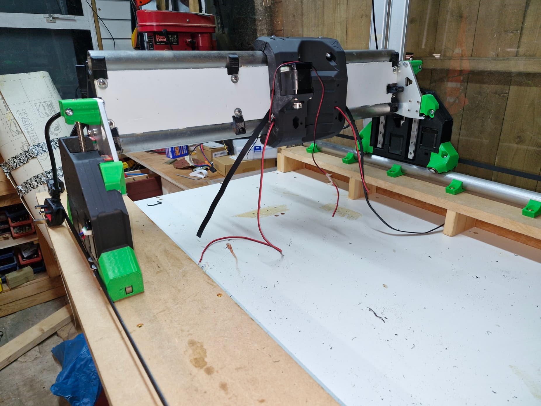

Lowrider 4 is a go from East Coast of England
Finally almost finished: slight_smile: it moves in the direction it’s supposed to :slight_smile:
The next steps is to get the fluid dial set up and cut a spoil board for the upper and lower sections of the table. I can then get it all squared and trammed.
The only problem I have now is that I need to find another project to occupy my mind in the evenings.

Just hit my first hicup The y steppers are struggling when the router is fitted, i presume due to the weight,
whats the recommended vref for the drivers?
thjey are 2 amp nema 17’s
Are you sure its the Y steppers?? I would bet its the Z steppers you are having an issue with. The ones that run the lead screw to bring the gantry up and down?
If I am correct, have you lubed up the lead screws? If you got the kit from V1 it should have come with a little tube of super lube. Put that on the lead screws and then run the beam up and down, I bet that takes care of your issues.
sorry yes i meant the z steppers don’t believe my upgrade came with any lube but i have some here anyway i use on linear rails
This is what should have come with if you bought the LR4 kit from V1…
If you got the upgrade kit then I dont believe its included. But this stuff on the lead screws works wonders. Any kind of lube will be better than no lube for sure.
thats why i love this forum somebody always comes up with a solution :slight_smile: the lube worked a treat
thank you
Awesome! Glad I could help!
