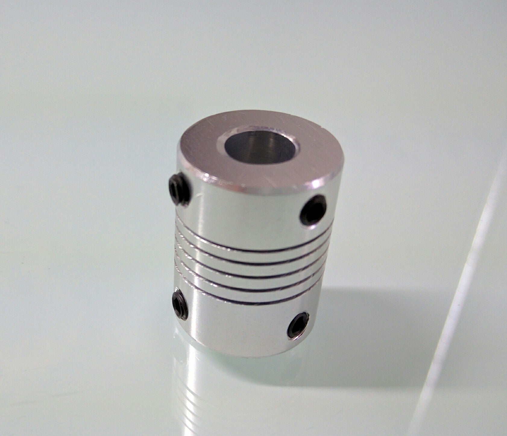

Also, that doesn’t look like the couplers used in the V1 kit. I’m wondering if it’s not gripping the lead screw well enough.

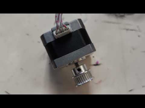

I swapped the motor the stepper motor and you can see the results in the video below,

Video at 0:15 clearly shows problem is demonic possession and/or coil and/or wiring issue. Consider :candle::candle::goat::candle::candle:, and/or different wiring combinations, and/or get a new higher torque Nema 17 84oz stepper?
when i moved Z0 to X it moved slowly…
this stepper i am testing on is not what i will be using. this is just a test motor. ( i copied the wire color from the other )

We should be able to figure this out while it is assembled. But if you really want to get to the bottom of it, pulling the motors out and putting some tape flags on them would make the difference very obvious and you could swap parts without introducing new wiring issues.

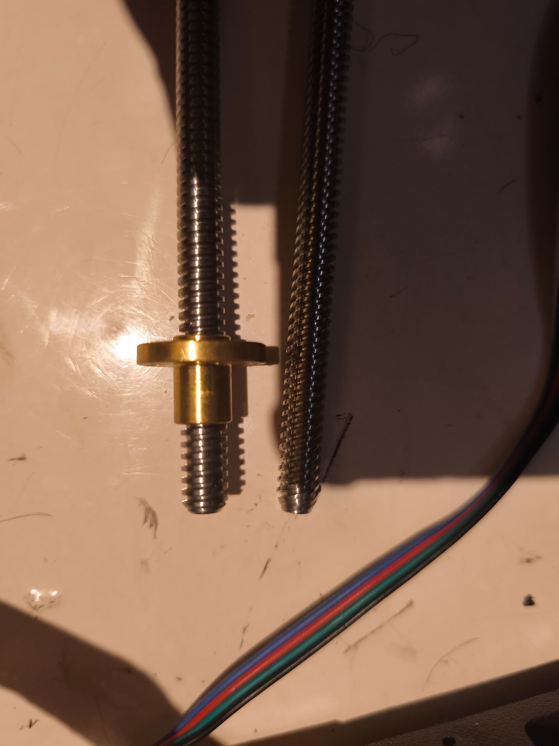

The problem was my lead screws…I was literally laying on the floor next to the machine and when I glanced over I realized that both screws had different pitches. I pulled them out sure enough the company I order from sent one screw wrong. Luckily I had the screws from my LR3 and I swapped those in and sure enough the machine is even on both sides.
The screw on the left is the one that was in my z1 motor and would only move 3or 5 mm on each 10mm step
