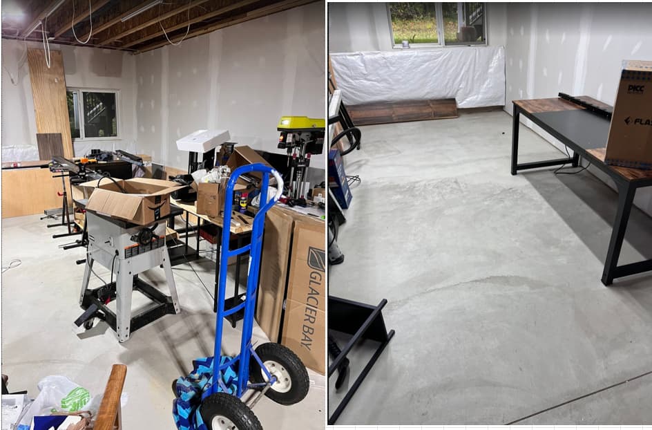

Day 9: Clear the corner of the basement. Get the table saw I bought off Marketplace put back together. Get Flashforge out of the box and onto its temporary location.

Day 9 conclusion: Got the area where the LR4 will be sitting during winter cleared out. Got the Delta tablesaw put back together. I’m thinking the wall to the right is where I might try and mount the table saw/LR4 contraption.

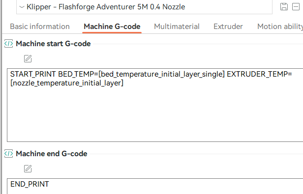

Updated Machine G-Code:
Now the next part is a little confusing to me. XBlax replies to one of your comments and says to home the head then lower it until it touches the plate. But I thought the printer had auto bed leveling?

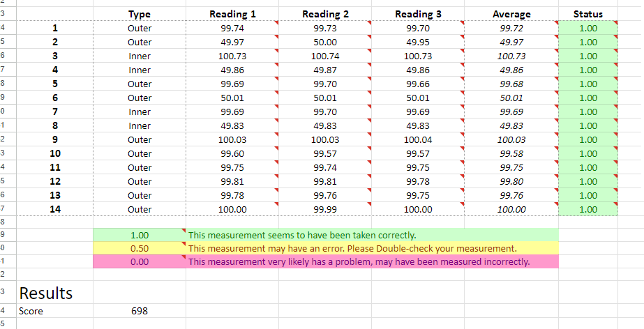

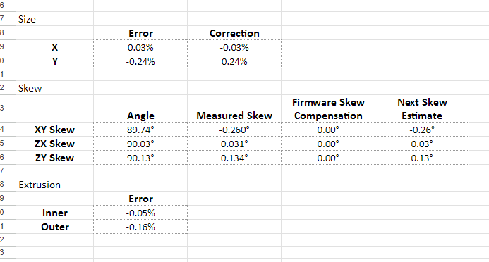

CaliLantern Results:

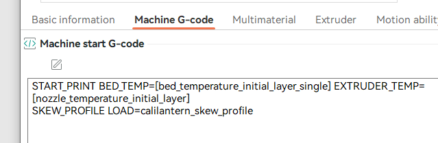

@DougJoseph is this where you put your Start GCode profile?
I couldn’t find any section in the actual Mainsail files that seemed correct. Printing another Calilantern, but I won’t be able to check skew on N2 until morning.
