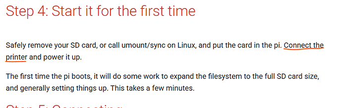

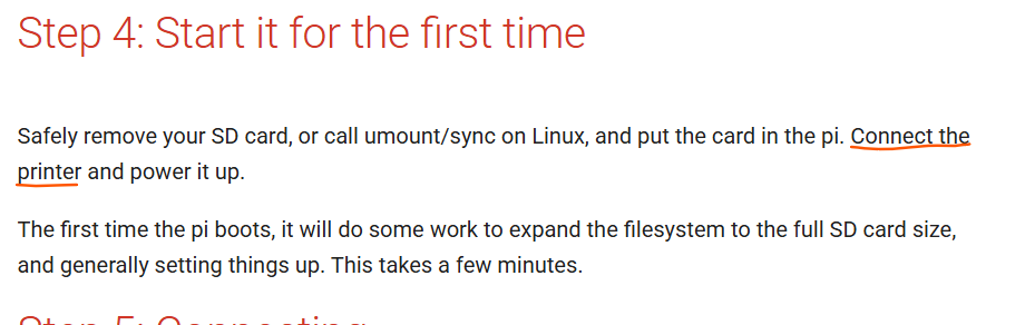

Dumb question time. I am am trying to setup a raspberry pi 4 for my low rider 4 and go to this step and dont know how to connect it.
How do I connect the raspberry pi 4 to the Jackpot 3 control board?

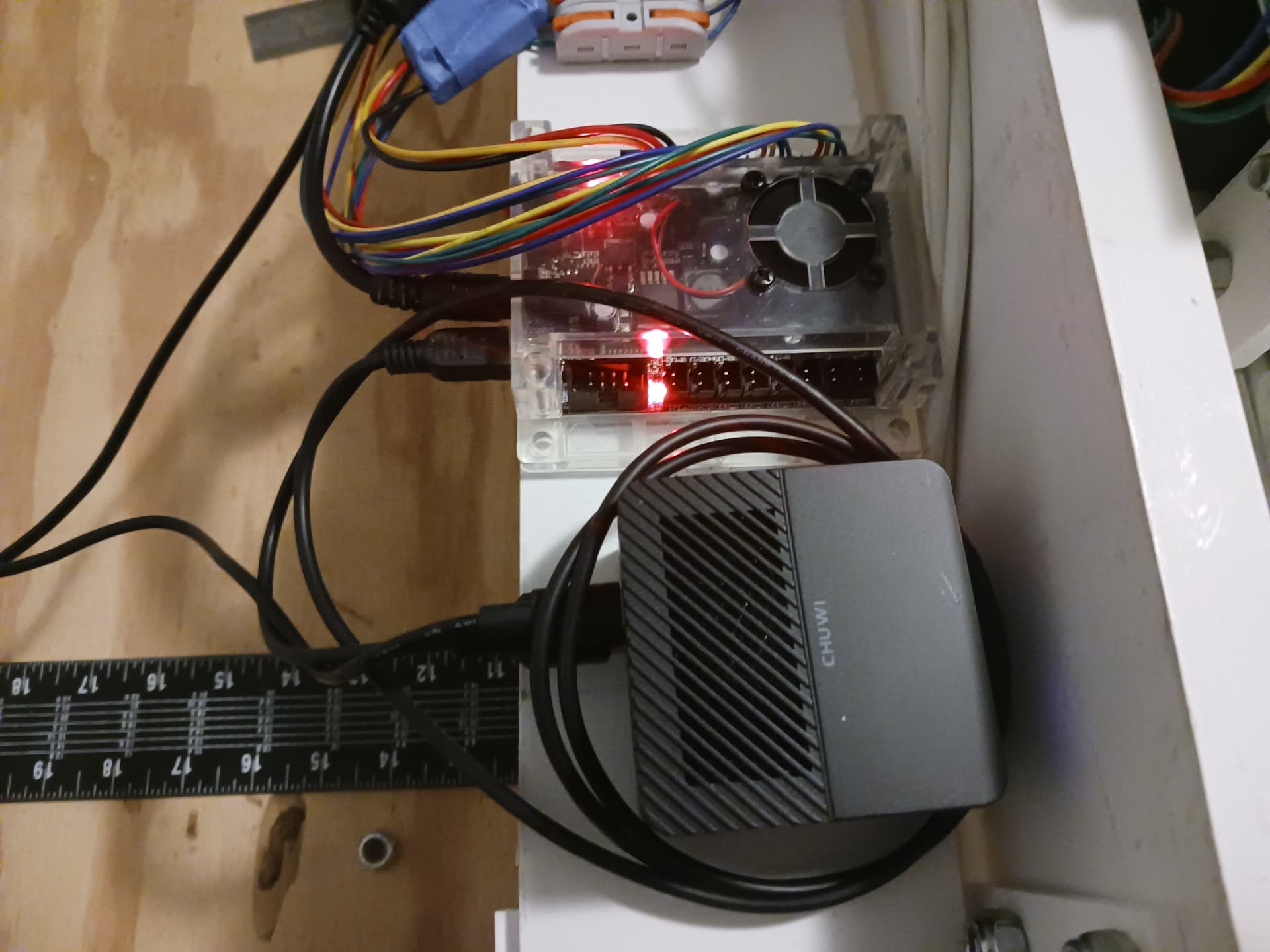

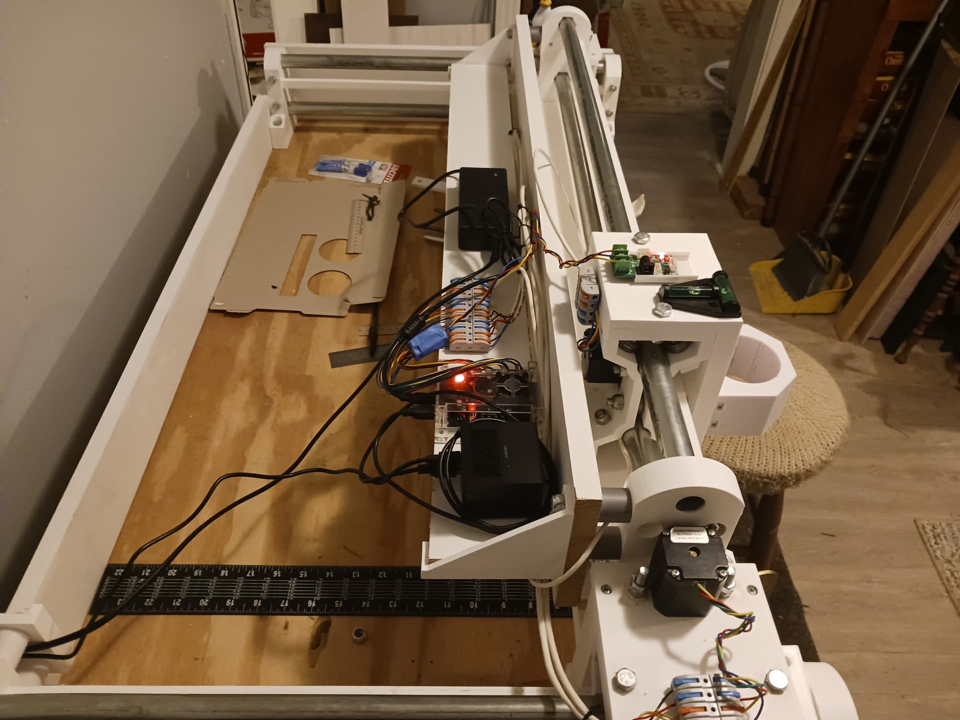

I know you guys are saying it’s out of the norm… but I much prefer using a headless Pi – or better a miniPC – sitting next to the Jackpot or other controller and connected with a short USB cable (could be a lot shorter here). The miniPC is that $81 Larkbox Pro (black cube) I bought and an 8-bit Grbl controller from my junkbox…
Even a very modest miniPC has far better performance and much more storage than a Pi and can host as many gcode senders as you care to try… but even a 4G, 8G, or 16G Pi 4/5 can handle Debian OS and a couple of senders easily. And even Lightburn. I also used Jeff’s V1Pi image and CNC.js for the longest time before I discovered the miniPC’s. And I’m aware that miniPC have gotten far more expensive recently… so Pi 4/5 may be actually be a good bet if that’s all you can get.

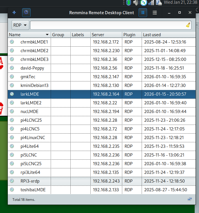

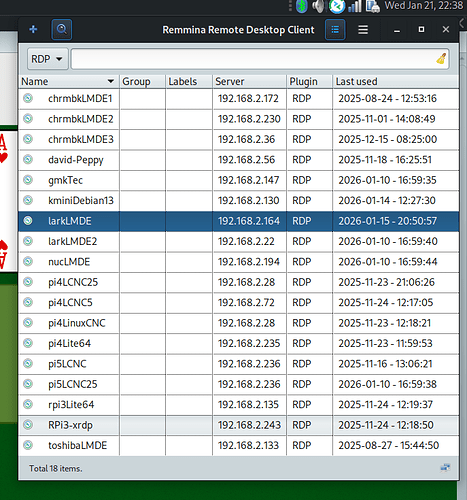

My wifi is decent enough (Starlink) that sending a gcode file to the Pi/miniPC is not a problem. And once it’s on the miniPC or Pi it has the entire file and once the job is started, it can handle the job unattended and free of any further wifi requirement. I do have each miniPC running an “xrdp” server and it allows me to connect to them with a RDP client and control them remotely… repurposed Chromebooks, miniPC, Pi, etc.

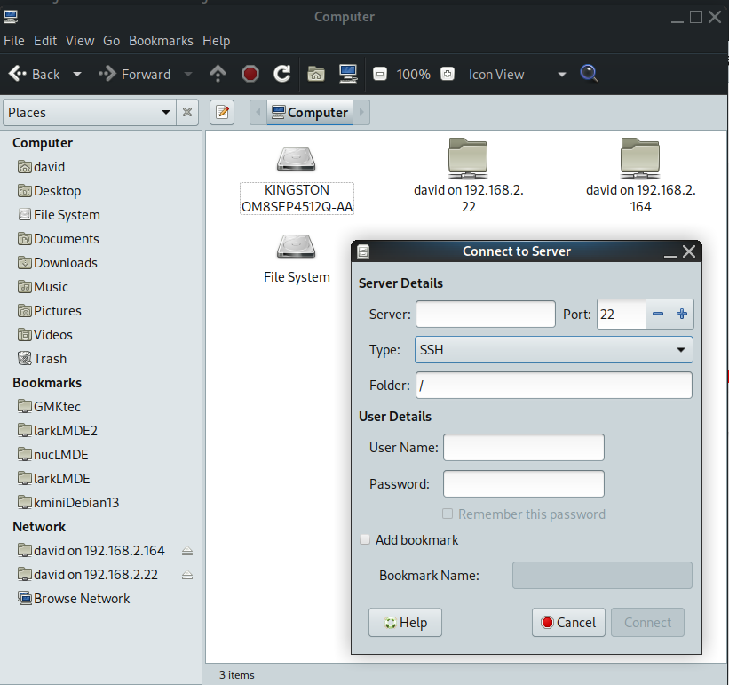

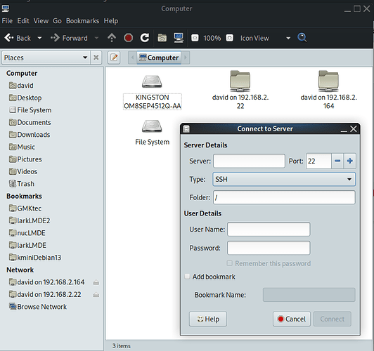

I also found the file managers on all my Linux boxen have a “Connect to server” capability that allows adding the remote machines to my main laptop…
and those “Bookmarks” along the left side are the remote miniPC’s that I can simply drag-and-drop (or copy and paste) files to… just like to any directory on my main laptop itself. You do have to enable “ssh” into each box to have the file transfers thru “sftp”. And even Windows can do this… though it seems a little clunkier to set up.
I recently helped @joegomez1479, a nearby neighbor, set up his new LR4 and Jackpot with this same capability… he liked my demo. He did set it up first using the YBR method in the docs… and used WebUI to verify operation. It worked and it was okay… but a little bland for our tastes. We then quickly set up a miniPC that I had set up for him… and Joe, an experienced Mach3 CNC’er, liked the look of gSender… while I prefer UGS. He actually has his miniPC hooked to a keyboard, mouse, and monitor… but it is a dedicated setup to his LR4. His main laptop is a Windows machine… and we were able to map the miniPC into his file manager as well (though details have conveniently been forgotten…) :wink:
