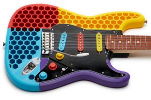

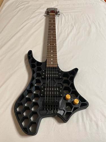

Speaking of printed instruments:
Widdly, widdly, waaaaaaahhhhhh!
Brings to mind Buckminster Fuller shredding on lead. :roll_eyes:
Nice work!
What a nice thing :heart_eyes:
I’m not sure if I agree that it is nice in a pure aesthetic perspective, but as a concept it’s super neat!! I think it would be even better with a printer similar to your plan, or what @forcerouge already got.
Ouch, I fell into yet another rabbit hole!!
An electric guitar is on my wish list. It would be great to be able to print the body in one piece. Then I’ll have to enroll in lessons because I have no idea how to play :smile:
You just pinch down the strings on the left side while strumming or picking at the strings on the right side.
We are just so used to beautiful guitars. If it was something else, I think the aesthetics would be above par. But maybe I am just easy to please :slight_smile:

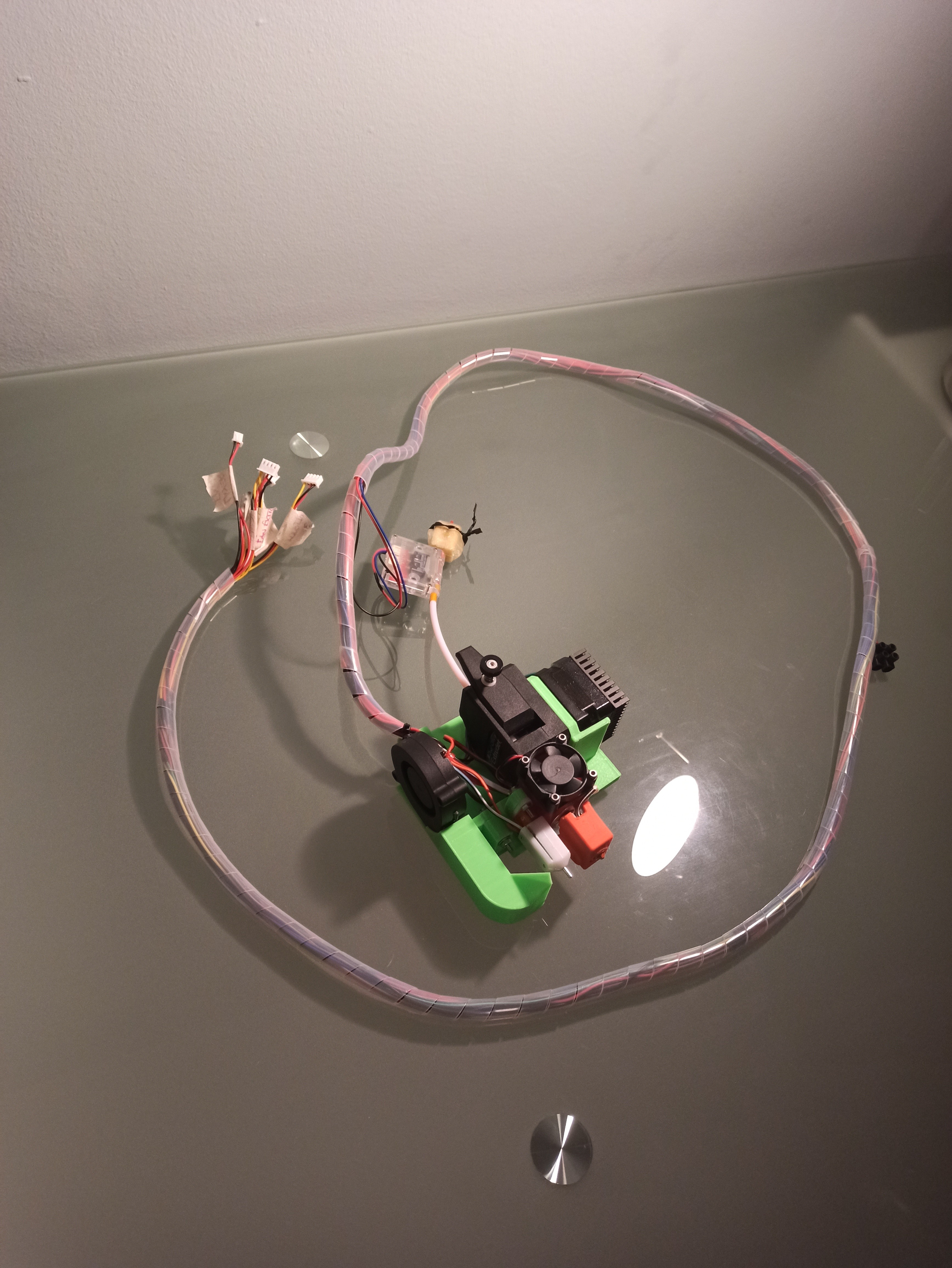

Do you have a list of the hardware/sw you used for your 3D printer build somewhere? Thanks
Greetings, and excuse my English
I don’t have my own thread on the process. It’s not finished yet, although I have a little bit left. I have to buy an aluminium panel to finish the heater base and I think it will be finished.

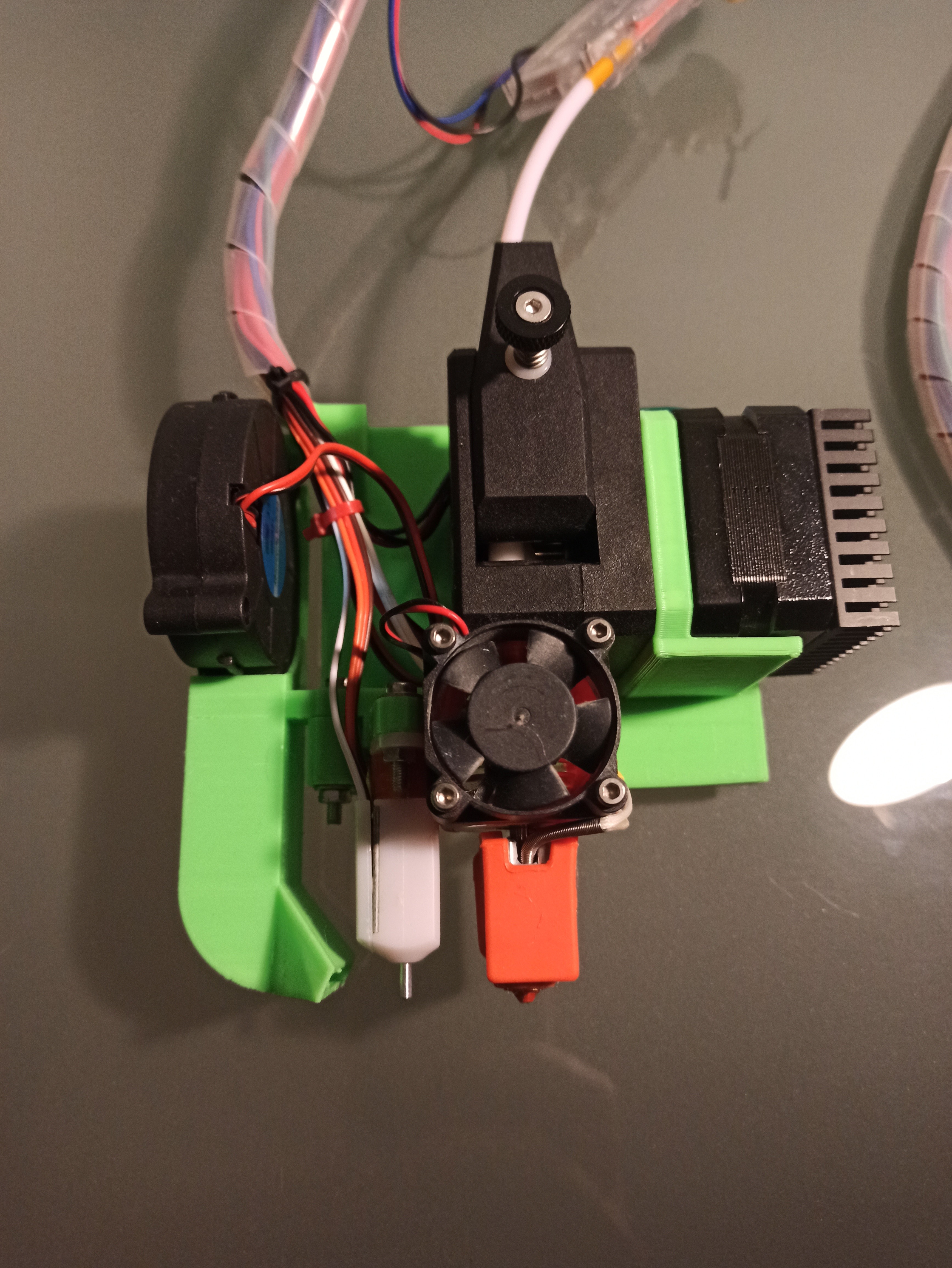

Regarding the hardware, I used this design to exchange tools, and I remodelled it a bit to fit my needs and to be able to mount the extruder, BLTouch and layer fan. I used a clone of the BMG Bondtech from Trianglelab (it works very well), the resulting part to install everything on the print head is this one:
BMG_Bondtech_adapter_Lowrider.zip (57.4 KB)
The layer fan is a 5015 12v.
The filament run out sensor you see in the picture is this one, I placed it as you see, after the extruder a piece of teflon tube and then the sensor.
My electronics is an Arduino Mega + Ramps 1.4, I needed an extra driver for the extruder motor as it was taking up all five drivers with the axes, so doing some research I found this, and following this video I managed to get it working without problems.
If you have any free drivers in your electronics you can save this.
I have added male/female connectors so I can easily remove the print head when using the lowrider as a CNC or Laser.
If you want to have a look at my Marlin I’ll share it with you, I made quite a few changes, I can’t list them now because I don’t remember.
https://1drv.ms/u/s!AjcmonhnxsUl9z5gfShDDBnb57Xc?e=R0dxOJ
As laminating software I use Cura 4.8.0, I have two printing profiles that are giving me good results, one for 0.4mm nozzle and another one for 0.8mm, although as you can imagine here the interesting thing is to use at least a 0.8mm nozzle so that the printing times are reasonable. Nevertheless, I share both of them with you in case you find them useful.
Cura_profiles.zip (1.6 KB)
I know I’m missing a lot of ink, but feel free to ask me anything you need, maybe when I’m done and everything is working properly I’ll make a more detailed thread of the whole process.
