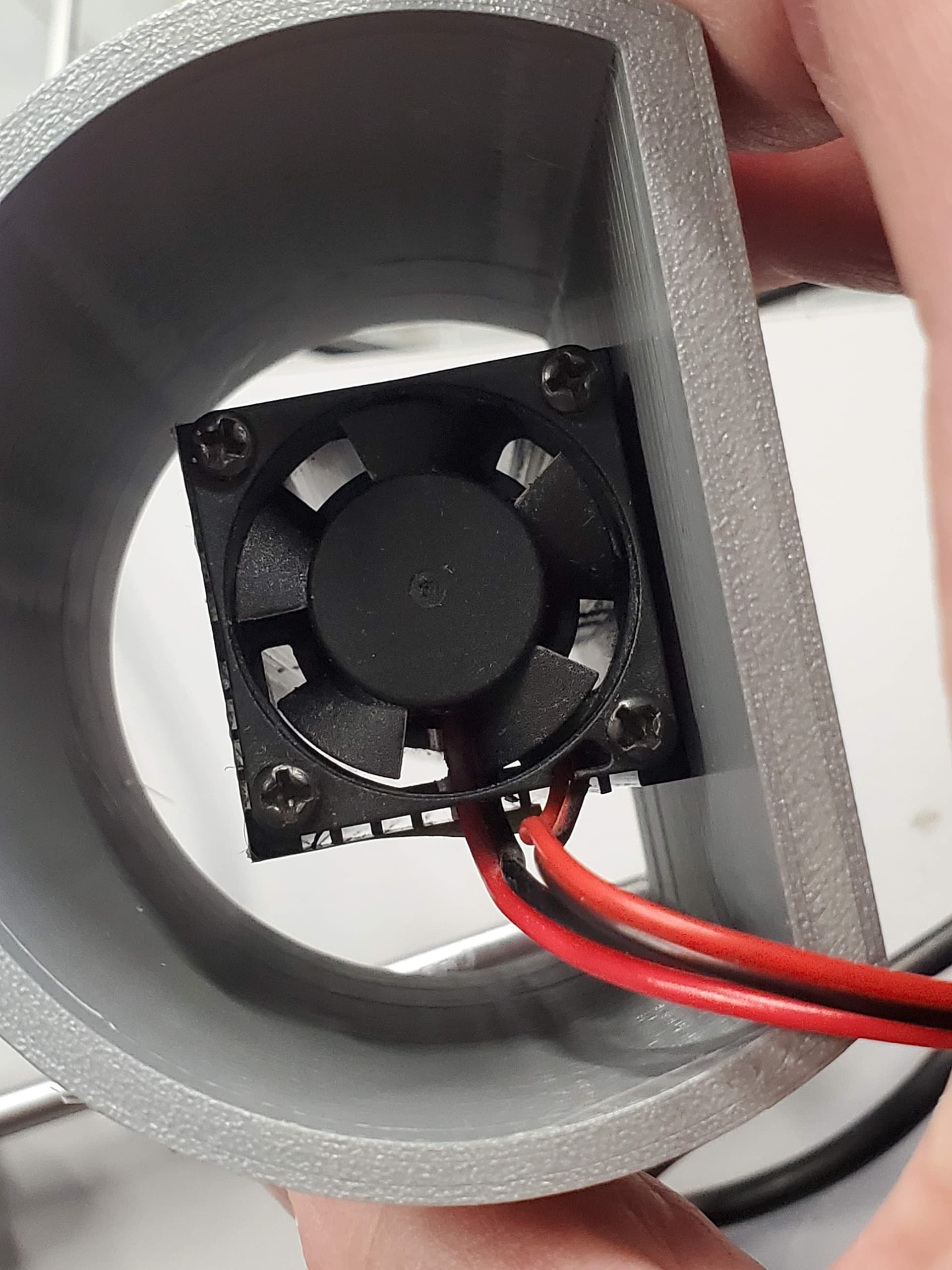

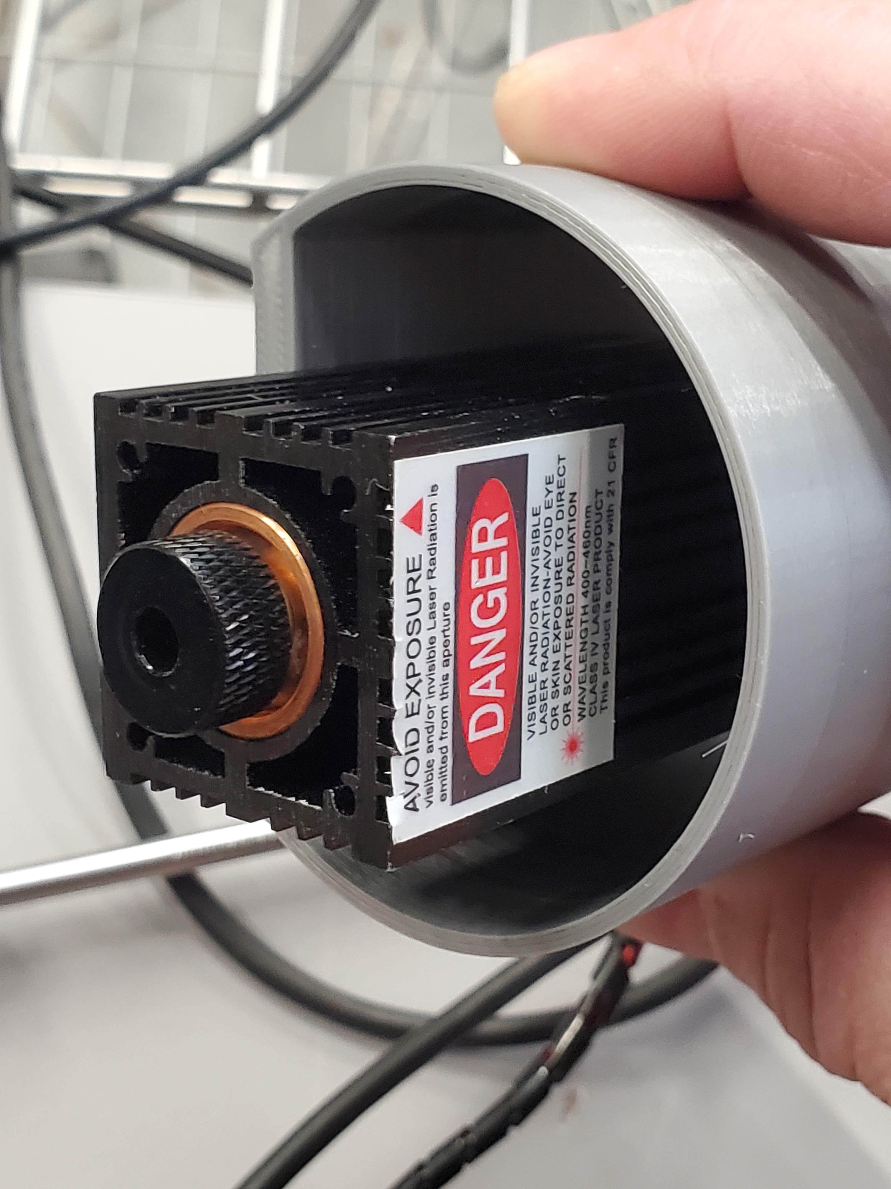

I have made this super wide version to carry my small 5 watt laser which also seemed to power up (at least the driver board and cooling fan on top of the laser was spinning.
I tried to connect light burn through the USB port of the board but could not get the laser to fire.
With the board still powered up (I know, I know) I pulled the laser enable pin from the board. And the laser fans powered off which confused me since I have the laser power tied in to the main power inputs on the board.

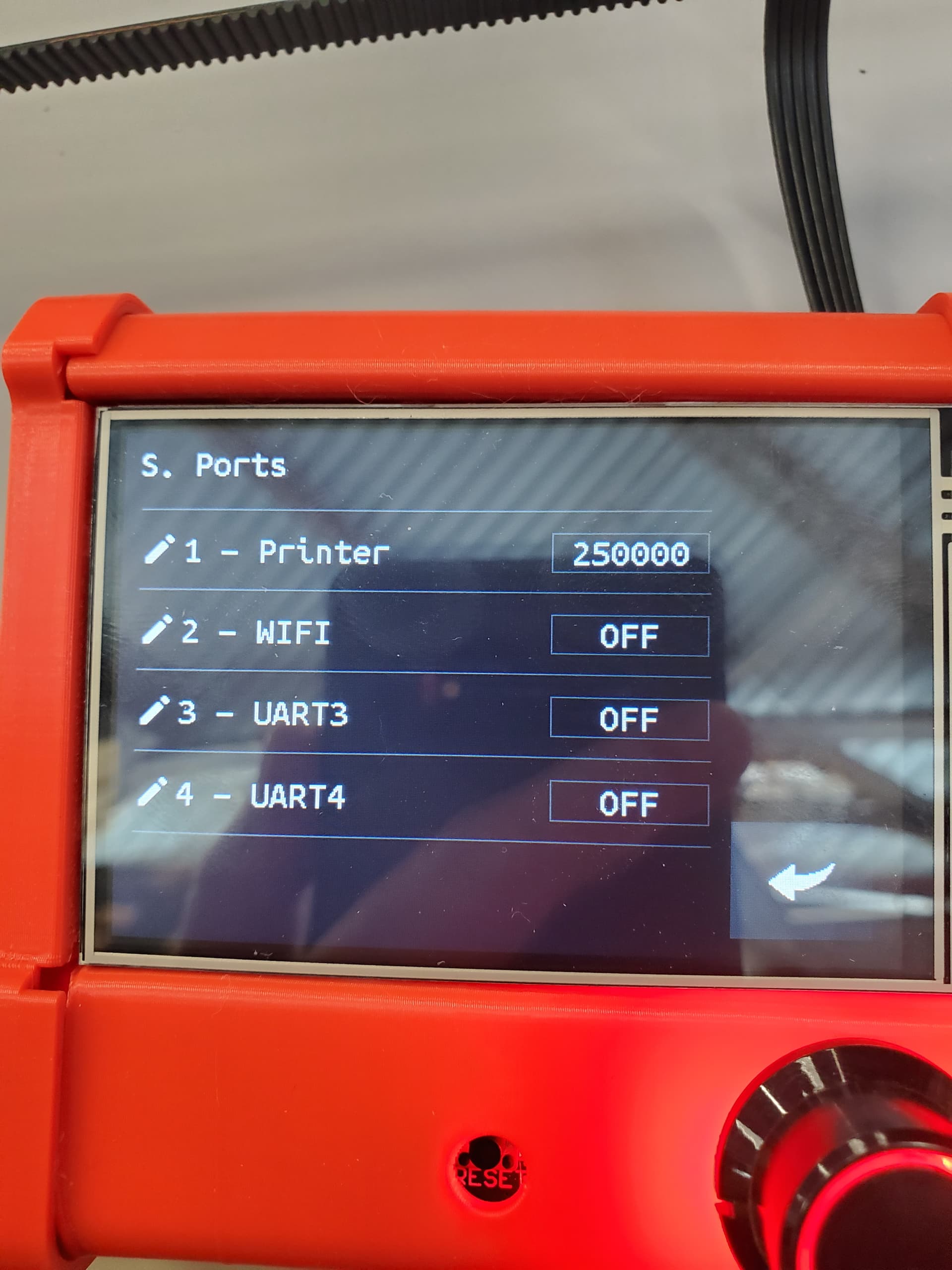

From that point on it all went downhill. Plugging the pin back in did not bring the laser fans back to life. The TFT also reported it could not find the printer anymore. I double checked that the UART speed was correct and cycled power, trying different things with no luck. So then I decided to reflash the board as well as the TFT. After I reflashed the board, the TFT still showed the no printer connection error.

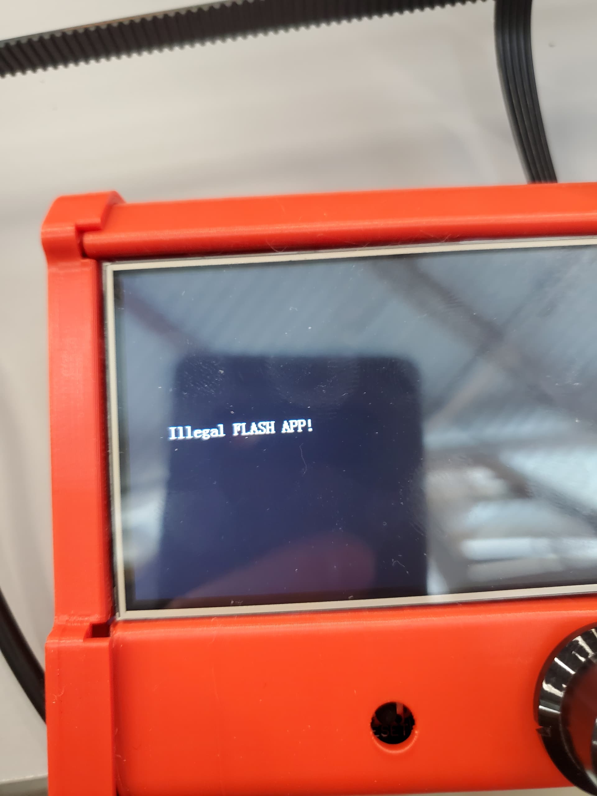

After I reflashed the TFT it booted up with an invalid flash application screen and that was as far as I could go.

I have successfully reflashed the TFT and got rid of the “Illegal Flash App” error. I had to reformat the SD card.

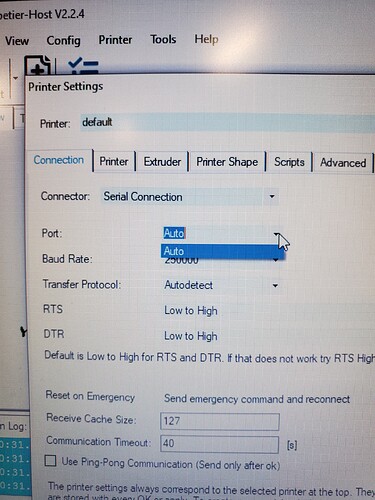

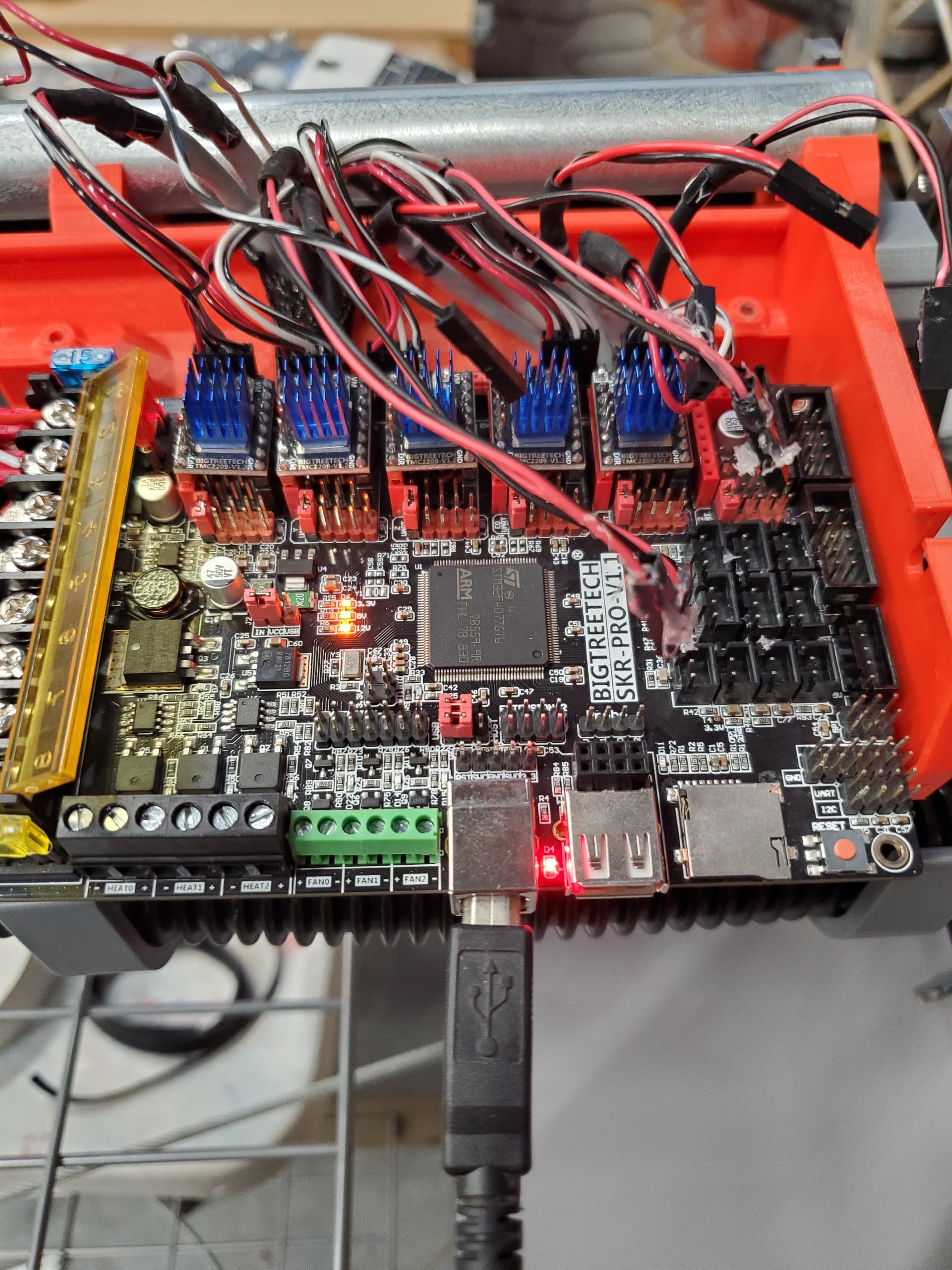

Still no printer connection. Repetier Host can’t connect either over USB. When I plug the USB cable, I get a voltage led light on the SKR Pro but no connection through the serial connection in Repetier.

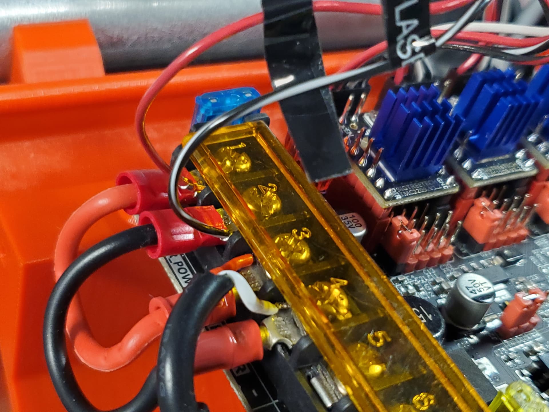

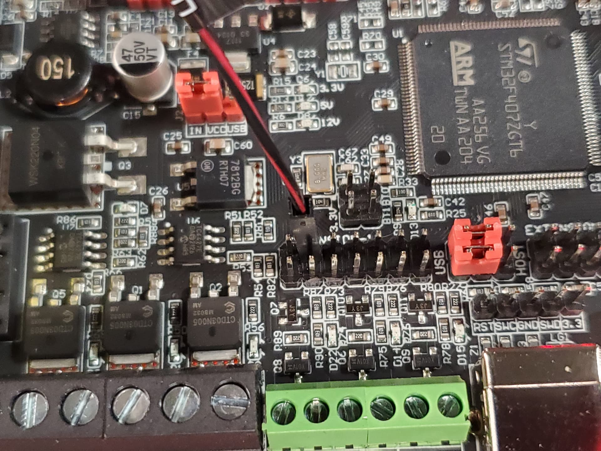

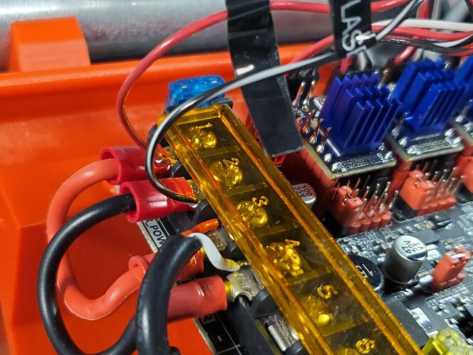

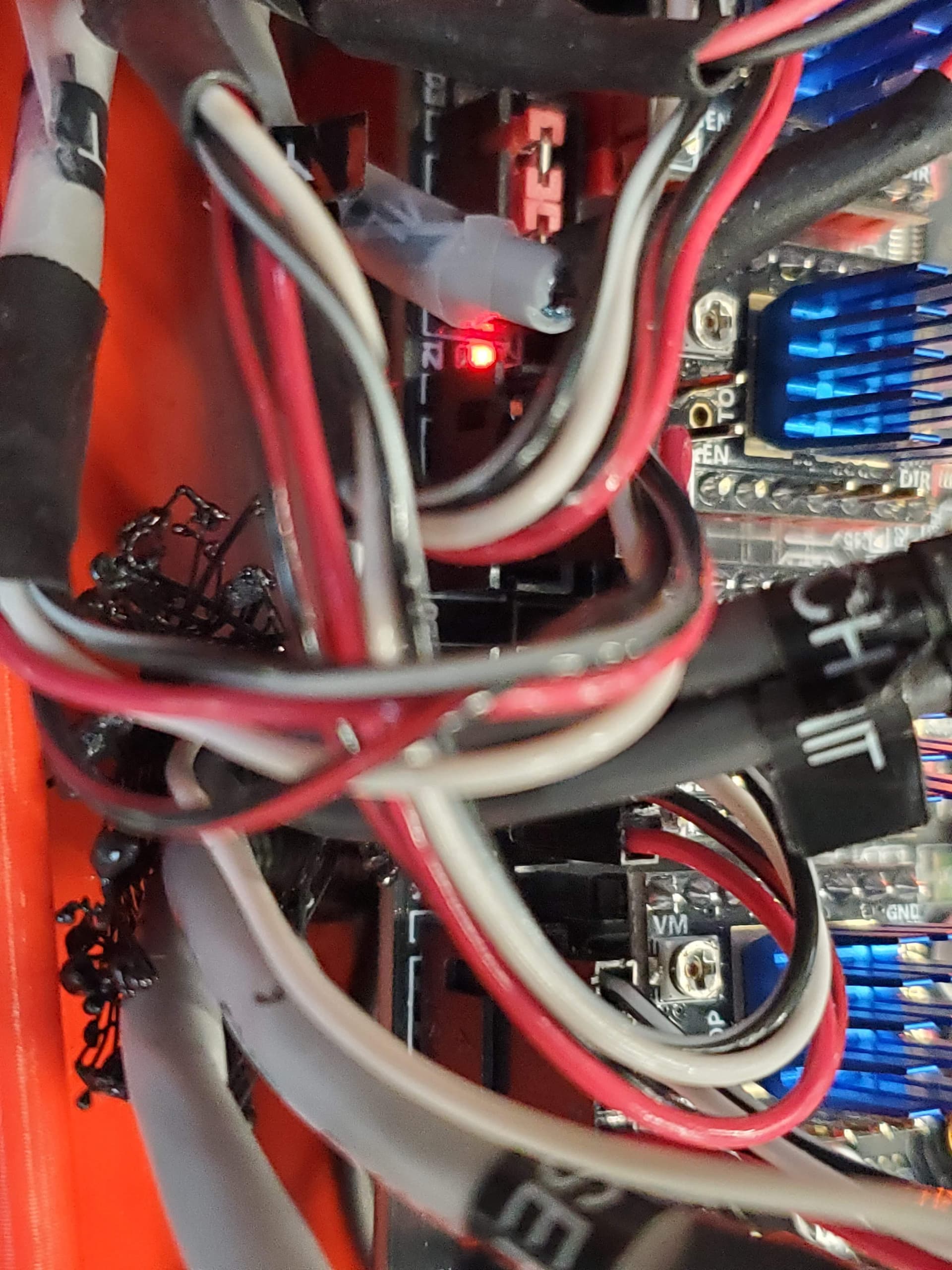

The only other LED that is on is in the picture and I think it might be the the touch probe line that isn’t connected to anything?
I also completely unwired the laser and may have messed up the connection originally. It seams that either the pos or neg lead to the laser might have been connected to the enable pin. Perhaps when I unplugged that pin it back/cross fed the current and burned something out?

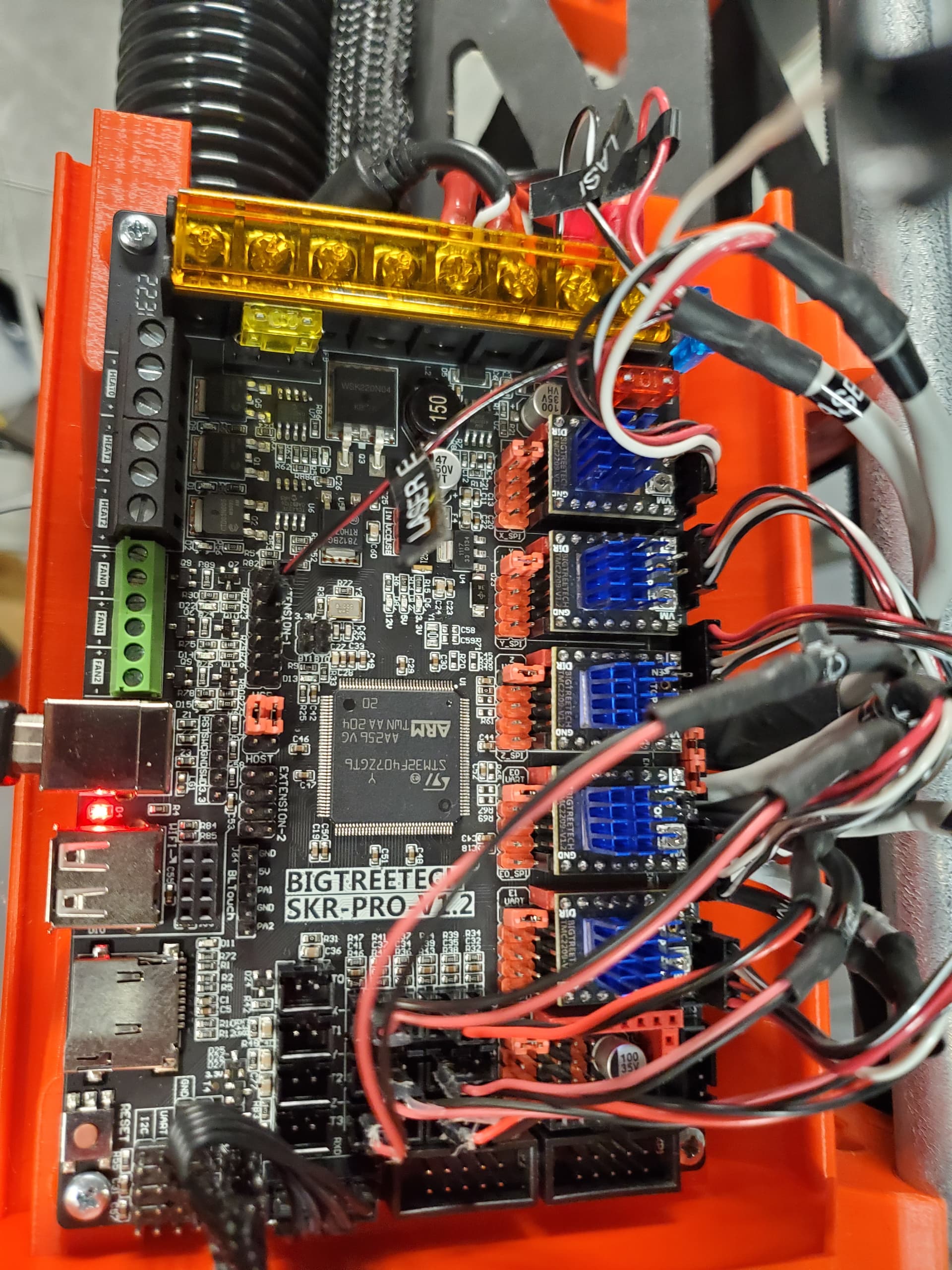

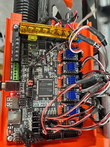

Pictures attached in case anyone can see anything…
I agree, that should not have done anything unless you did plug it back in backwards. Even then it is just the enable wires, they should not have any power. coming from the laser, maybe you had a floating ground between the laser and SKR? Are your grounds tied in anywhere other than the enable ground?

No connection through usb through repitier or lightburn. Those programs don’t seem like they see the board, even-though the board light comes on when plugged in. Tried both a mac and pc.

You should only be trying 250k with that firmware. The rest won’t harm anything, but they won’t work.

I removed the TFT ripped out the end stop :slight_smile: and plugged in the USB. Still no port detected in Repetier host and my PC laptop does not make any sort of indication through sound or in device manager that anything is plugged in.

Nevermind repetier, you should see a new device in device manager if you have that processor powered and the usb cable is good. Repetier server could be keeping RH from connecting, but it can’t stop it from showing up in device manager.
I would not try the wifi until you have something more basic working. It might be fine, but it is too new (here) to be confident when it isn’t working.
I did have the 12 volt plugged in. I did not install server so that it wouldn’t mess with it but I could try a different USB cable.
Do you know where it would show up in device manager? I looked under USB host and didn’t see a change when I plugged and unplugged the cable.
In the com ports. But I’m not sure, because I use Linux.
Mine pops up in “ports (com & LPT)”

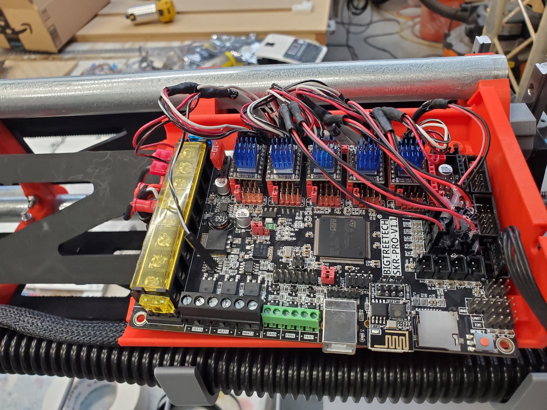

So the new board came in today and works like a champ! End stops, motors, TFT all perfect and the USB makes a nice activation sound when the cable is plugged into Windows. Not for sure what killed the old board but it’s good to have that out of the way.

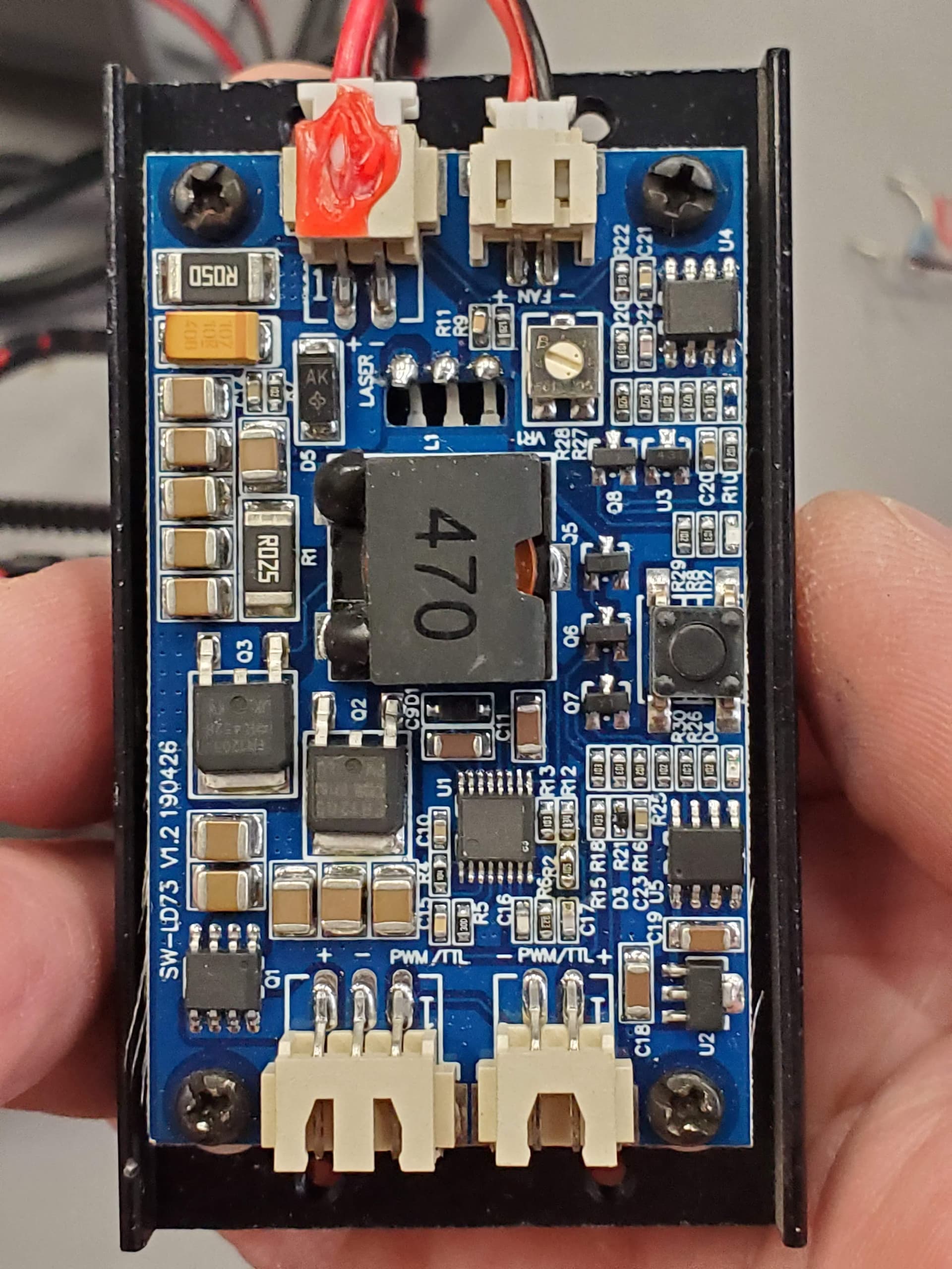

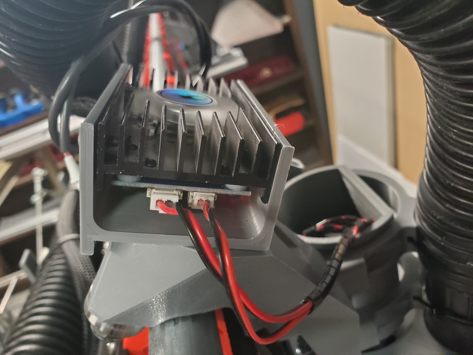

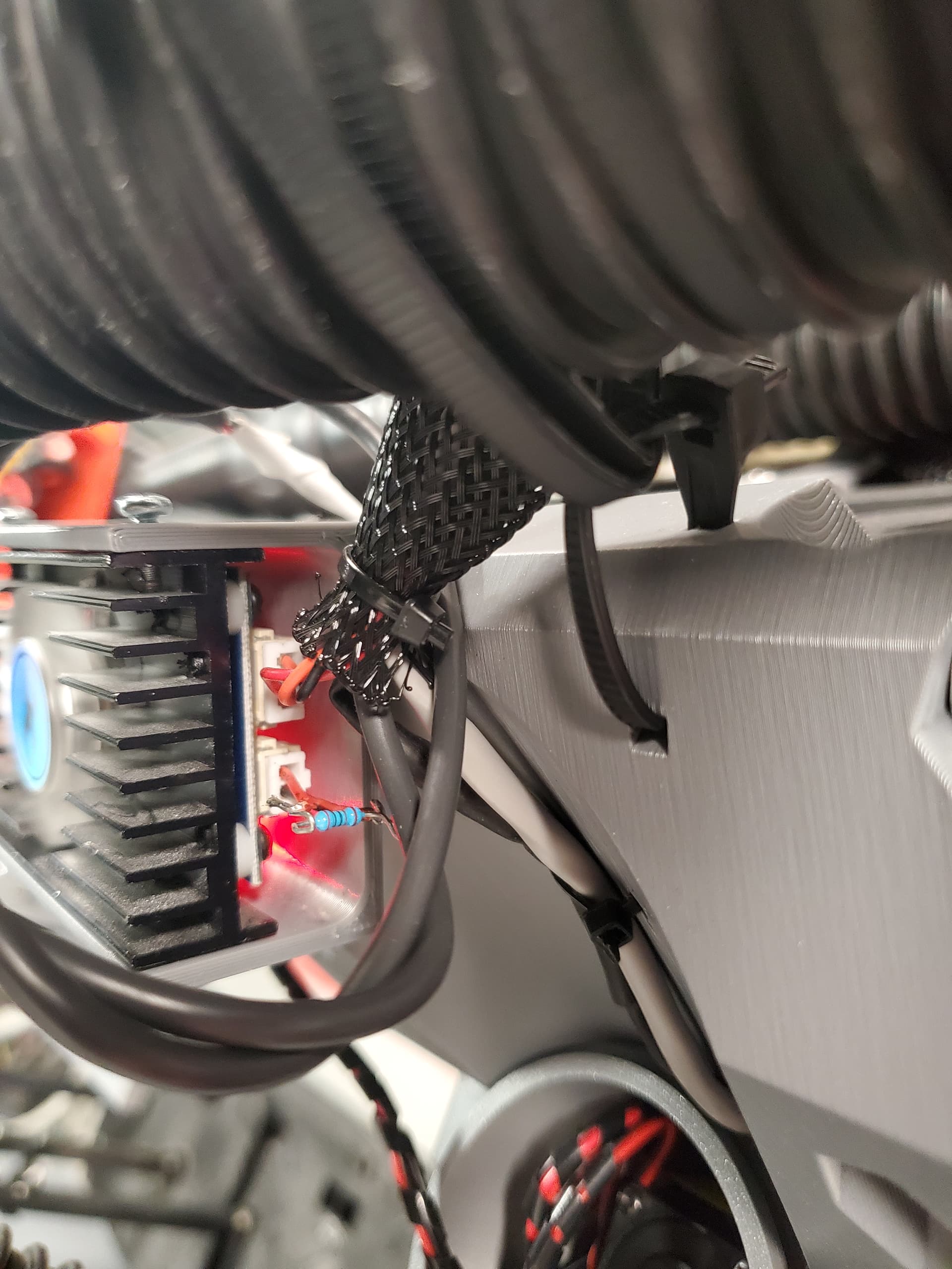

The current problem is that the laser refuses to respond. I have the enable pin wired to PC9 and the laser positive and negative coming off the SKR main terminals. You can see in the pictures that I have a resistor wired in as well which was how it worked when I had the same unit on my old Primo.
When I go into terminal on the TFT and enter M106 S250, nothing happens. The fire button in light burn also does not activate it though I’m unsure what device settings I should be using.
When I remove the resistor on the laser driver (while powered down of course) and then repower the lowrider, the laser comes on 100% or at least very strong. I am concerned that I may have blown out the laser control on the driver board when I lost my previous SKR pro board.
Can someone confirm that I have the laser wired up correctly? I also am noticing a red LED off the driver board that I don’t remember before.

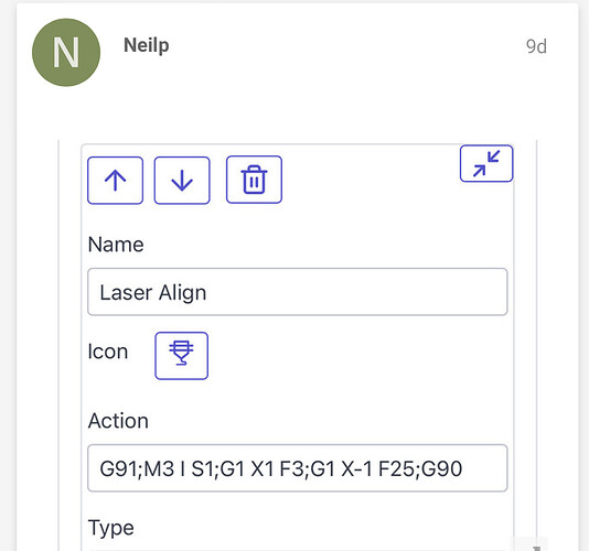

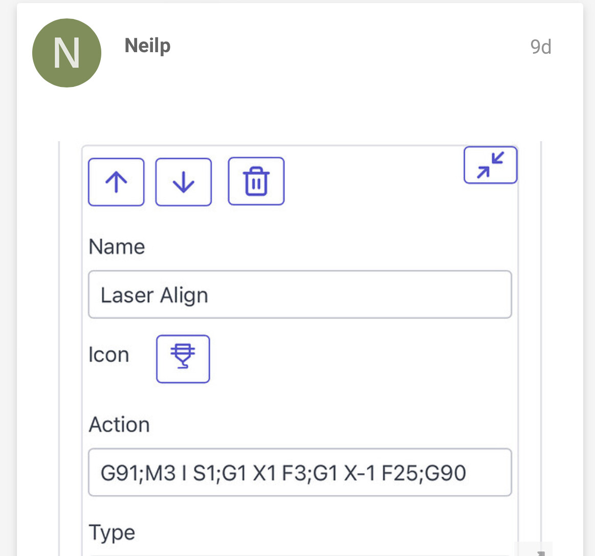

I have the ESP01 wifi module and run my lr3 using a tablet. The esp3d console allows you to create macros. The following is one I use for activating the laser in order to position my work
G91 (relative positioning)
M03 I S1 activates laser mode, in-line commands, power 1/255)
G01 X1 F3
G01 X-1 F25
G90
What this does is moves the laser 1 mm at 3mm/min, at 0.4% power (1/255 pwm values) then goes back to the start point at a more rapid pace. In practice, this gives me a super low power spot that doesn’t appear to move, for about 20 seconds.
