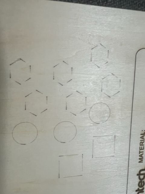

I’m having trouble where the laser doesn’t seem to turn on and off correctly. I’m using v2.1.1 on an SKR Pro. If I draw a hexagon using Lightburn the laser fires on each line segment and then stops before it’s complete. I have an M3 I in my starting gcode. Power supply looks fine. I’ve tried a 12v 5amp power supply and a lab power supply set to 12v and current limited to 5amp.
What am I missing?

Taking another look at this. Could the laser be firing at a higher % at each G1 and then backing down during the move to the 20% it’s set for? (odd it says S51 in the G1 when Lightburn says 20%).
An inline command of S51 is 20%. If you look at your settings, your S-value max is 255, so the power will be 51/255 which is 0.2 or 20%.
Taking a quick look at your g-code, what jumps out at me is that your federate of 12,000 mm/min. That seems really high. It certainly extremely high considering you are trying to debug your setup. Is is possible you are confusing mm/s with mm/min in the way you are setting up your jobs?
Another thought. Have you played with the acceleration in your Marlin setup? Given the large feedrate, if you’ve played with acceleration, there may be issues.

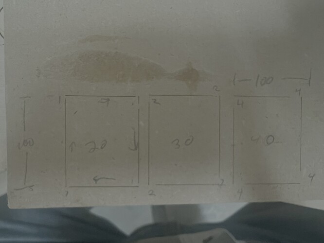

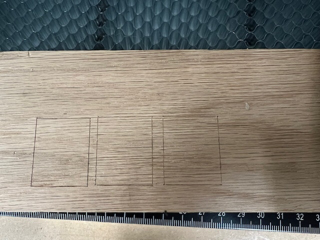

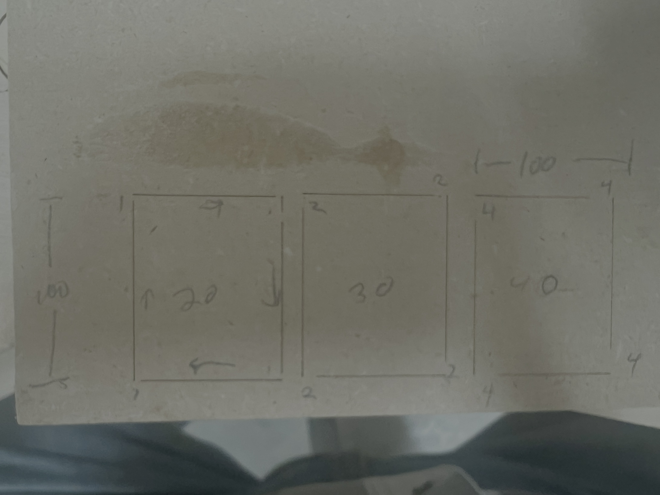

A bit more data. I created 3 100mm x 100mm squares. The left one cuts at 20mm/s, the next at 30mm/s and the right one at 40mm/s. The arrows indicate the direction of the engraving. The gaps occur in both x and y equally. They seem to be the same size for a given speed. and correlate to the speed. The left is a 1mm gap, middle 2mm and right 4mm. The gap seems to be the end of the lines as if the laser is turning off too early. It’s hard to see on this material but he beginning of the line is darker than the rest as if the laser is firing and after a delay motion happens.
The gap at the top of the right side of left square is unrelated.
Most posts I read talk about a delay in the laser firing but this seems like the motion is delayed.
Any clues?

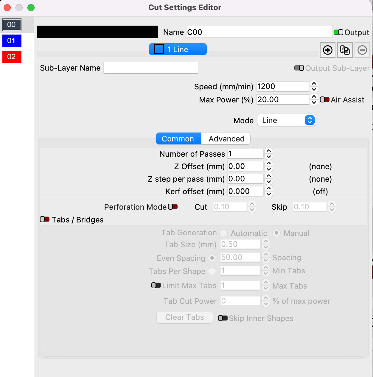

; Cut @ 1200 mm/min, 20% power
M8
M05
G0 X25 Y0 F6000
; Layer C00
G1 X-25F1200 I S51

For cuts, try using constant power mode.
This won’t work well for raster mode, but for vector cutting it should improve things for you.
Edit: If you don’t have constant power mode, you can also raise your minimum power up.
You might want to do a test to find the effective minimum power for your machine.

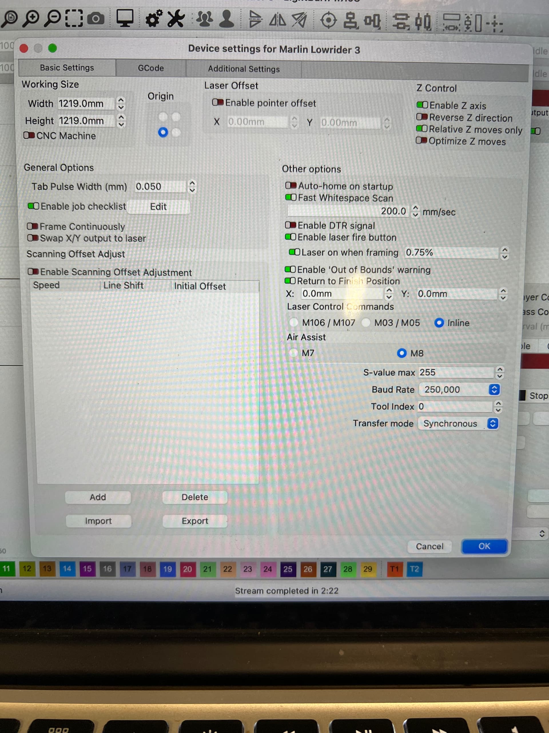

Hi Jim,
Thanks for the reply. I don’t see a constant power choice. I’m on SKR Pro Marlin.
Am I looking in the wrong place?
This is strange behavior. These NEJE modules are typically plug-and-play on the V1 machines running V1 maintained versions of Marlin.

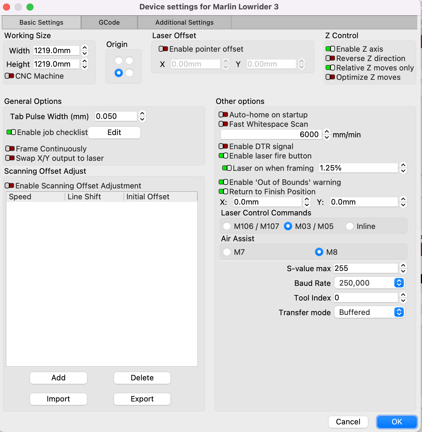

There is one test I’d like to see you try. Switch to using M3/M5 commands in Lightburn:
Inline laser commands produce better results because Marlin does extra processing to get consistent burning of the laser. For example, as the CNC moves to turn the corner of the square, the machine has to decelerate to the corner and then accelerate after making the turn. Marlin will throttle down the laser power as it makes the corner turn to avoid over burning the corner. The M3/M5 commnds do not do this throttling.
If your burns are okay with M3/M5, this does not mean the issue is with Lightburn or Marlin. It could be the wiring or the module itself. I believe your NEJE laser has two diodes, and I wonder if one of them is not firing correctly.
Are there any setting that would cause it to ramp up and not reach the end point?
Not in Lightburn. Everything is in the g-code, so if the line is stopping early, you’d see the g-code turning the laser down or off, and nothing like that is in the g-code you provided. In Marlin, their may be setting dealing with the throttling, but the V1 maintained firmware works as-is for almost everyone who is using it, so I hesitate to explore that avenue.

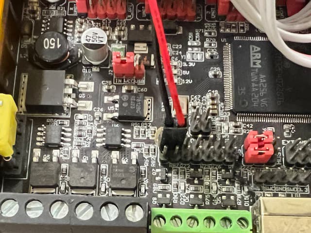

I’ve included a picture of where the laser connects. Red goes to the TTL input on the Neje adapter board and black to GND.

A comment on the Lightburn forum was that it sounded like slow acceleration. I started ramping up from the 180 Robert had in his initialization and the gaps did indeed close. I stopped at 900 as I was now seeing some ringing.
Robert, are you running a Lowrider or a different machine? I’m wondering if mine just can’t handle the speeds that you can achieve. 20mm/s looks pretty good and I believe I can back the acceleration down a bunch and still achieve completed line segments hopefully with less ringing.
M203 X900 Y900
;M204 P180 T180
M204 P900 T900
;M201 X200 Y200
M201 X900 Y900

I cannot see your wiring picture.

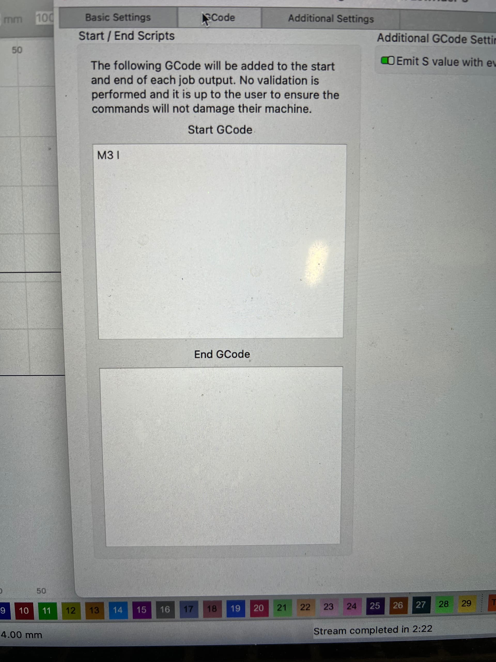

Tried M3/M5, the laser did not fire.
Forgot to mention, you have to take out the M3 I at the start of the code to make M3/M5 work. The M3 I tells Marlin you want to use inline commands.
