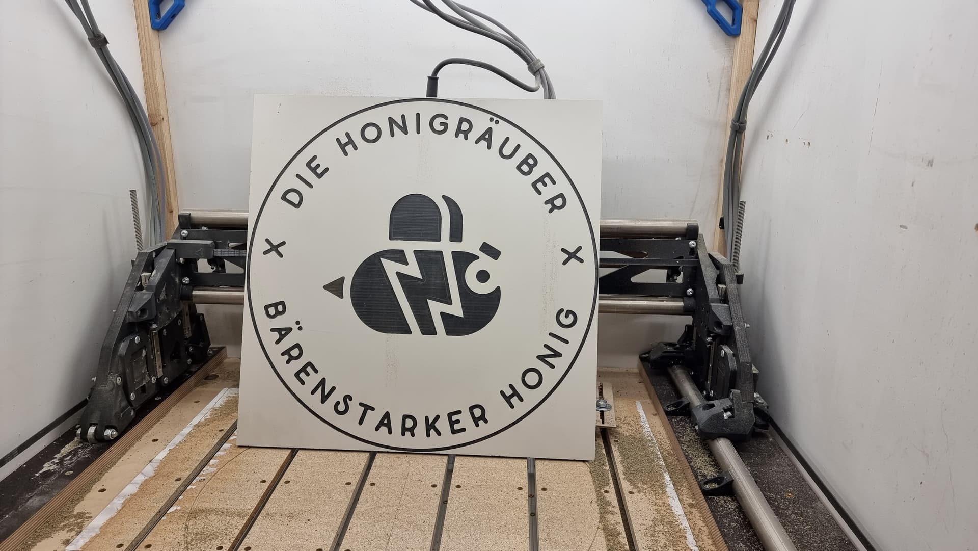

The first project is milled, a sign for a beekeeper friend.

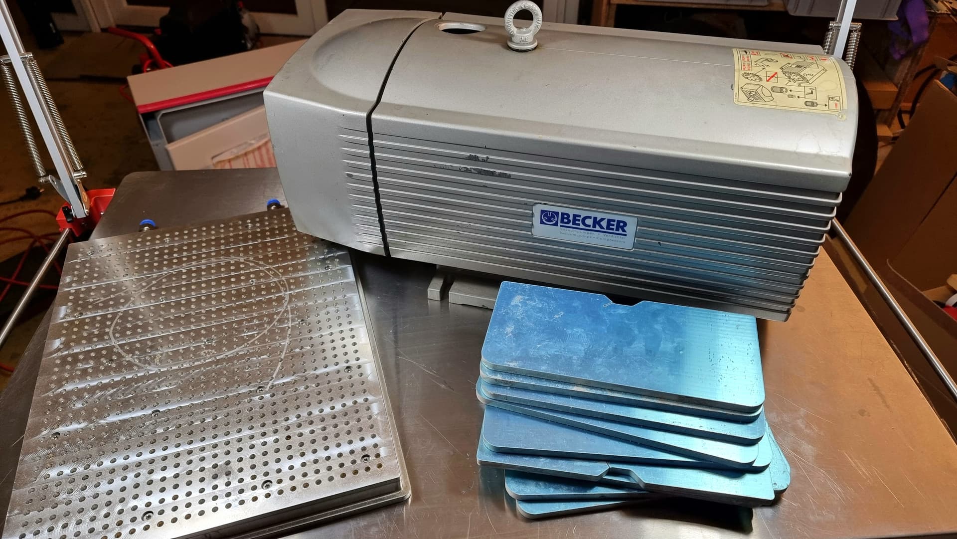

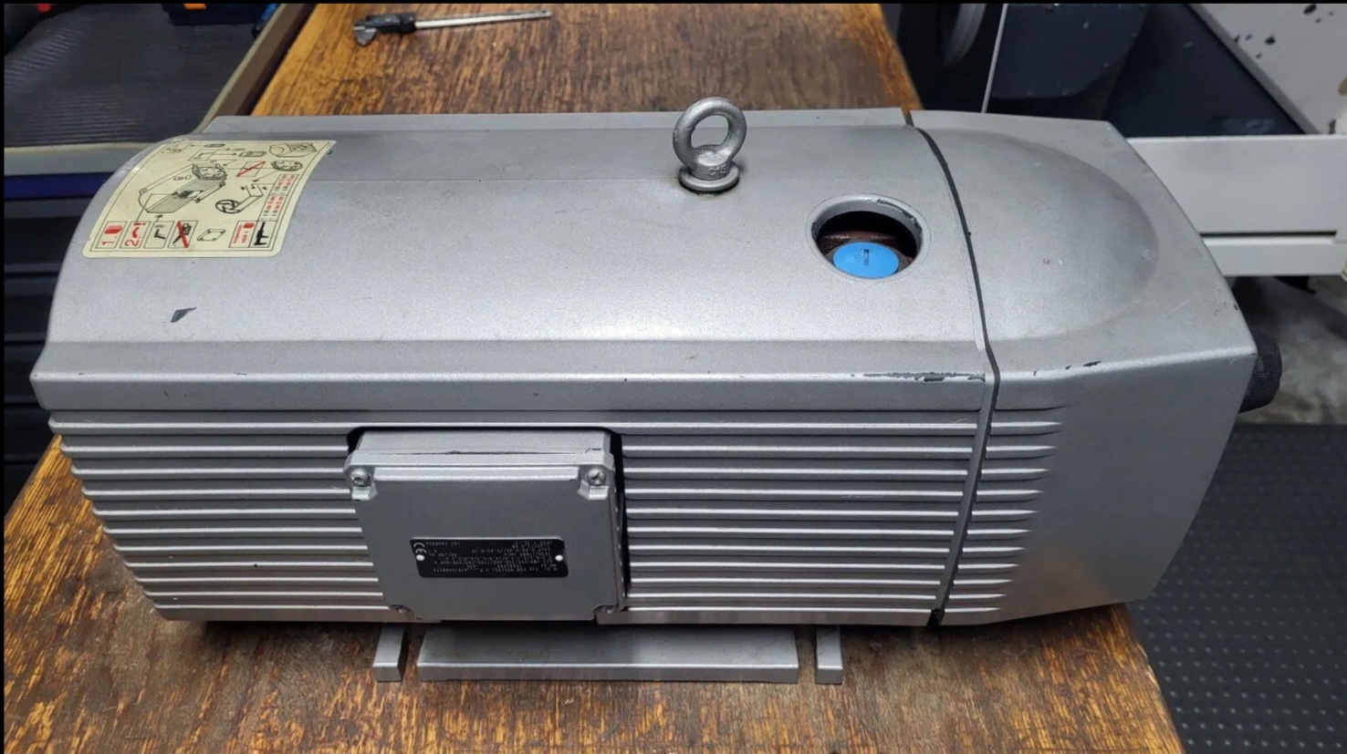

Then I bought a vacuum pump for a planned vacuum plate. 40m³/h should be more than enough
You are going to mix up some black resin to fill that knife cutout, right? Or are you going to try for an inlay?
The knife was just a test object to see if such fine things could be milled. However, another knife is to be made, which will then be filled with resin.
I picked up my vacuum pump today. Spontaneously I bought a vacuum plate and got some 5083 finely milled aluminum as a gift.

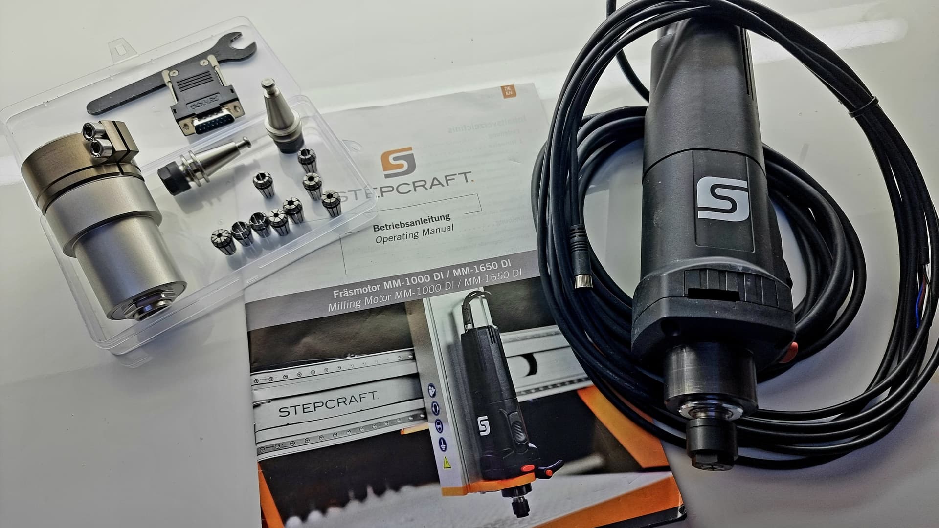

I received a Stepcraft MM-1000 DI milling machine today, including a tool changer and a few collets. The tool changer also fits on the AMB milling machine. However, I no longer plan to convert the mount on the Lowrider V3, as the conversion to the Lowrider V4 is planned. But that will take some time, as my advanced training exams are scheduled for November.
Got a link to the toolchanger? :slight_smile:
/edit: Found it, never mind (Tool Changer for AMB-1400 FME-P DI | STEPCRAFT, 569,00 €). Don’t have that kind of money at the momemt. :smiley:
Yes, unfortunately it is quite expensive, and the costs for the tool holders, ER11 collets, and the necessary compressed air control add on top.
And all that just for more comfort.

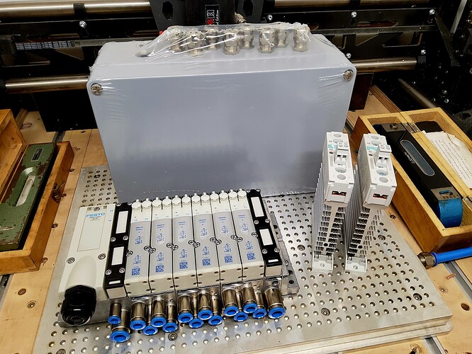

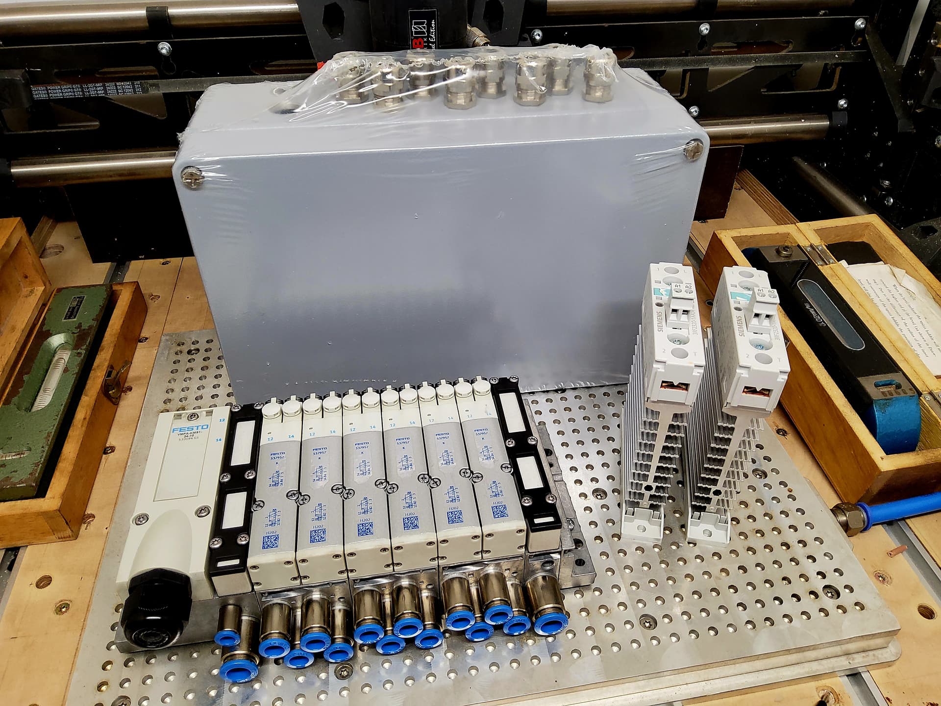

Got something else for the Lowrider and tool changer. A Festo valve island to control the compressed air, Siemens Sirius relays to control the 230V circuits, and a Bopla aluminum enclosure, which will house switches, push buttons, emergency stop, and control circuits. :blush:
Cost of the LowRider: 600€
All the rest: 4540804504680€
