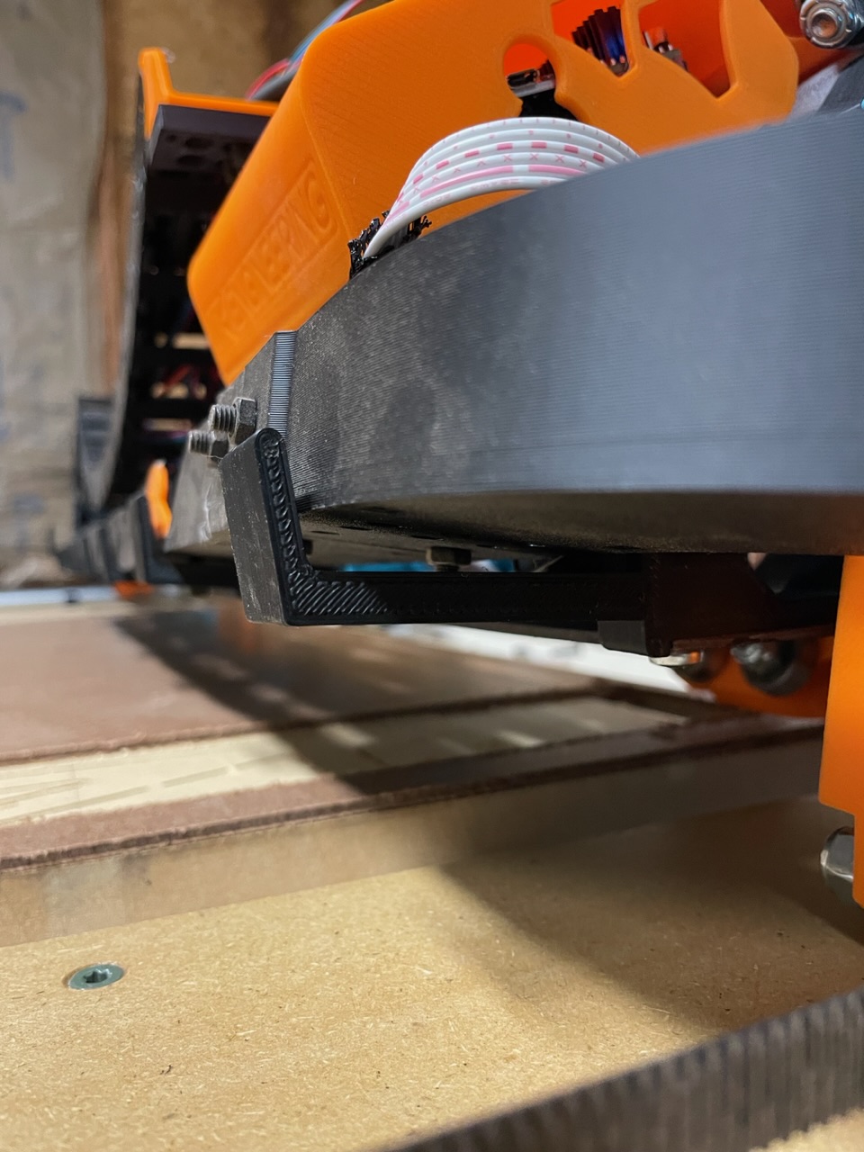

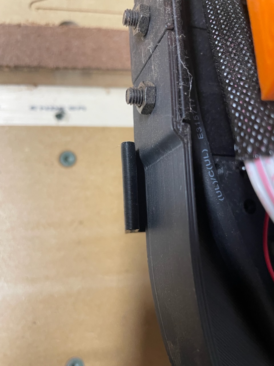

So I have an Ender 3 Pro and had to go with the split model.
I remixed the straight part for length, however, it looks like the entire split needs to be shifted.
My screw holes look lined up, but the expanded width where the connected is placed is to wide to fit in the hanger.
It looks like the whole split needs to be shifted 10-12mm towards the 2nd brace.
My printer is tied up at the moment for a bit, so I may just zip tie it in place for now
Got it. Couple of thoughts here. One is that because different LR3 makers will have a different distance between their braces, it’s challenging to try to come up with a design that will fit everyone without needing remix adjustments. The second thing is, I’m not sure if you’re suggesting a change to my design, or commenting about a change needed in your remix.
Sorry, to be more clear:
The place you chose to split is at the absolute closest point to the holes that connect to the outside mount. This is consistent for everyone
My suggestion would be to take the joint and slide it 15mm closer to the 2nd brace mount
this should give plenty of clearance for it to actually sit down inside of the last mount, as it would move the thick part to a point that doesn’t overlap the mount.
I have to assume that no ones braces will be closer than 100mm apart. I have 2 more braces than were suggested by the calculator and still come out with ~157mm between braces.
Sliding that joint down a little will allow it to seat properly.
Ah. Got it. I’ll try to look into whether that can still have the curve part fitted in normal size print beds. Been a while since I had done that.
For an Ender 3, there’s still plenty of room with a 220mm build plate.
Another option would maybe be a special mount that can hold it better, but I’d have to look closer at the side closer to the strut plate and see if it could work. Maybe having the mount offset 15mm in the other direction might work too
More pictures in case it helps:
Got it
