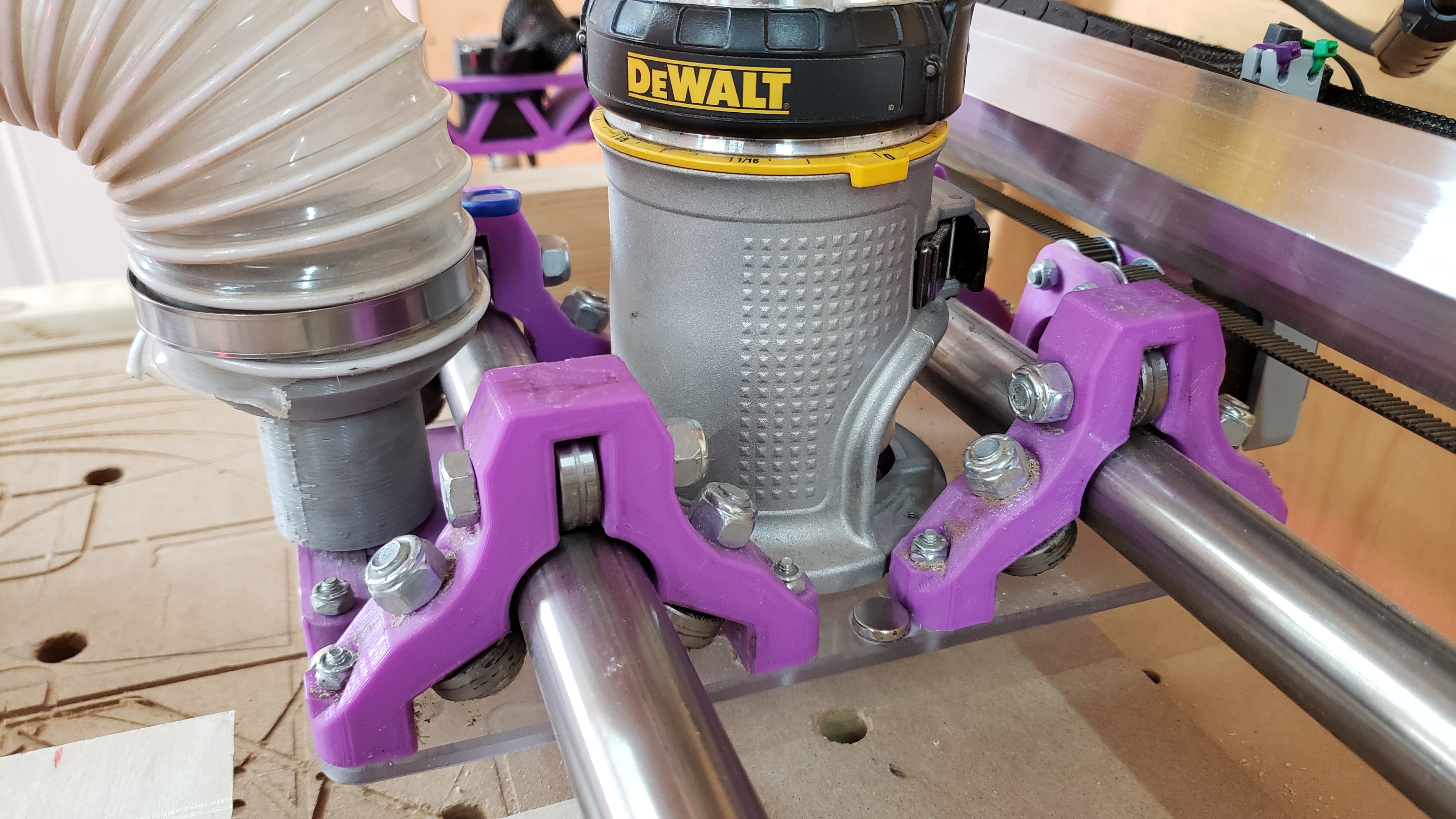

For my vacuum adaptor I 3d printed one that just attaches to the port of the original parts. It may not be optimal for flow but it works just fine. I use the mini Rambo board with the lcd, non tethered and use the z touch plate without any issues. You just have to add gcode to your cut file to do so.

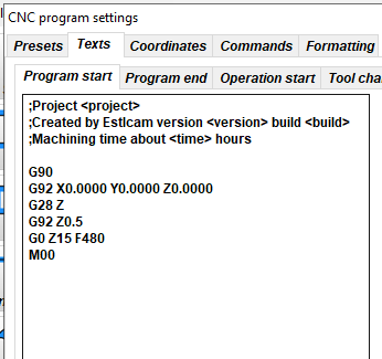

Did you design the vacuum adapter yourself or are you using one from online? This adapter looks like it could work. So, you’re exporting gcode from repetier then copy/pasting calibration code in front of it to use the z-touch plate prior to the print? Can you share the code?
Sort of. I don’t use repetier at all. I just bring my dxf into estlcam and the gcode is preset in all my cnc programs from there. I imagine that you could do this different ways that suite you. I just wanted to mention it because of the untethered work question.
Yes I made the vacuum adaptor myself. There are lots of different hose sizes to deal with so I found making my own the easy way to get what I need. If you don’t have a 3d printer you can do pretty cool things with a heat gun and plumbing pipe.
Here’s a look at my adaptor, simple and effective.
Thanks Brent -
I’ll print the vac adapter for the 2.5" hose, no prob.
I don’t mind going rt from ESTLCam to the CNC - I’m not attached to Repetier. Can you share the code you added via ESTLCam to use the touchplate? Beyond where to plug it into the SKR board, I see the lines in the v1 TFT ini file that reference the touchplate but that’s it. Is there something I’m missing in the instructions or is this info that you had to add on your own?
Thanks -
Sure thing
there’s a bit more info in the shop around the z-touch plate with the gcode in there and a few more details,
Here’s what it looks like in my presets in estlcam, you can see the snippet of the G28 Z which homes the z, and the 0.5 is the thickness of the tiny touch plate from the store, and unlike the store info I wanted my gantry up higher to get the alligator clip off my bit so I go up 15mm instead of 5mm.
I use the mini rambo but aside from where on the board the touch plate connects I think the gcode is all same same.
It’s pretty slick on mine and I use it for every program I run now. My only wish is for a longer clip, and thicker plate but for the few dollars Ryan charges it’s a great little tool and worth all the price paid.
