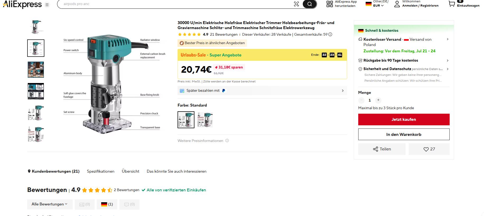

i looked trough aliexpress and found some interesting ones but i still try to estimate if i take a few more bucks in to my hands
i found a new makita 700 one for 100€ (114 USD) and the ali one is 20€ (23 USD)
i would like to try it just for fun but if you buy cheap you buy twice…
here is the ali one
I personally would not try anything that cheap. The problem is cheap ones may have really bad runout.
I think @Tokoloshe was using an AMB spindle? I think that may be controllable, but I think they are also quite expensive.
