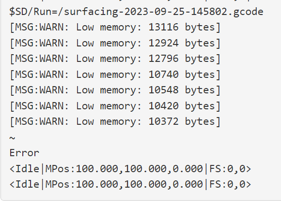

Ok trying to run a surfacing job. First time i set it up everything went great. I copied the exact same start Gcode to this file (only upped the cutting feed rate) and this time i get this error after trying to start the probe

Strange. Are you running STA or AP mode?
I had low memory warnings often until I switched to STA mode.
This is where I think the next Jackpot board revision would benefit greatly if adding some external PSRAM would give FluidNC plenty of extra to work with, then maybe it would decrease the likelihood of failures and support issues.
Nevermind. I’m an idiot. I had closed my tablet and put it on charge but I never closed the fluidnc window. So trying to run it from my computer had 2 windows open. I know I have read that can cause this error. I thought it had closed on the tablet but obviously I thought wrong
STA. Closing the second screen helped. I still had low memory warnings when I started the file though. But not enough to shut it all the way down this time. I haven’t paid attention to that before but will from here on out
I’ve found that changing to Poll helps too.
