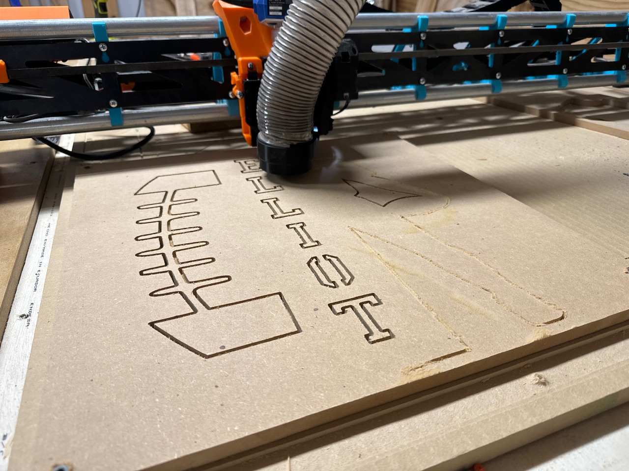

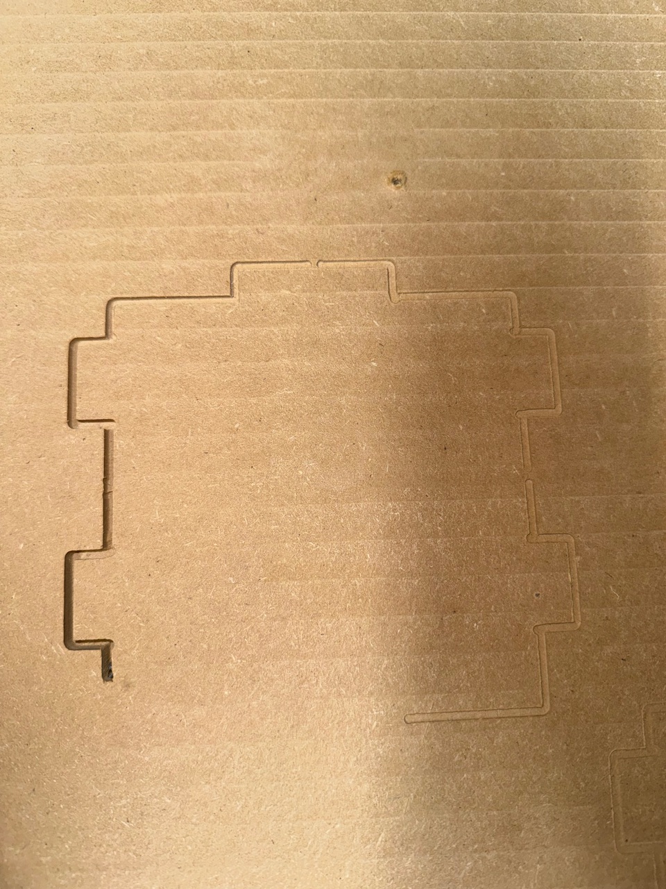

Well, I did some more projects screwups learning today

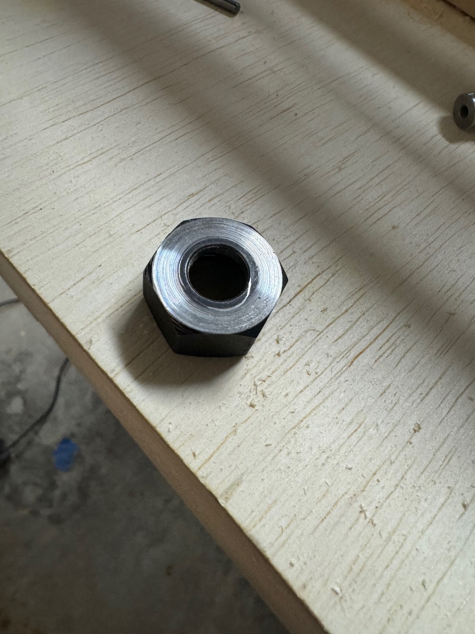

Rule #27 in the CNC club pre-project checklist… Make sure your collet is tight enough… :man_facepalming:
I also joined the “I made some sparks fly” CNC club.
That was the 4th one of those pieces I cut, so about 12 minutes of cutting was the right amount for the bit to work loose. Kinda crazy that is was loose enough to work it’s way south, but still grabbing tight enough to cut that far. Once it got low enough, it jammed in the hole, threw some sparks, gave my collet a polishing, then snapped the bit in 2. Good times…
Once I remembered I had another bit, I got started again.

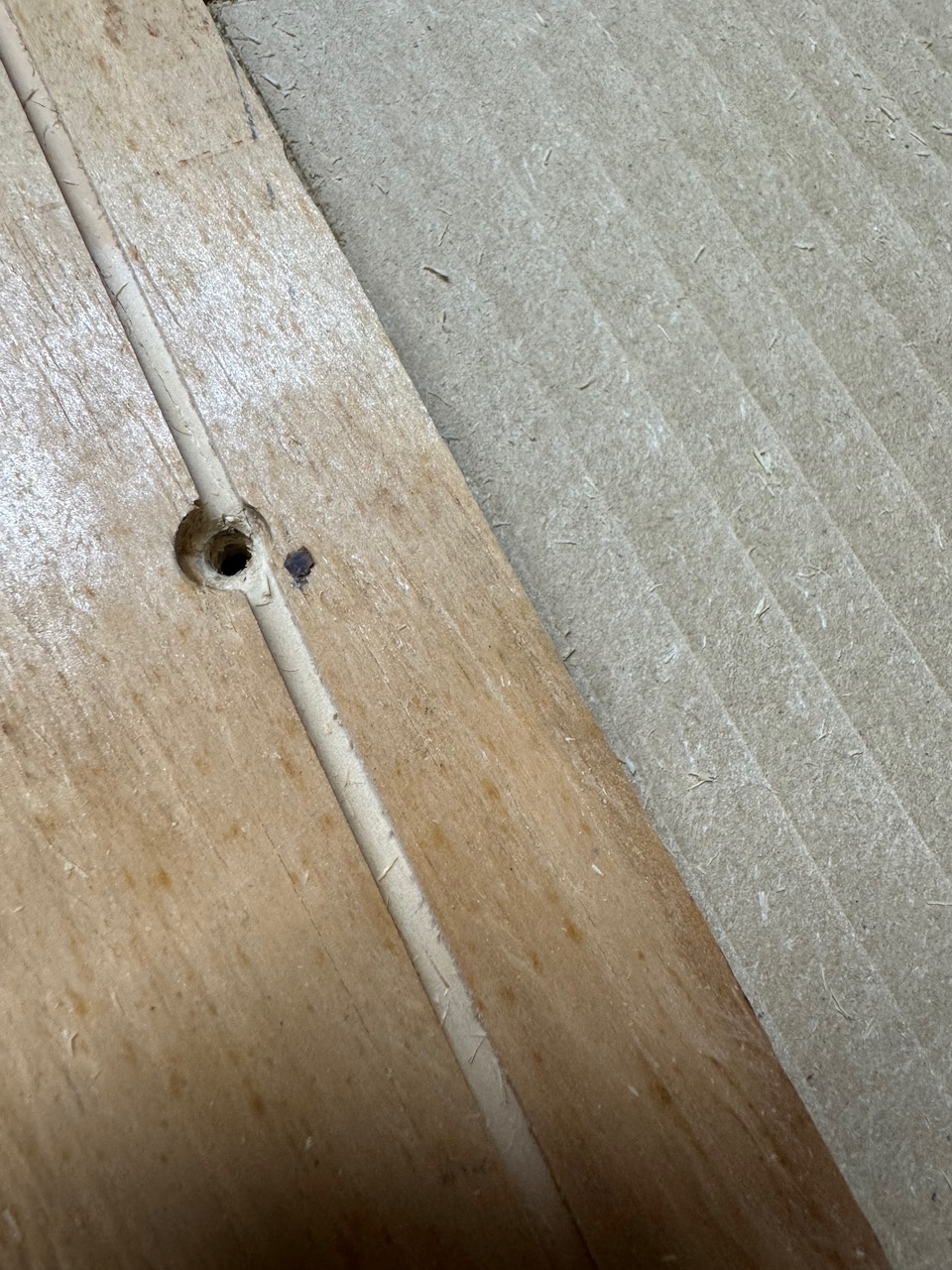

Rule #28 in the CNC club pre-project checklist… Make sure your hold down screws are not in the cut path. Luckily, I noticed this one about 3 minutes before the bit got there.
Unluckily… When I set my drill down, I wasn’t thinking, and I left it in the way of the machine, so when it tried to go to the bottom of the piece, the gantry got pinned on it, and it twisted the machine out of square mid cut… :man_facepalming:
So I got to start that one all over, and that piece has some war wounds that will live in my shop forever as a warning…

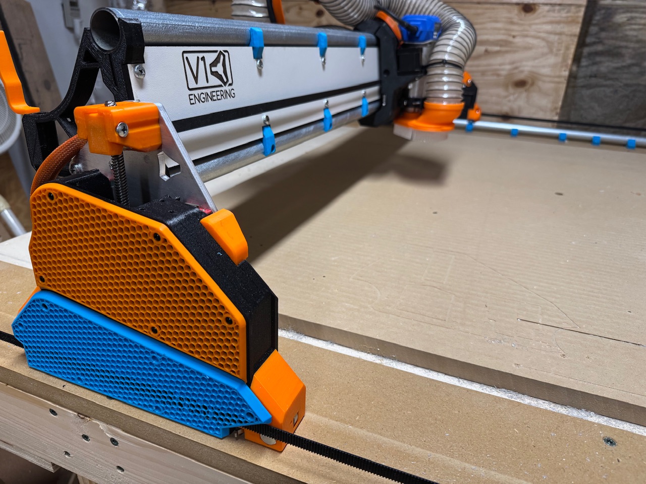

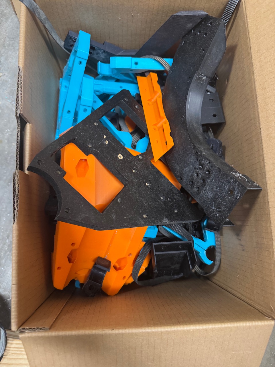

I guess it’s time to announce the death of my LR3….
Here’s what’s left of it…

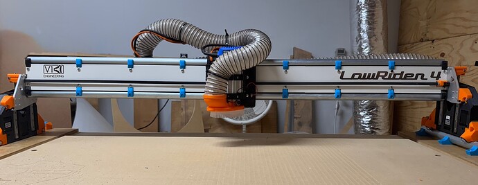

It was hinted in another thread, but in its place, is a shiny new LR4
That is a freakin’ good looking machine!
What are the details? Controller? Size? Anything you learned in the process?
Excited!
All the same parts re-used from my LR3.
Purchased the LR3 to LR4 upgrade kit from the shop along with the clear TPU bristles
Original Jackpot v1.0 with V1 ESP32
4’ x 5’ on the same table.
Overall, to me, it felt like an easier build to get right than the LR3, but I also know waaaaay more about this stuff than I did when I built the 3, so maybe take that with a grain of salt.
Getting the Y belts laid out right definitely felt easier than the 3.
Same table, I gained 1" of X cut space. probably could have been slightly more, but I left a little space from the edge on both sides.
A few gotchas in there for people upgrading:
  • I put my Jackpot case in the 2nd bay from the end, and one of my endstops didn’t reach…so check that before you mount it
  • Make sure you measure where your cut area is. Lining my Y rail blocks up based on the 3, my 1" of space was all on the max size. So get it built and place it on the table before setting your rail positions so you can make sure your bit travels where you want it
Other than that, just take it slow and make sure to pay close attention to orientation and details in the pictures.
Machine feels very sturdy, but I haven’t actually used it yet. Will start squaring, etc. tomorrow.

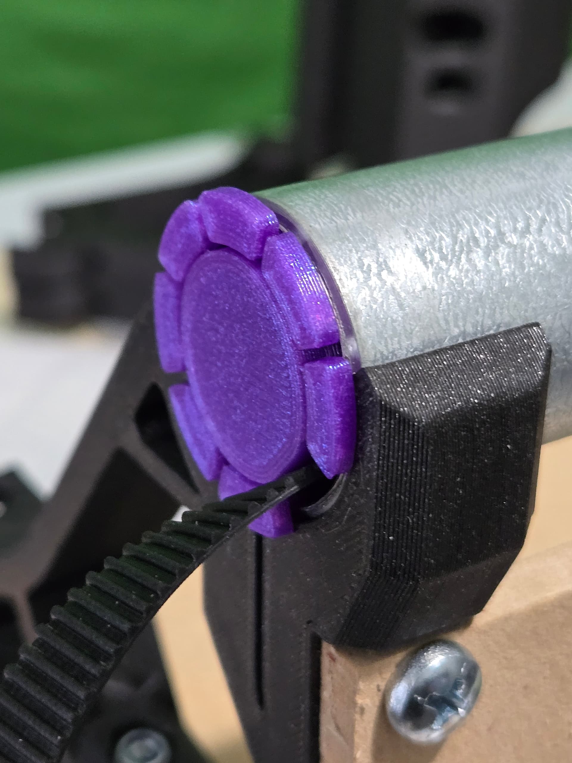

OHHH… @bitingmidge … where them V1 EMT plugs at??? :grin:
Nice build @Michael_Melancon !
Already seen Jamie’s EMT/Conduit end plug/caps? From https://forum.v1e.com/t/update-or-new-version/40835/2733
